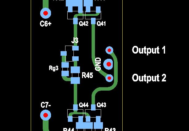

Test Procedure of the CCS Bias Daughter Board
To test the CCS Boas daughter board on its own :
1. Solder all components on board.
2. Connect a dummy resistor of 6.8k between output 2 (below Gnd pin, not labelled) and "C7-"
3. Repeat the same between output 1 (above Gnd pin, not labelled) amd "C6+"
4. Supply "C6+" with +15V, "Gnd" with 0V, and "C7-" with -15V.
5. Measure voltage drop across R45 to calculate JFET bias current. Should be 1.5mA +/-0.5mA.
6. Measure voltages across the two 6.8k resistors to calculate CCS bias. Should also be 1.5mA +/-0.5mA. And the two values should be identical to << 1%.
7. Remove the 6.8k resistors after test.
8. DC offset of the SL HPA can be trimmed later by adding a parallel resistor to either R42 or R44. Suitable pads already provided on the PCB.
Patrick
