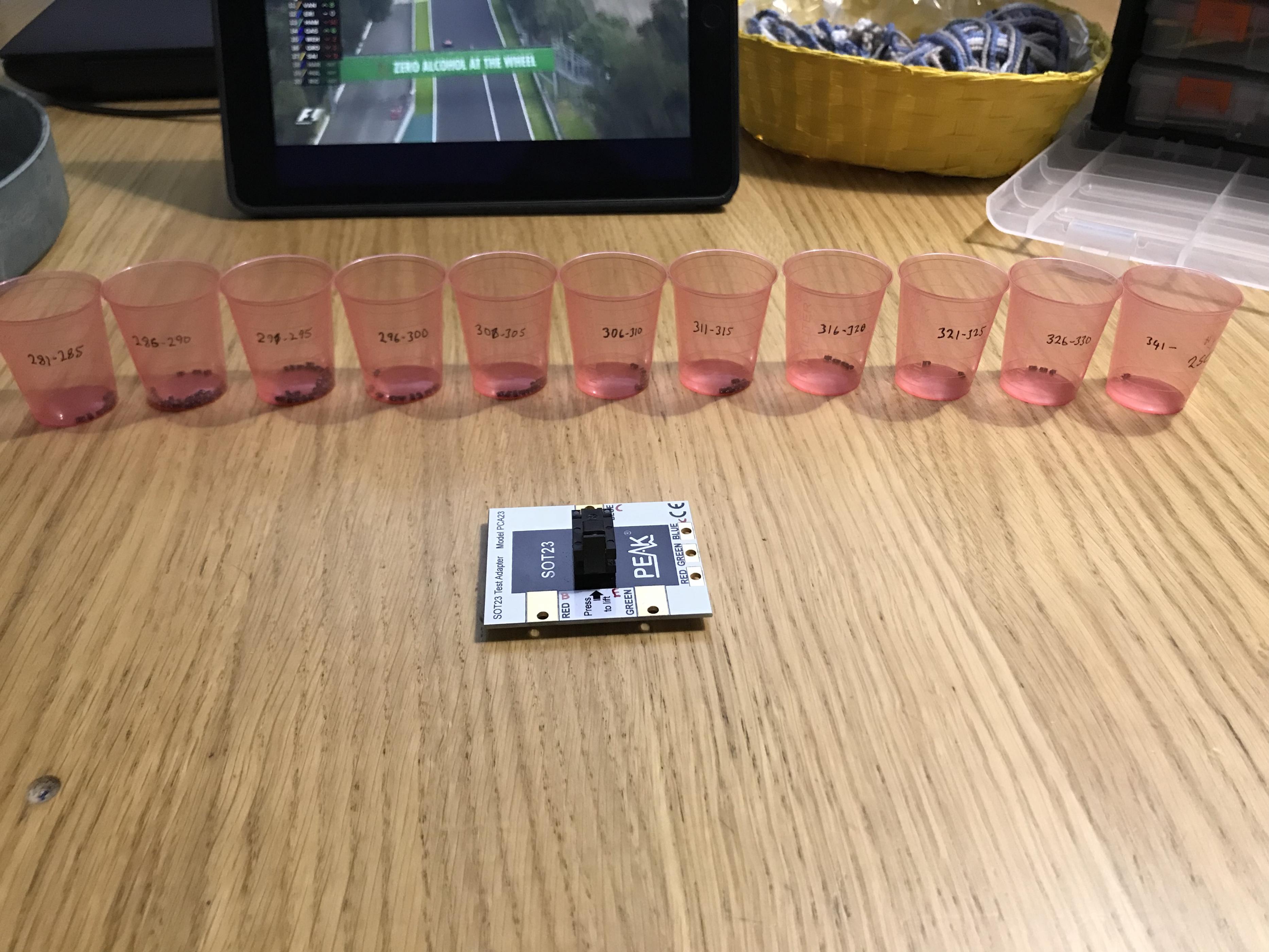

Preliminary matching of the 2SC3324 done while watching F1. Thanks Patrick for pointing out the SOT23 test socket. It made the job much easier.

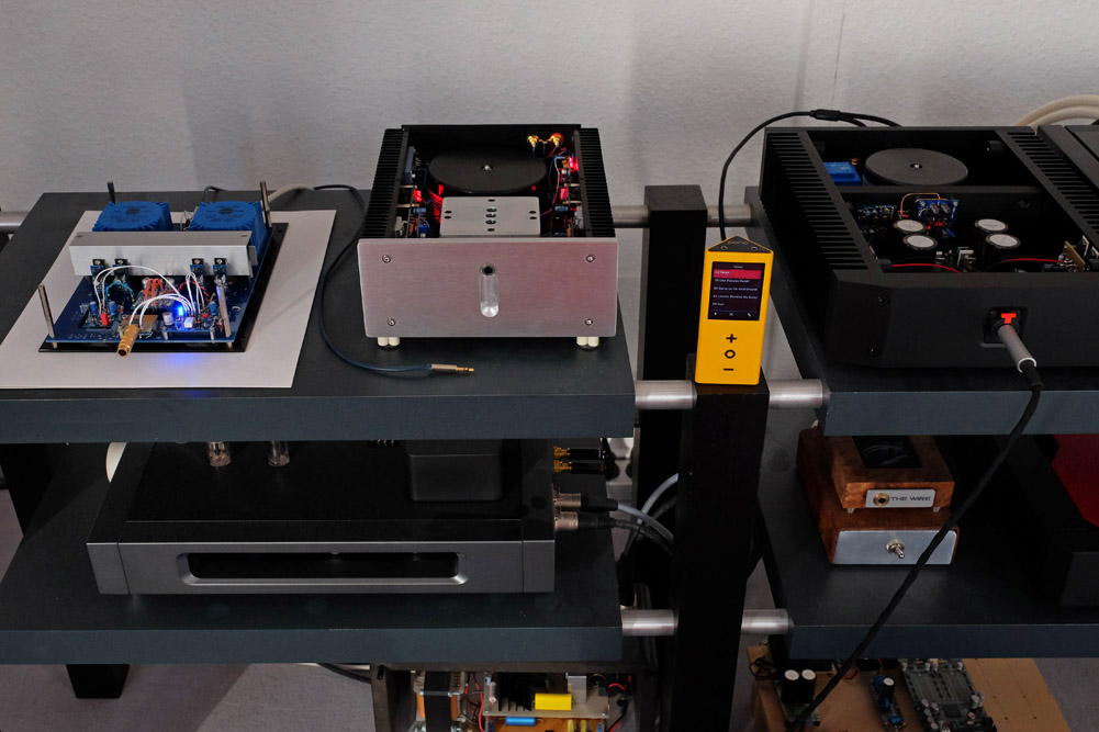

As Patrick hinted I was given the opportunity to audition the Pioneer Super Linear Circuit at my place,
and in comparison to the F5 HA and the DAO that I built during the last two years and that serve as my
benchmark headphone amplifiers since.
I have a bit of a journey behind me during the last 13 years with a good dozen headphone
amplifiers built, with various topologies from tubes over hybrid to solid state. The few that have
found my homepage might know that I was quite sceptical years ago about solid state amplifiers,
finding them sounding too cold and sterile for my taste...
Well this has changed after I got in contact with EUVL and after I heard his prototype DAO
for the first time... and it has been high bandwidth, Class A and ZGF (zero global feedback) amplifiers
ever since.
Let me say a few things first how I auditioned during the last two days:
- the source for the entire session was a PONO player (SD card player with Ayre-designed output circuitry)
- all auditioning was done with my Sennheiser HD 800 since I didn't want to introduce too many variables.
My Senn's are slightly modded --> damping of the inner cavity with felt and a layer of very thin tissue as
acoustic "filter".
Despite the fact that some consider the Sennheiser HD 800's as overly bright or analytical this is not the case
when used with proper equipment --> every USB converter into a DAC still sounds a good deal less natural
than a PONO Player for instance. Even beats the R2R DAC that I also use. But that is another story... 😉
OK, back to the Pioneer Super Linear Circuit:
Almost as expected the Pioneer circuit as employed by EUVL sounds very natural indeed and utterly transparent.
There is not a hint of background noise on the Sennheiser's, but with my daughters "cheap" Beats Solo a tiny
trace of hiss could be heard. But I was said that it will disappear when cased up, while being at the very
threshold of my hearing anyway.
Other than that I really had a hard time keeping the Pioneer SLC apart from the DAO... which is quite
exceptional considering the complexity and financial outlay for the DAO. On some pieces the Pioneer sounds very
much the same, on others you have to concentrate hard to hear a difference at all.
To me the DAO is the holy grail of SE headphone amplifiers --> DAO - Original-Ton
since it portrays music in a way that leaves nothing to be desired... everything sounds perfectly integrated
and as part of the picture, nothing stands out.
But the Pioneer comes very close, and it almost comes down to a matter of subjective and personal taste
rather than one really being better than the other. The Pioneer is a tiny bit brighter in general, for instance
on high pitched piano notes that stand out a bit more than on the DAO. There is no trace of harshness or grain
to be worried about. The Pioneer has a tight and well controlled bass with the DAO hitting a bit harder.
Both are capable of a kind of 'intimacy' when listening to your favourite tracks, with all the resolution even of
minute details you'd ever want (keyword atmosphere 😉) Imaging with the Crossfeed circuit is slightly different
between the two but I couldn't point my finger to which one is better. ;-)
I also heard the F5 HA in comparison, but eventually left it out of the comparison simply because it was getting
too troublesome to switch source and headphones after every track between three amplifiers! The F5 HA as the
UTAiM are clearly from the same stable, but comparing ALL of them has to be left for another occasion.
