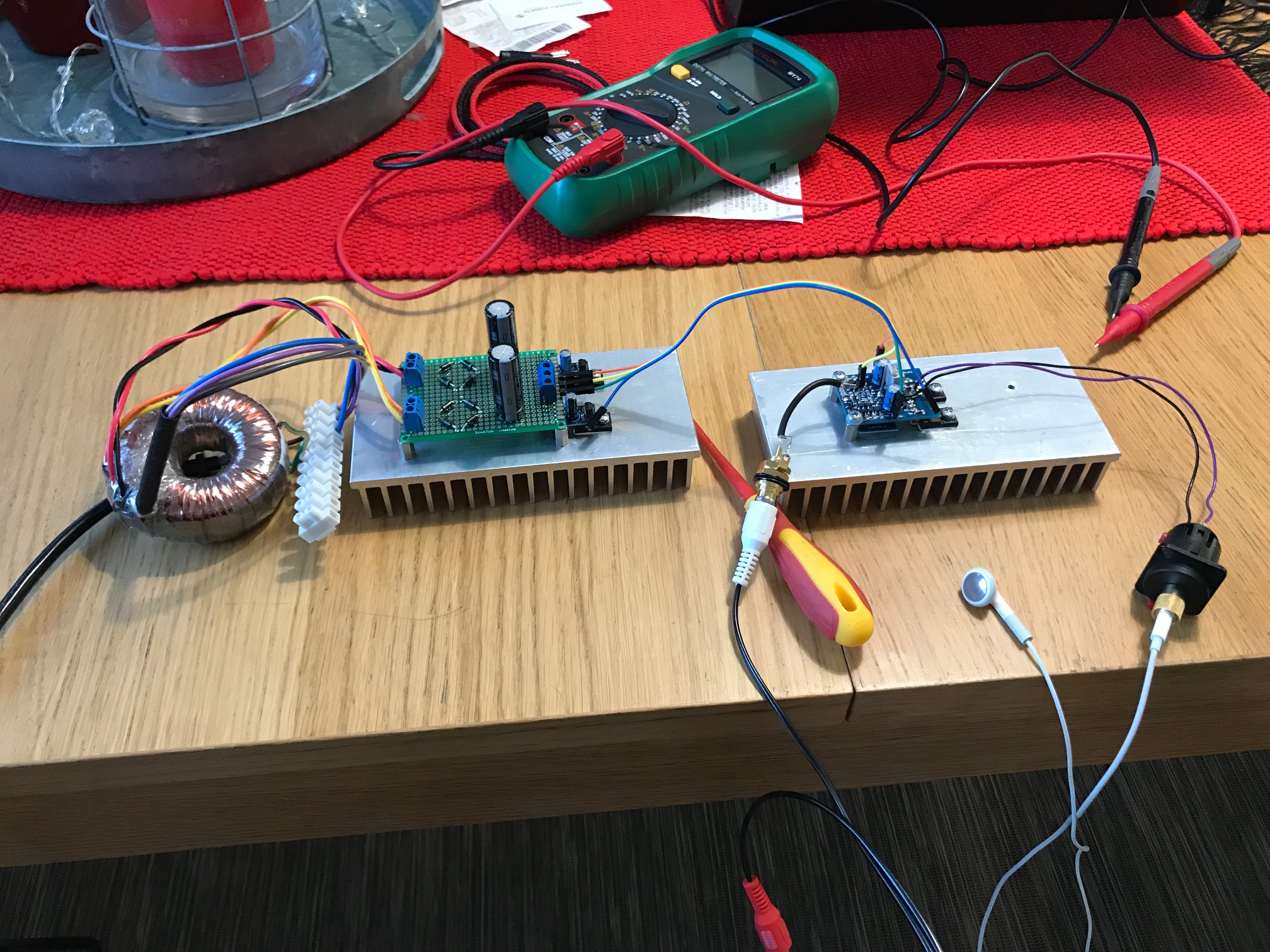

I got the DC offset settled and now its hovering from -2,5mV...+2mV. A 100k resistor in parallel with R44 did the trick. I believe this is because in the schematics provided with the group buy the CCS1 (R42) is connected to negative polarity and the CCS2 (R44) to positive.
You are right, my mix-up.
Adding a trim resistor to R44 reduces the +ve bias and hence reduces positive DC offset.

My mix-up was that from memory the trim resistor was on the other leg of the current mirror.
In actual fact, the trim resistor reduces (rather than increases as I originally thought) the bias.
Should have checked schematics before answering.

Yes, I have the SHPP board ready and tested. This was just a quick test with iPhone plugs to verify everything is working.
One more tiny thing.
The power supply Gnd should go to the (Power) Gnd pin right between the two electrolytic caps.
This should also serve as the Gnd pin for the output.
The other Gnd pin to the front is only meant for the input signal, i.e. Signal Gnd.
If you want to be perfect then even skip the Signal Gnd and solder everything onto the Power Gnd pin mentioned above.
Then it is truely star Gnd.

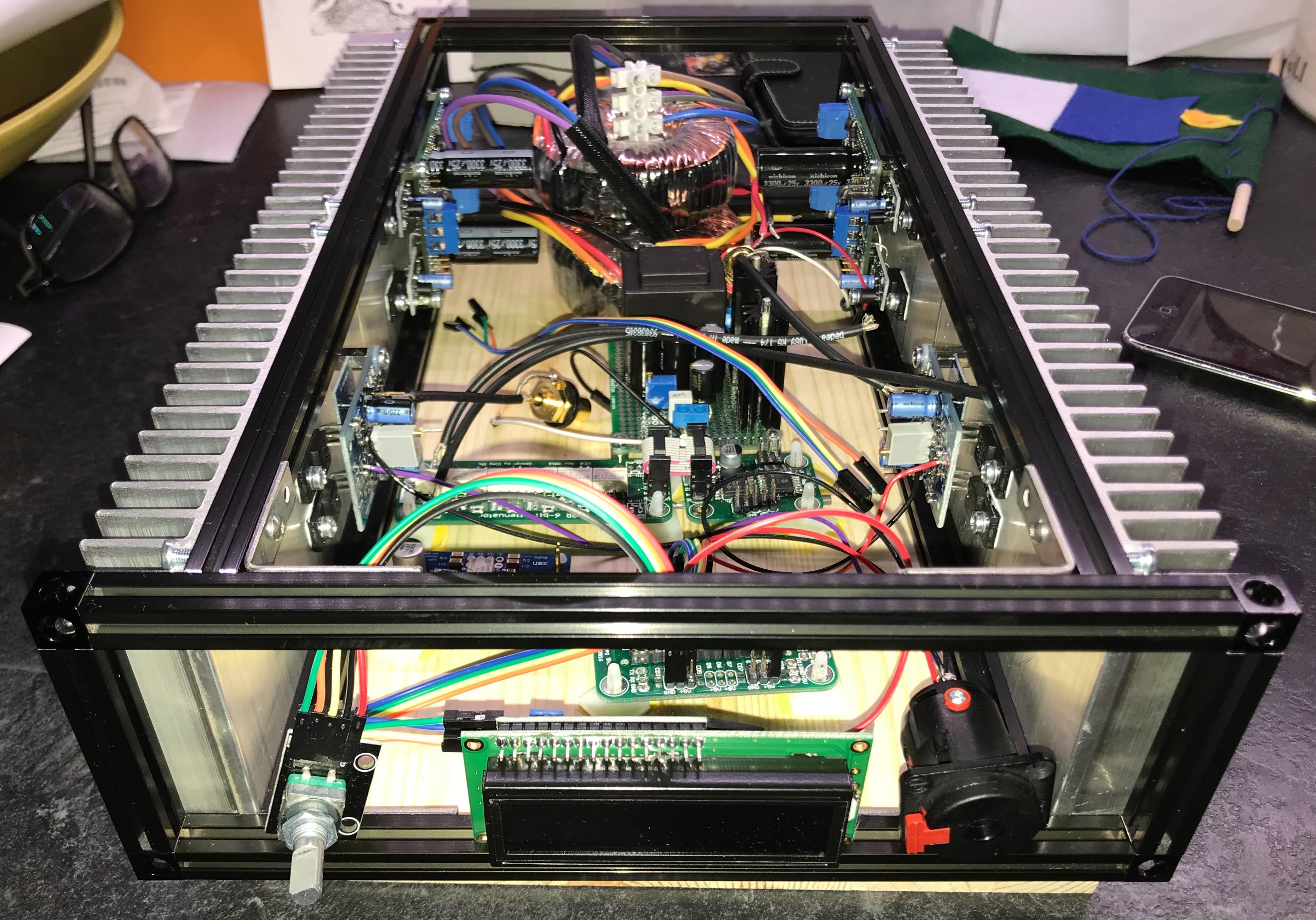

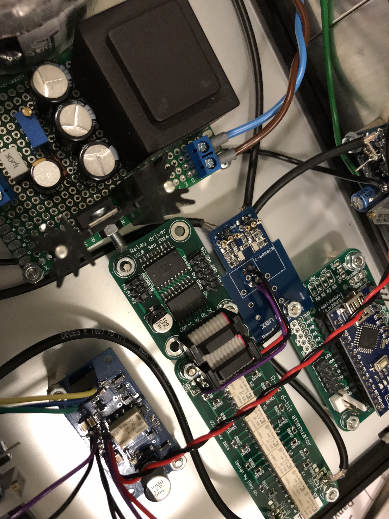

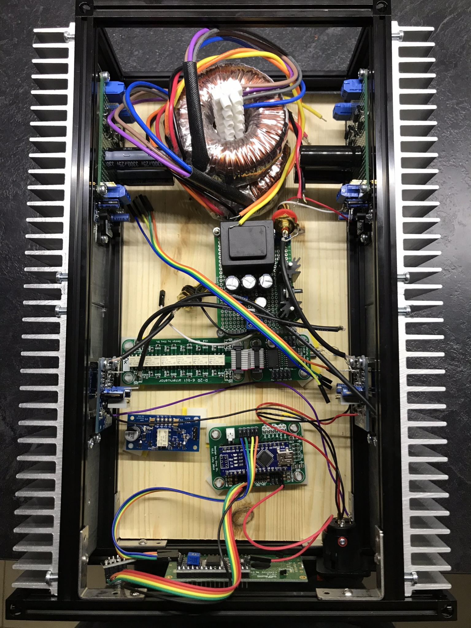

Now I have both channels tested and adjusted. Just a lot of drilling and chassis work to be done before completion. I attached a couple of ”spaghetti incident” type of pictures to present my layout plan. So there will be Oleg’s R-2R stepped attenuator for volume control and also the Xen SHPP board is shown.
Yeah, the bigger the better! I guess this could well be a power amp enclosure but what the heck - the heatsinks were cheap and I had the Makerbeam parts laying around.

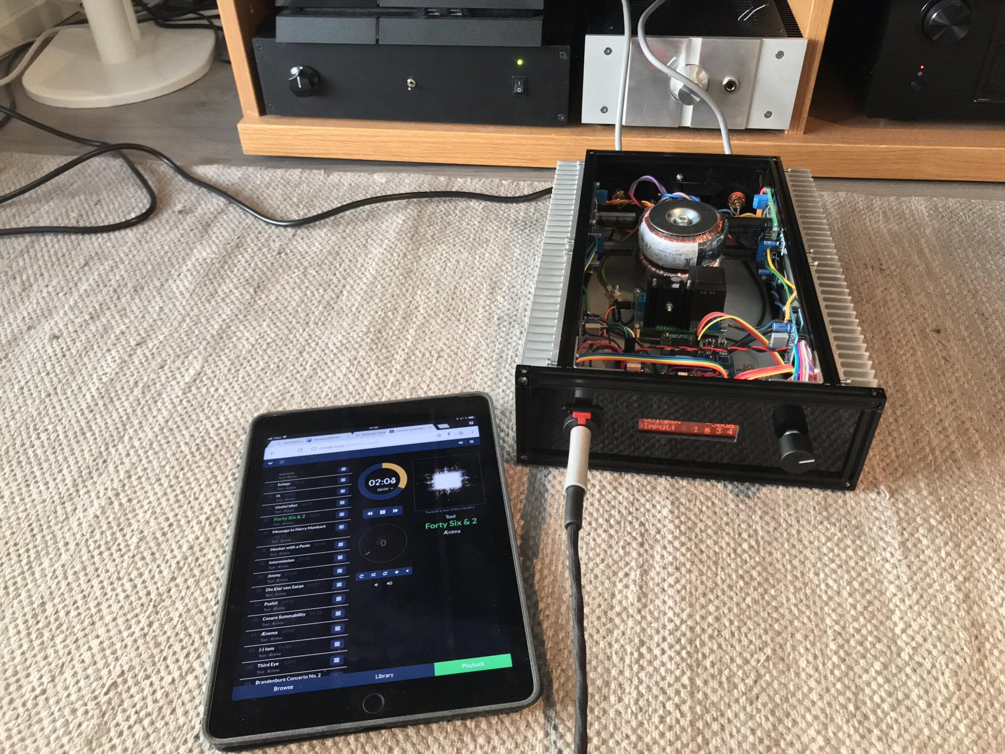

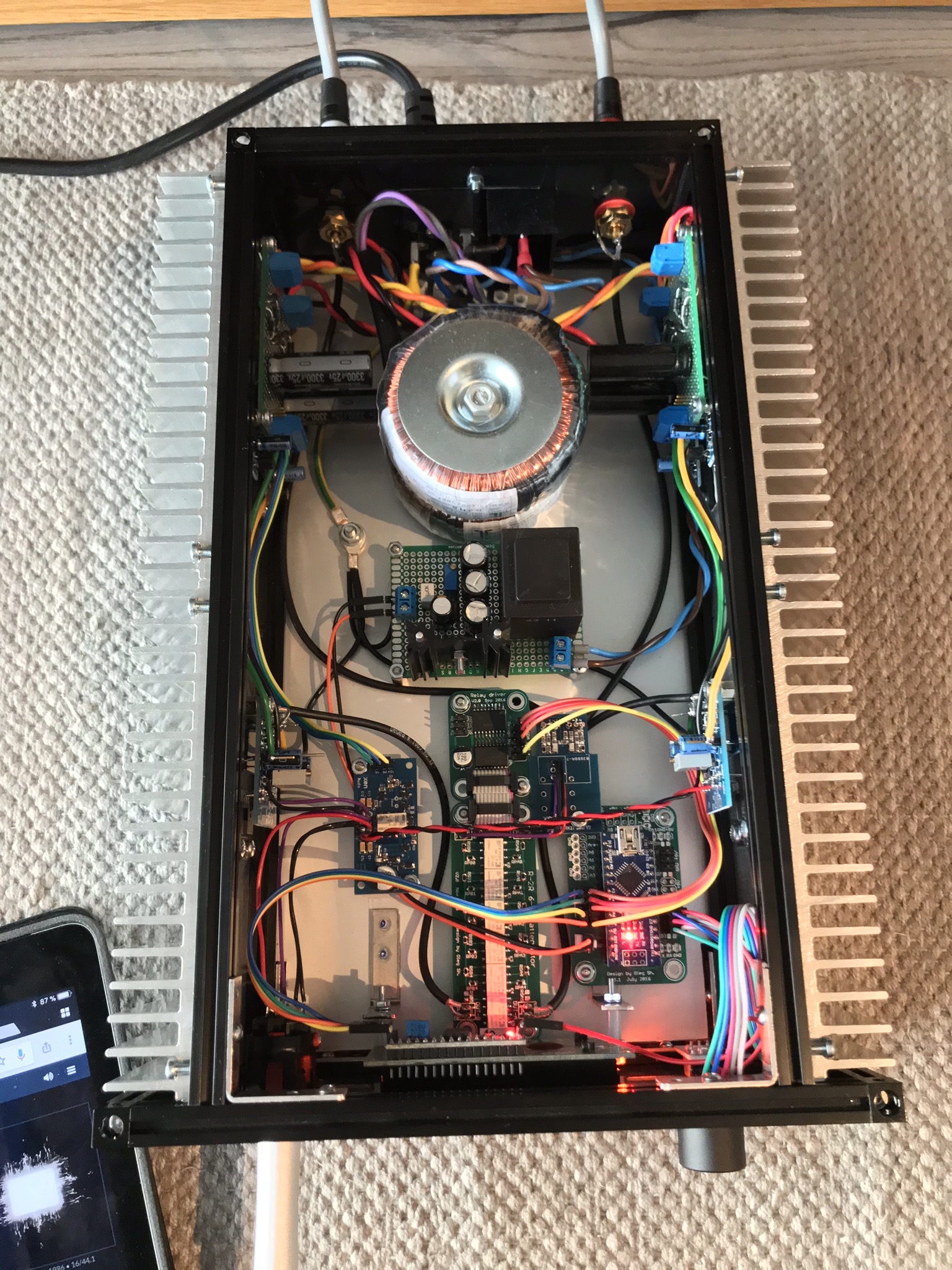

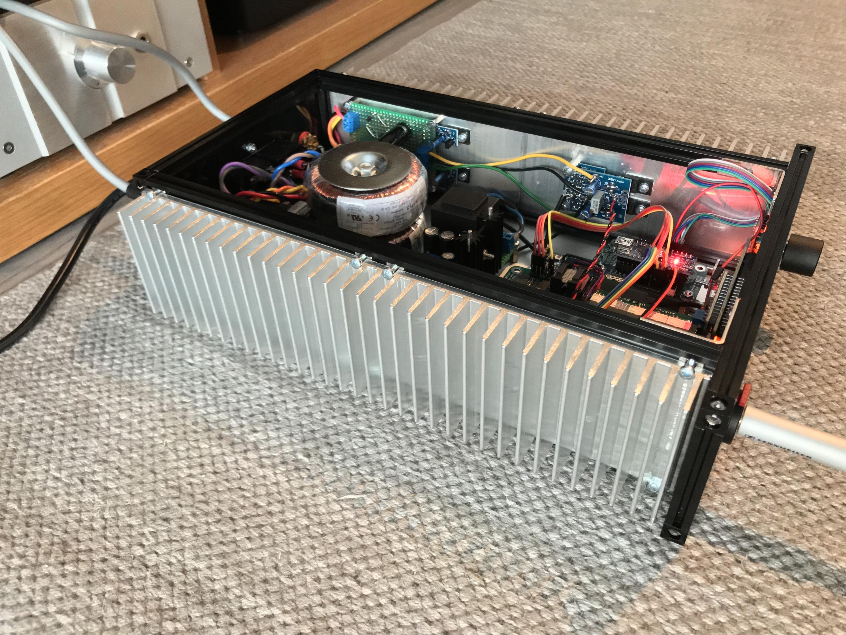

Yay, It’s rocking! Even though the top cover is not yet produced and the front panel is also only temporary... But hey it sure sounds nice, better listening impressions later. I attached a couple of pics. I have noticed along my projects that I just can’t make the wirings tidy. Propably just too lazy. 😀 The main thing is that it’s completely hum free and only faint hiss can be heard with iPhone plugs, but not with my other headphones.

The hiss should go away when you tidy up your wiring, especially all the digital stuff.
I presume you are using JFET input buffer, CCS bias and no DC servo.
