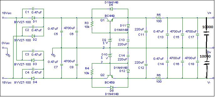

Hi. New Here.
To comment on the residual HUMMM I had my VSPS 300, very light that was perceived to maximum volume.
I followed all the advice that I have given forum and HUMM persisted.
I ralicé all the wiring again turned AndrewT as I said, and that slight HUMMM persisted.
Qye to put the grinding plate another phono DIY, adding 10,000 uF more by rail and Hummm disappeared as if by magic.
All that is perceived to maximum volume is Hisss to bring hearing to the tweeters.
By Needless to say, the sound, the music played by the VSPS is sensational. He is missing this fad that had remained completely silent.

I'm glad you got it worked out to your satisfaction.
So if I understand this, you replaced the VSPS power supply (just transformer and diodes) with a regulated one shown in the schematic. There you had some hum, but adding additional 10,000 uF caps to the output rails made it quiet?
I don't see how doubling the already huge 9,620 uF to 19,620 uF (almost 25,000 uF per rail if you count the capacitance before the pass transistor) would make any difference. I would imagine it is something more to do with where you installed the large 10,000 uF capacitors that they somehow managed to kill some ground loop.
RJM, that I have done is purely empirical, without any scientific basis. Do not forget that I am not in electronic technician; only I encouraged me to assemble circuits designed by someone who knows what he does. I am just a doctor who like good audio within reach and that over 18 years have reinforced my own systems (now I have 55 years and I desestreso the vicissitudes of my profession audio listening and building parts).
I probably made a mistake that led to VSPS to have a slight hum of 50 Hz.
Anyway, I repeat, the VSPS is a very good preamplifier, the best I've heard and built.

I am always interested in learning about problems people have, and the solutions people find. It was just a little difficult from your post to figure out exactly what you did.
R
R
I agree...............I don't see how doubling the already huge 9,620 uF to 19,620 uF (almost 25,000 uF per rail if you count the capacitance before the pass transistor) would make any difference. I would imagine it is something more to do with where you installed the large 10,000 uF capacitors that they somehow managed to kill some ground loop.
There must be a change in shape, or location, that is giving an attenuation.
Some measurements would help in assessing the size of the change in hum+noise.
It may be that by replacing two original diode bridge rectifier and regulated by this board, have replaced a defective bridge to allow the passage of alternating or without half-wave rectified ?. The addition of the two Nichicon 10,000 uF was simply empirical.

just a thought.. would a dry joint on a capacitor cause a hum problem? it might be that by changing the caps that the dry joint was fixed which resulted in the hum disappearing... but i'm more than likely barking up the wrong tree again.. lol

Bibio, I have completely revised the circuit from defective welds to mistake components.
I have not been able to find the cause of small HUMM.
If there is a faulty capacitor I have not found.
But I have empirically solved by replacing the diode bridges other Schottky diodes; adding capacitance to the power supply and making RC filter
