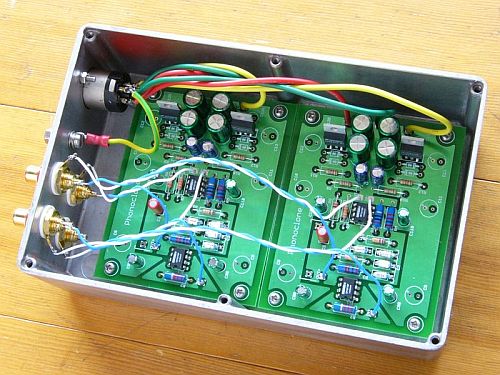

I've populated my VSPS dual mono boards and now am planning out the rest of the preamp.
Plan is to use this eBay switch powered by a separate 12V supply:
And then this stepped attenuator for volume.
And use the fully differential line stage from amb.org.
I have an old wooden record player enclosure to play with and will likely use aluminum sheet as a base for grounding and such.
Question for the help desk:
I'm planning on putting the volume control between the input selector and the line-stage. That follows best practice guidelines, yes?

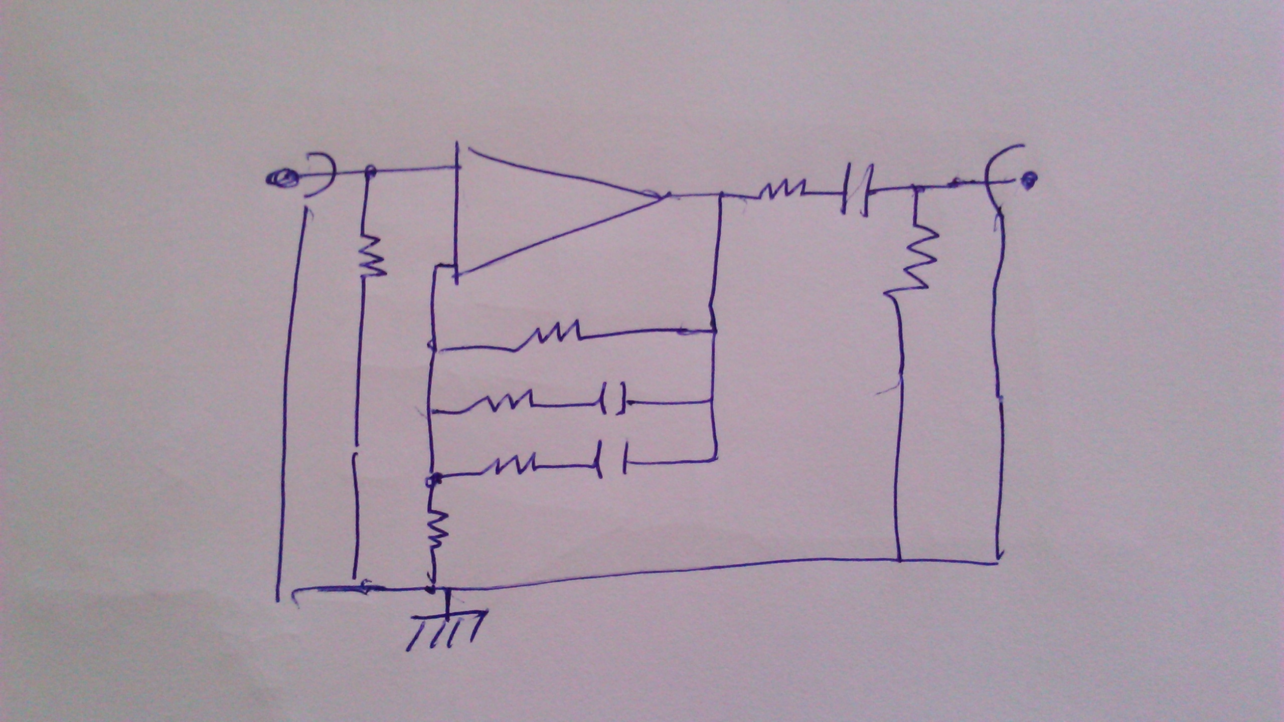

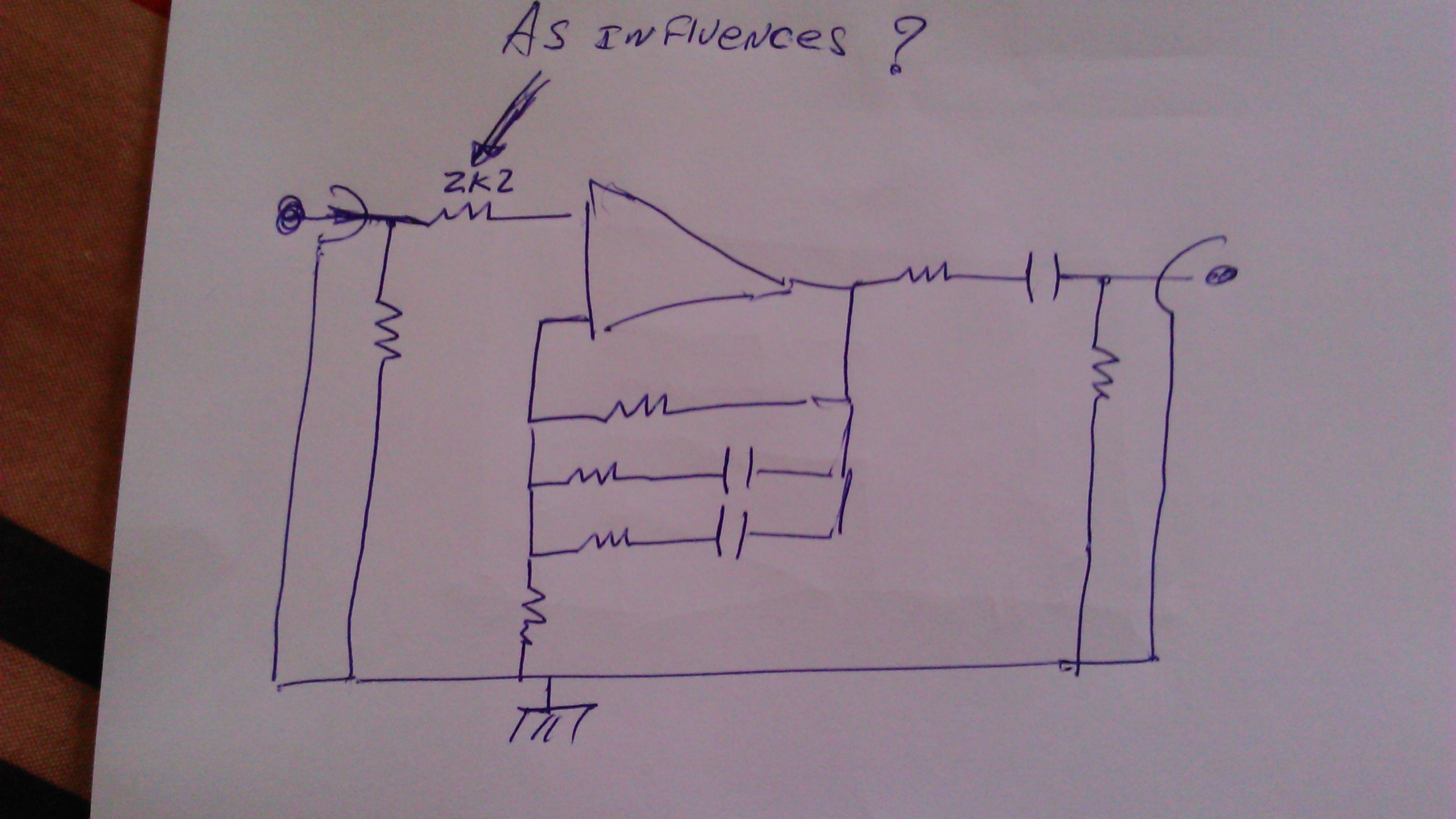

Hi, I wonder about modification of the original circuit VSPS.
Adding a resistor 2k2 at the entrance, completely removes the residual humm I had.
Deteriorates in some other aspect of the circuit ?.
The addition of this resistance was in evidence as in other circuits I've seen (it is in the phono pre Rod).
Another point in the photo guide construction, the chassis ground circuit and is welded to zero volts of power supply connector. It can be done well?
Regards.

Adding 2k2 in series with the input impedance (~500-1000 ohms for MM carts) should not have a significant effect. It unbalances the input slightly, and increases the input noise slightly. That's it as far as I can see.
