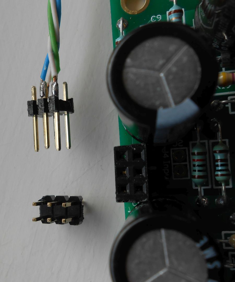

great Andrew but there are only two holes on the PCB 🙂 unless you slide the other pins up and off the board.

here is the 6pin DIP plug and socket I used to connect a 2pin Signal to the NX amplifier PCB.
The 4 outer most pins are the Signal Return. The two middle pins are the Signal Hot.
The plug has the two white Signal Returns attached to the diametrically opposed outer pins. The two grn/blu Signal Hot of the star quad are attached to the two middle pins of the plug. This sort of maintains the fields of the quad through the pins to the socket.
