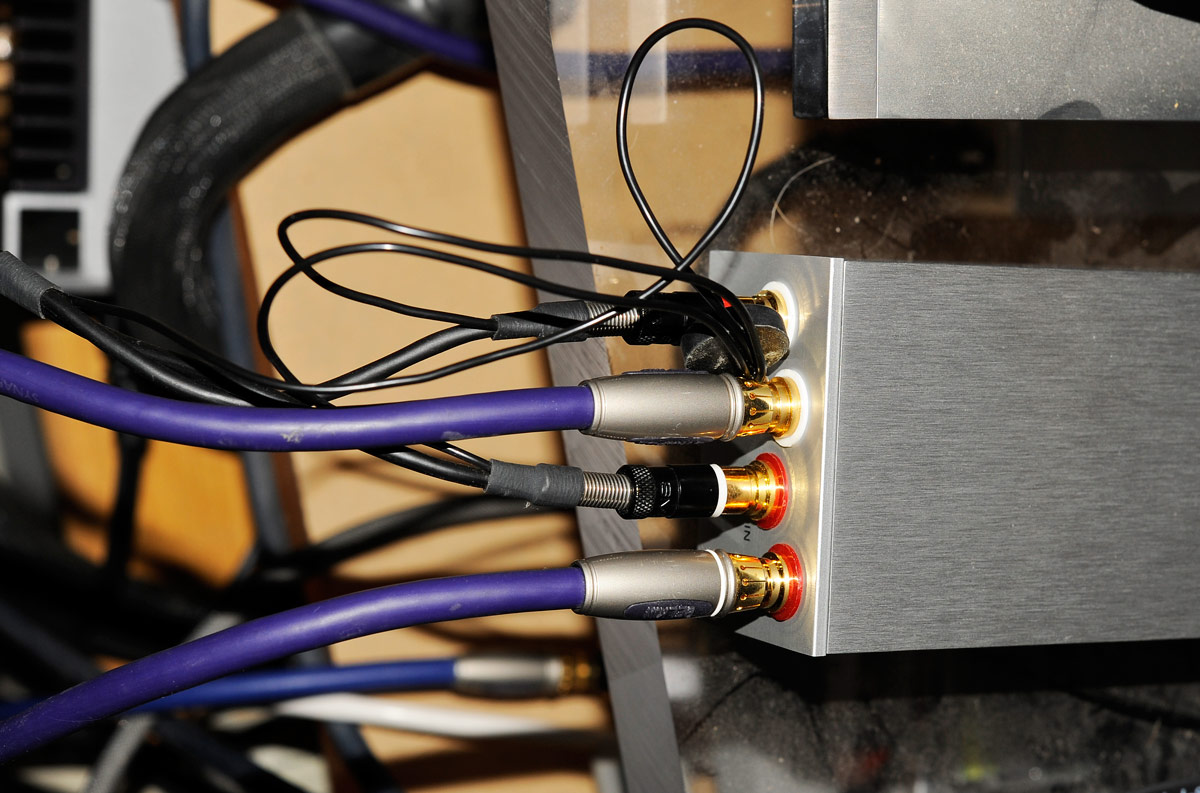

I've just built a preamp for a customer and was testing it before shipment. The unit was built exactly as pictured ion a first page of this thread. Chassis is grounded through the earth pin on a power entry module, RCA jacks are isolated from a chassis. I'm using Shelter 901 mounted on SME V tonearm.
There was initially low level hum at maximum volume level on a TVC based preamp. After ground wire from TT was connected to the chassis or one of the RCAs, the hum disappears.

I don't really have any particular advice here, as it seems like the problem is system dependent, however, this is what I observed today in my setup:
