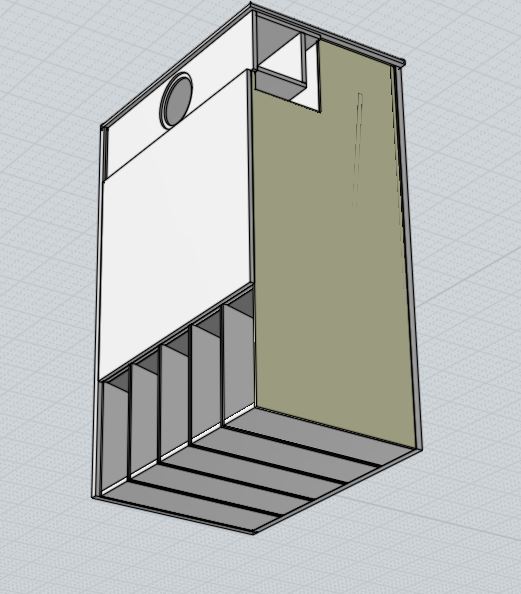

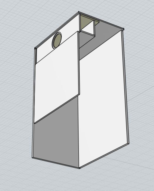

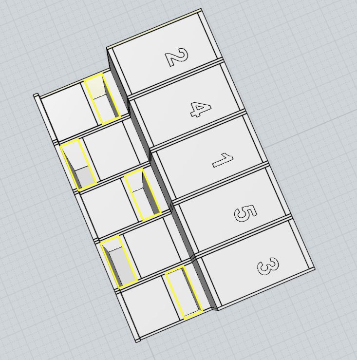

The PANPIPE (Pentahorn) BLH Speaker
3D views of all 5 horns
With obscuring panels hidden so the inside can be seen.
Thoughts?
I can make as many of these kinds of views as needed pretty quickly.

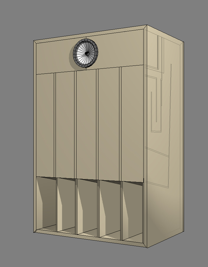

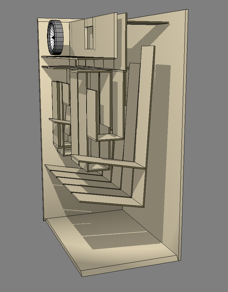

closed PanPipe
Here is a 3d view with everything visible.
How it will really look.
I can think of lots of ways to make this look cooler (one thing I like about these kind of folder horns is the aesthetics...)
But this is X's design as drawn, or as close as I can get.
Lots and lots of parts.
Colin

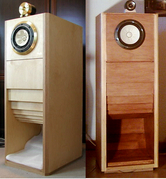

Sound quality is obviously why we all want full range speakers instead of multi- driver speakers with time smearing crossovers in them, but it has to be said that BLH speakers can look really cool. I like the Nagaoka ones with the exposed edge plywood boxes and the stepped plywood horn shaped mouths.
Like the image attached - this is not the coolest example ever, but one I could find quickly.
I love how this looks, as each plywood step explains in a simple visual way the power of the overall exponential form.
The PanPipe, as designed now, is not unattractive. Are there ways to incorporate some of the aesthetic in the Nakaoka designs without ruining the design's sonic properties, or making it too hard to build?
I would love it if the row of identical square mouth openings to be replaced by a series of different size openings (just a little, not very different..) and interior treatments which express on the outside some of what is going on on the inside...

Colin,
I would make the longest one bigger and get smaller. Look at plots on post 1 and you can see which horns have what output. Musically, it males more sense to get lower bass more gain to compensate for baffle step losses. I don't think stepped mouths have much of an effect at bass wavelengths which are much longer. They look nice and may serve to smooth out higher frequencies. You as the builder are allowed artistic latitude. :)
Looking forward to the build if you really indeed plan to build it. It will be one of the most ambitious BLH projects ever! :D
X

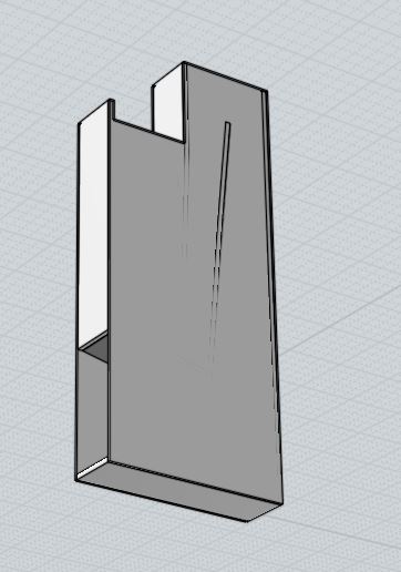

Now starting to really think about how to practically build this.
I am thinking of a modular approach - construct each horn section as a module with two 1/4" plywood or Luan side panels as a sandwich for 1/4" plywood or foam core flow guides forming the horns.
The outer dimensions would all be the same - 5 separate sandwiches. 5 1/2" wide (5" horn section plus 2 1/4" side panels.)
Then, build the Driver chamber and plenum as a separate assembly, maybe out of 1/2" ply.
Then build the outer box out of 3/4" plywood.
Slide the horn sections in one by one, then screw the driver assembly in front.
With this approach, the horns would be pressure fit somehow, and not be glued at all. It might make sense to wait to cut the main box's width panels until I could measure just how wide all 5 horn modules are when finished.
Maybe some silicone caulk around the openings between the Plenum and the horns to there are no leaks.
Would this be a good approach?
My reasons for the approach is to eliminate lots of very tricky glueing which would not allow for mistakes - there would be no going back if something went wrong.
Thoughts?
Colin

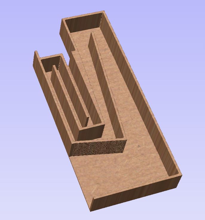

Horns made from two pieces of 1/4-in baltic birch with 5-inches of MDF sandwiched in between. I don't see building it completely solid, just glue in the pieces where material is to remain. Save a lot on MDF that way. Cavities will be milled out of the MDF. After milling is completed the second piece of birch will be bonded on the MDF. A final pass on the CNC router for sizing and one horn done. Rinse wash repeat.
Enclosure will be 3/4-something, haven't decided yet. Front piece is 1/2-in. Need the front piece to help keep the rest in formation with the bottom off.

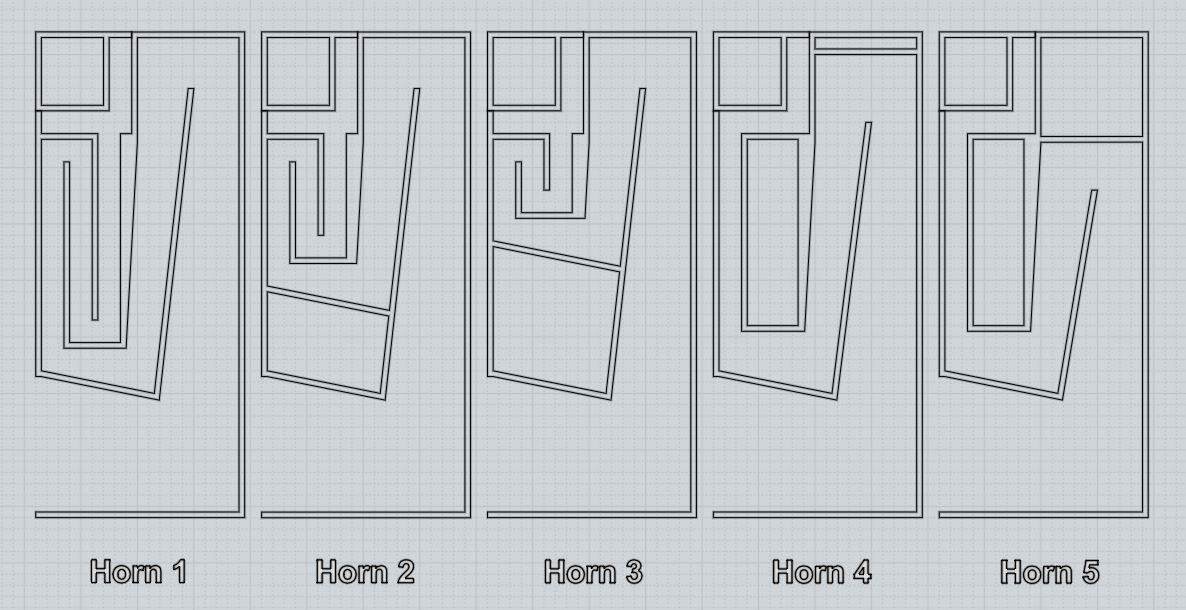

REF: "Horn Cavity Vectors.jpg"
I would appreciate a professional check of the horn vectors. I would like to not deviate from the original concept. That is a 1-in grid.
