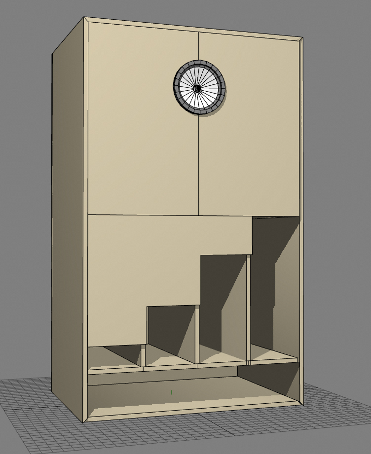

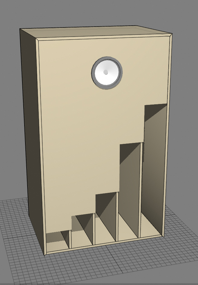

Initial 3d model mock up
xrk971 -
Here is about 20 minutes of modeling in 3D. Super simple.
I started attempting to make the simplest possible version of your sketch, but then, reading your description more carefully and seeing that different size mouths are needed for different size horns, and with some aesthetic instincts to make the design visually refer to a Pan Pipe, I made each horns mouth a different height. this might complicate things later, but I thought I would see what you thought.
(The speakers would be mirror images...)
There is some aesthetic appeal to 4 out of 5 being the same height and only one bigger. Could there be 4 the same height all the way across, and one big full width one across the bottom?
Colin

Colin,
I like what you have done - nice work there. However I don't think I said that the mouth sizes were different. The mouth sizes are all the same in fact at 5 in wide x 12 in tall and for the reason that the mouth controls the expansion ratio and hence bass gain for that particular frequency band. In order to keep the levels even, the mouths are the same - what is different are the lengths. Tom Lang has a good drawing of one set of channels - that is the idea. The throat entrances to the beginning of each horn or pipe needs to follow the prescription given and locate it somewhere convenient on the driver chamber wall at the bottom that forms the top wall of the horns entry region. I will try to sketch out something in more detail when I get some time. Thanks for taking interest and reviving this thread.
X
X
X - the very top post says "Horns mouth 1 (longest) will be 12 in tall x 5 in wide, the rest are all 8 in high x 5 in wide." This is what got me started on thinking of aesthetic interpretations of expressing the range of horn sizes on the exterior, which I thought would be a cool looking way of expressing how much complexity is going on inside.

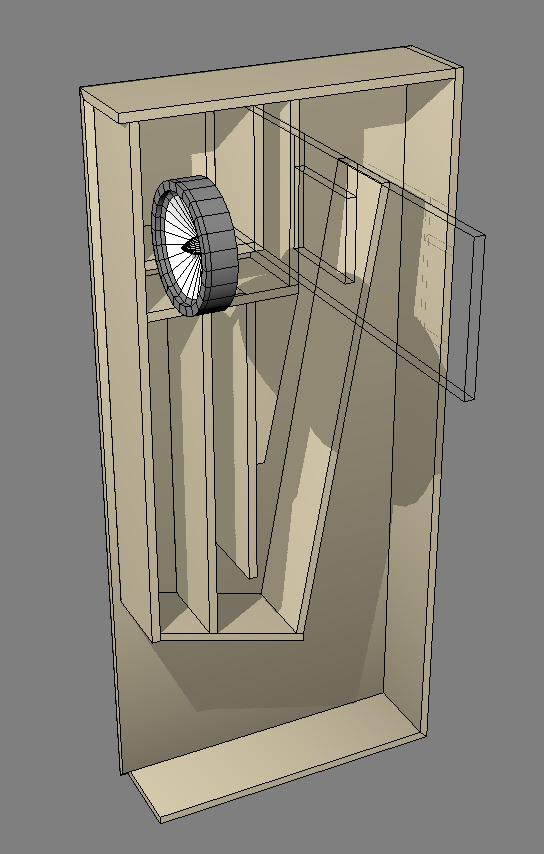

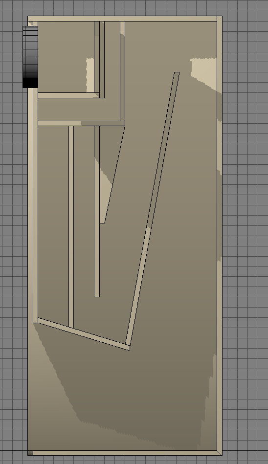

Here is version 01 of horn 01 -
In the left most position of the 5 horns. (this is still up for debate...)
A little hard to grasp visually as it is only a 1/5th slice out of the whole speaker.
I think it is best if I treat each horn individually, and figure out the final dimensions of each part at the end.
Can I assume a 1/2" thickness for the dividing panels? (For an ultimate wooden version... Foam core prototypes will have to scale to the middle dimension of each part...)
If I were building a prototype, I would go with 1/2" plywood for the outer box, and 3/8" for the foam core.
For the final. 3/4' plywood outer box and 1/2" plywood inner dividers..

Colin,
Nice work ! Thanks for taking this on. This is a good start and I am glad you are eager to get going on the model. The 3d model as you have drawn it though is not correct. The horn path needs to have another bend in the front. Look at Tomlang's 2d drawing to get an idea. I will draw some more sketches for you to work with to make this clear but the "flow" from the driver chamber goes to the plenum which you have correct then that goes to the narrow channel from the top (same one you show connected to larger exit) then turns 180 up and to the front then 180 down and to then 90 back to the main horn mouth exit. Note that the passages from chamber out needs to gradually expand. You show the flow contracting as it goes out. That should get you going on the general layout and architecture.
