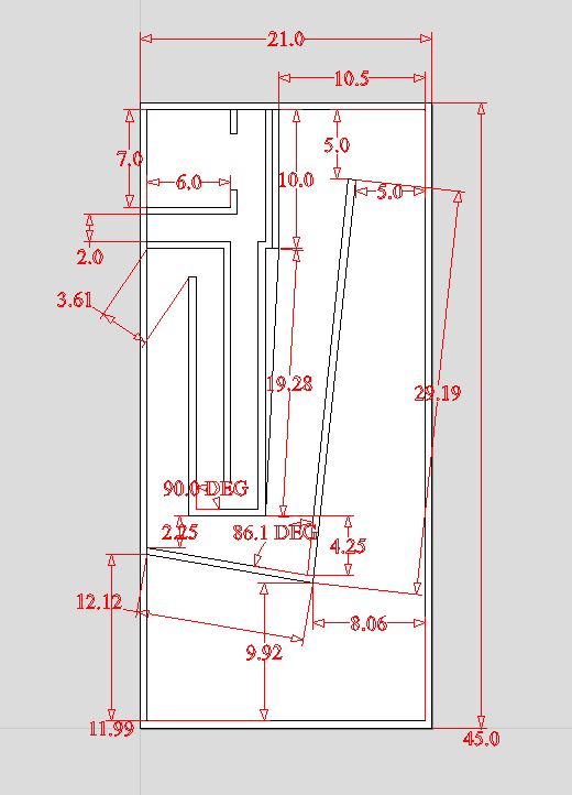

X all I have to say is WOW. I might have to work up to that build. Looks very cool. Good luck to any who tackle this build. Love to see pictures.
Each layer is an easy build, take it one layer at a time, one day at a time. In five days you will have a Pentahorn! I would do it but I can only do sims in the near future. I will have to live vicariously through you guys🙂
Let me know if you have any questions on how to start. I think Bcmbob having done the DNA will agree that this should not be too hard, just time consuming. Rest assured it will sound good because the models I have done so far seem to match listening impressions and measurements.

cogitech, are you going to draw this? I may be able to make a Sketchup model.
Tom,
That would be awesome if you can do s 3d model in sketchup. The plenum and throat hole cutouts is tricky but should be doable based on info I have given. 5 inch wide slots to match each horn width and depth of slot as prescribed. The 0.5 in xps foam is definitely the way to build this as a test.
Good luck guys!
Good luck guys!
Tom,
Thanks for drawing it up! Looks great. I actually intended to have a slight expanding taper in the rectangular section by slightly angling the dividers but it can work pretty well as vertical (straight up and down) sections with each successive one slightly larger than the previous. For example: 2.0, 2.5, 3.0 in. This way is certainly easier to build. Very nice work there. Having a good drawing will really help folks to get over the initial hurdle to try building it. I hope you give it a try. 🙂
Thanks again.
X
Thanks again.
X
Your not wrong there, I've spent 2 days thinking 'Eh?'....... it looks interesting enough to maybe give it a go, IF I can find a drive unit in the UK/EU (for reasonable money)Tom,
X
Sippy,
Thanks for seeing that I may be on to something here. The Monacor SP50X will work and should be available in EU/UK. If you have a driver in mind, post the T/S params and I will run sim to see if it works.
X
X

Scottmoose,
How do you accomplish modeling multiple horns (more than 2)? Does MJK worksheets have a way of doing that or are you using another package? If you have any simulation results I would be interested to see what you did.
Can't help but think there should be a simpler solution than essentially having five or more discreet horns. Will it really be worth the effort?
Maybe something like a long and thin karlson-like slot would get you most of the way? And/or an asymmetric cross section to the horn? Or a tapped horn with resonators?
Squeak,
Thanks for the feedback - I was hoping to get this sort of comments to guide the process but some folks wanted to see some rough plans. I also wonder if it is worth the effort but, for some Masters of the FC Craft - this sort of a design is probably seen as a fun challenge. Certainly, I would not build this as a first cut in wood. That is where the speed at which foam core speakers come in really handy. I am not familiar with a tapped horn with resonators and how that works - so you have links to that sort of design? I am going to try to approximate a Karlson aperture with AkAbak soon and see how that can help a single horn. It may work really well - we will see. I am not sure how an asymmetric cross sectional area horn will help? Plus, I can't model that with a 1-dim lumped model like AkAbak - it will require a full 3-dim model.
X
X
I'll try to find some when I get a free moment; it's probably still on an old HDD.
Not directly with Martin's worksheets; I used my own software.
As I recall, I took a look at up to 3 pipes & decided the whole thing was far more trouble than it was worth. A back-load of any kind is only useful over a very limited BW given the issues with group delay etc., which naturally restricts the number of pipes / resonators / whatever which will be of practical value. Adding a second should be able to address the one potential major harmonic issue you'd run into with a single pipe, assuming it's damped & the driver is positioned sensibly, but of course, you then have the harmonic modes etc. of the 2nd pipe to take into account also. Mass-loading them will help, but since you could do that with a single pipe in the first place to address all of the potential problems, it rather negates the point of using multiples so presumably you won't want to go down that route. Fun to play with though.
