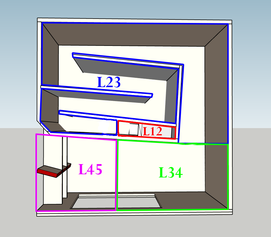

Can't edit my post, seems like my drawing is bad once again but :
- L12 actually starts at the middle of the driver, so =~27,5cm
- L45 extend to the end of the horn, that's where it gains some length and then =~36.5cm
I think it's because you can't add a S6 and the last expansion is so short, it doesn't affect that much the response and then it's negligible.

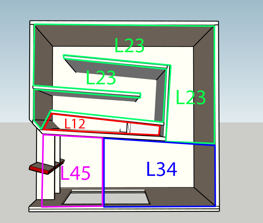

Being a tapped horn, L12 should be the axial length from the beginning of the horn to the middle of the driver. L23 should be the axial length from the middle of the driver to L34.
Alright, it seems logic to me (I measured it as well) and would then result in the attached drawing, do you agree ?
One thing I don't understand is why Ricci's value of S1 is so low ? 😕
Bigger the S1, bigger the dip at 89hz is in hornresp (if I put S1 = S2 like Brian Steele does on his workbook by example)

Alright, I understood it that way but thought the base file was made like THE Othorn 😉 .
Can't obtain the same inputs as Ricci within the workbook, maybe doing it the wrong way but since S1 = S2 once you click "Optimize", I don't see any solution.
Anyway, it's not the "easy" modification I was looking for but it could be an awesome tool for someone who want to build an Othorn-style horn !

do you agree ?
Yes, your revised drawing is correct.
Depending upon the actual expansion profile, it may not be necessary to specify both L23 and L34. It may be possible to simulate the design using just three segments in total.
If L23 and L34 are required to more accurately specify the profile, then the boundary between the two segments may possibly be better placed at a different position to that shown. That is, L23 could be perhaps shorter and L34 longer, provided that the combined length of the two remains the same.
Alright thanks ! At least it ended correct for the standard Othorn.
I could have put together L23 and L34 but considering I was going to edit L34 expansion (the complete horn was no longer expanding in a uniform way once I added the 15centimeters of height), it was easier for me to cut it in two 🙂
Didn't know where to calculate S3, took the easy way and measured it just before the bottom corner ahah.
If you leave the L23 expansion at PAR(abolic), the total volume of the sim'd horn will likely be larger than the actual volume of the horn. If you take a closer look at the layout of the panels for the L23 section, you'd see that the expansion does not remain the same from S2 to S3, a requirement for simming that section as a PAR section. I ran into this issue when trying to sim the Othorn some time ago.
