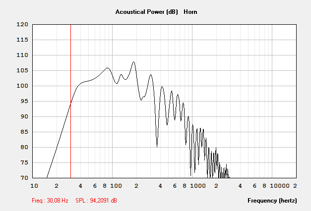

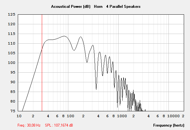

There you go (if my params are good) :
1x Hog loaded with 18LW2400 @1W/2pi

4x Hog loaded with 18LW2400 @1W/2pi

Be careful, if the sims are fine, you'll reach the Xmax of the 18LW2400 with 500W (they are 1200 AES) !
