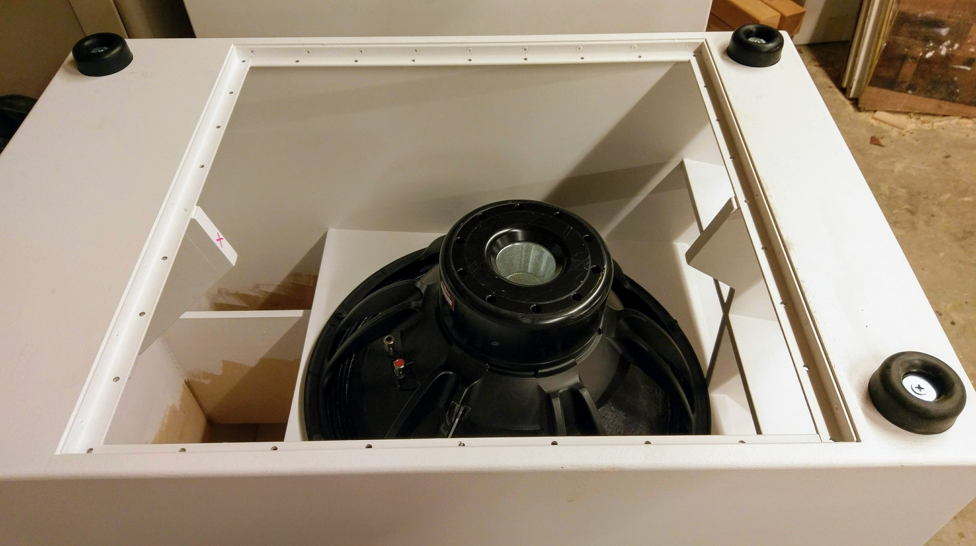

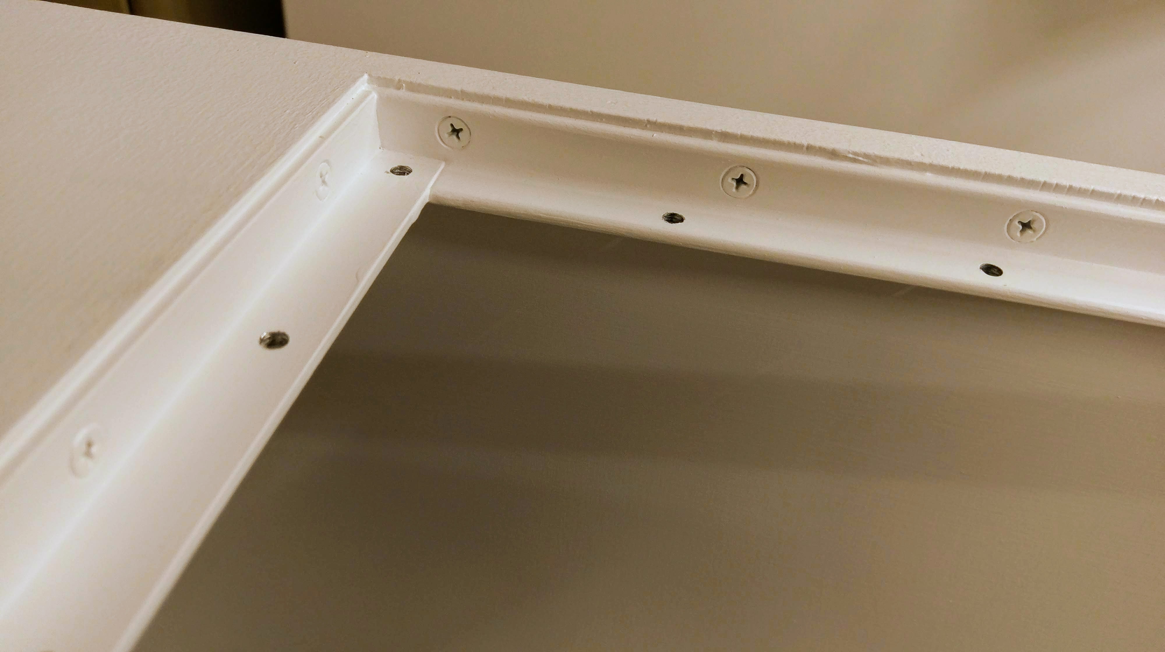

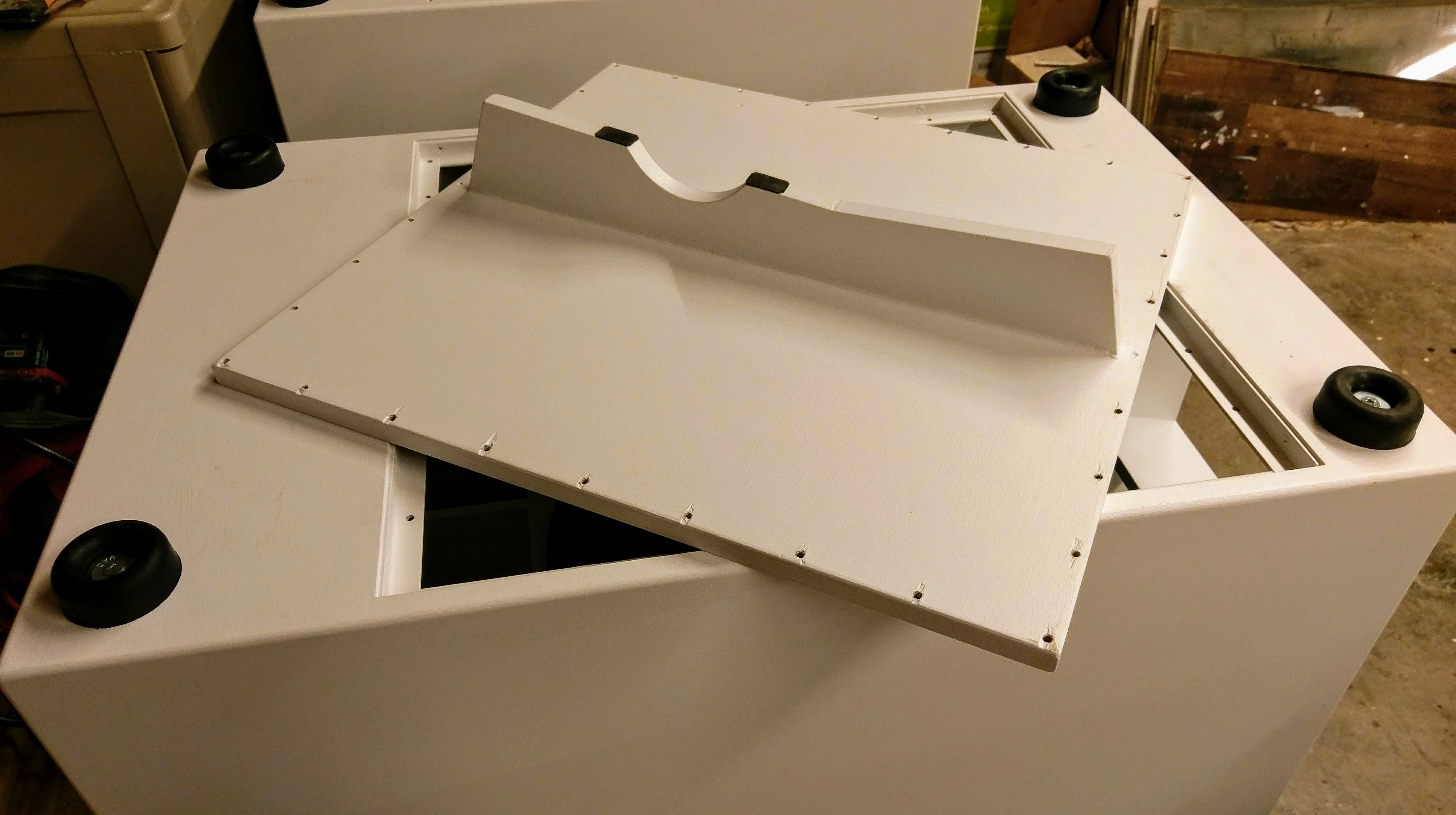

I finished building a pair of these beasties and WOW, they sound great! I am using B&C 21SW152-4 and powering them each with a bridged Behringer NU3000DSP.
I thought I would share the details of how I built the bottom hatch with driver bracing. I used 3/4" aluminum angle and T-bar. It's extremely solid and the driver is well braced from the magnet. The bracing at the back of the box butts up against an angled inset pocket for a speakon connector.
That's a nice idea. And my, what big feet you have!I thought I would share the details of how I built the bottom hatch with driver bracing. I used 3/4" aluminum angle and T-bar. It's extremely solid and the driver is well braced from the magnet. The bracing at the back of the box butts up against an angled inset pocket for a speakon connector.
Your solution made me realize I should share my solution (even though I don't have pictures...)
I simply used two pieces of 1/2" baltic glued together with one cut for the hatch and the other cut for the lip. The leftover piece from the lip was glued to the hatch.
Excellent work. They look great.

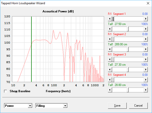

Hi !
If I want a 10cm (~4") taller Othorn, what would be an easy modification without affecting too much the response curve ?
Making the last segment of the horn taller ?
It would "just" affect the sides panels, the back panel and the 2 reinforcements in the bottom corner.
Tried to edit the hornresp inputs but not really sure of what I'm doing.
Build should start in July, ordering 2x 21DS115-4 soon ! 😉
Thanks !

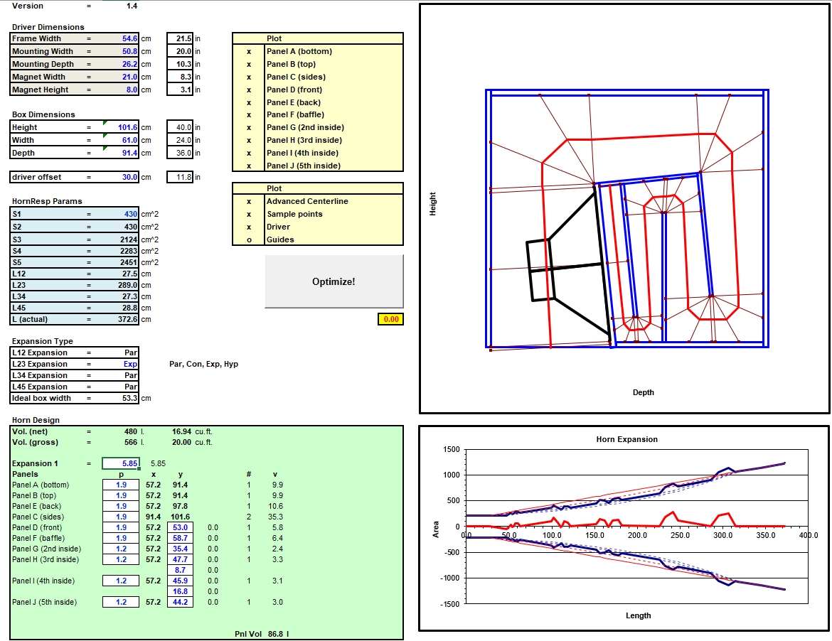

Interesting. I'd discussed something similar in my "Spreadsheet for Folded Horn Layouts" thread.
The Othorn can be approximated using parabolic segments for L12, L34 and L45, and an exponential segment for L23, at least according to the workbook I put together for it.
If you make the Othorn taller, it would be best to adjust everything else in the horn to take advantage of the additional volume. The "Othorn" workbook at the site below can assist with this. It's the latest version I have (v1.4), which lays out the panels slightly differently and fixes a few errors in the earlier versions. It will generate the corresponding Hornresp parameters and a Hornresp import file. I have not used it to build one yet (no time!) however.
If you are going to build a modified Othorn, I suggest going all the way and modeling it using the semi-inductance parameters for the driver that you want to use. If not provided, these can be derived from the driver's impedance curve.
Site: The Subwoofer DIY Page - Horn Folding
This must have been a lot of work !

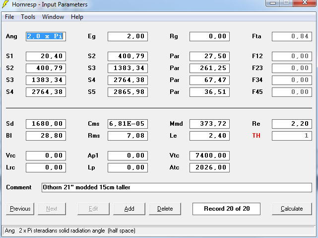

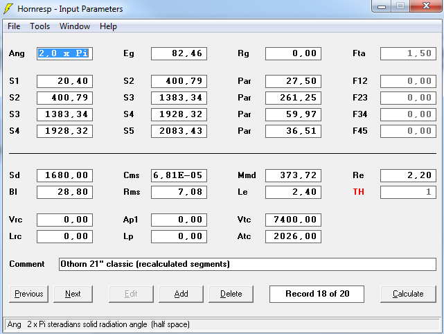

Just wondering, I opened your Excel file, exported a hornresp script but it sims way differently than the inputs Ricci gave us on the first page ?
f3 at 30hz instead of 28hz and a big dip at 87hz.
Even more weird when using the 21DS115-4 instead of the 21SW152-4
Ricci is using "20.40" at S1 where you are using "403", it has an huge impact on simulation, which one is correct ?
The workbook simulates an Othorn-type fold, not the actual Othorn. If you want to try to use it to sim the closest approximation to the actual Othorn, adjust S1 in the workbook until S2 is similar to what the Othorn's S2 is, and the external dimensions similar to the actual external dimensions of the Othorn.
Alright, I understood it that way but thought the base file was made like THE Othorn 😉 .
Can't obtain the same inputs as Ricci within the workbook, maybe doing it the wrong way but since S1 = S2 once you click "Optimize", I don't see any solution.
Anyway, it's not the "easy" modification I was looking for but it could be an awesome tool for someone who want to build an Othorn-style horn !
(And quite interesting to look at even if it's way too complex for me)

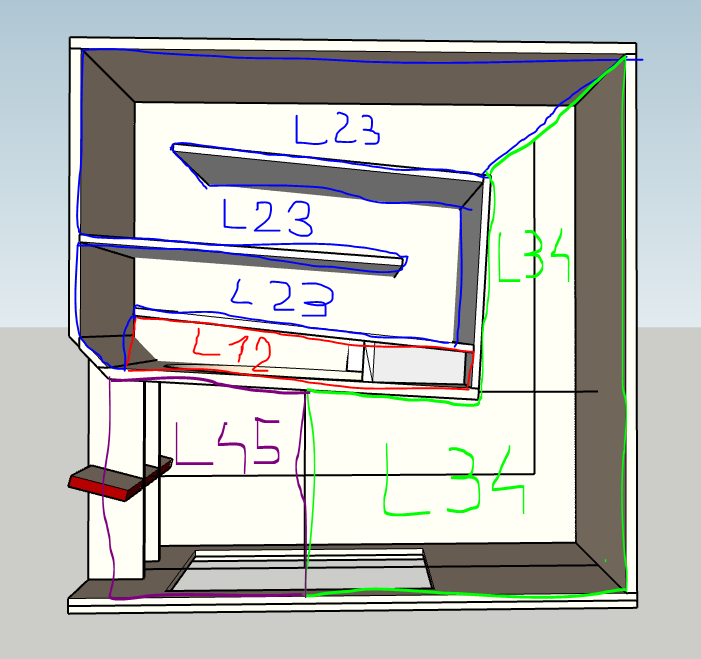

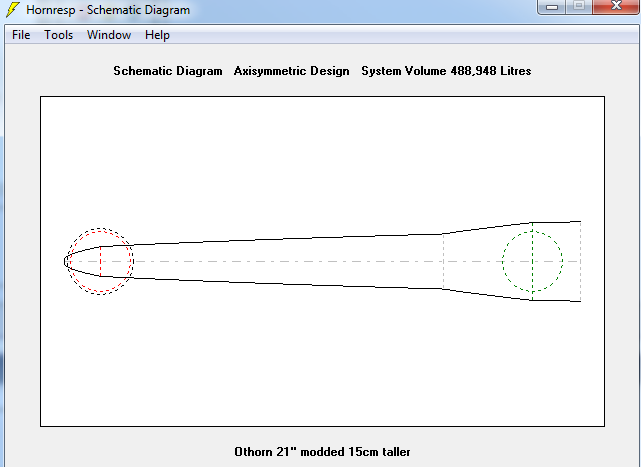

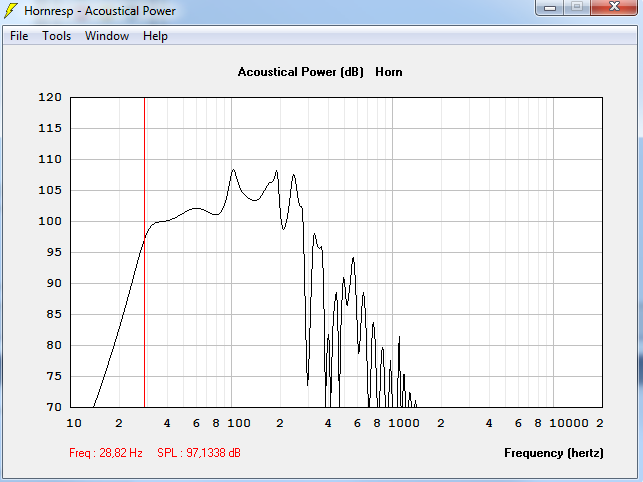

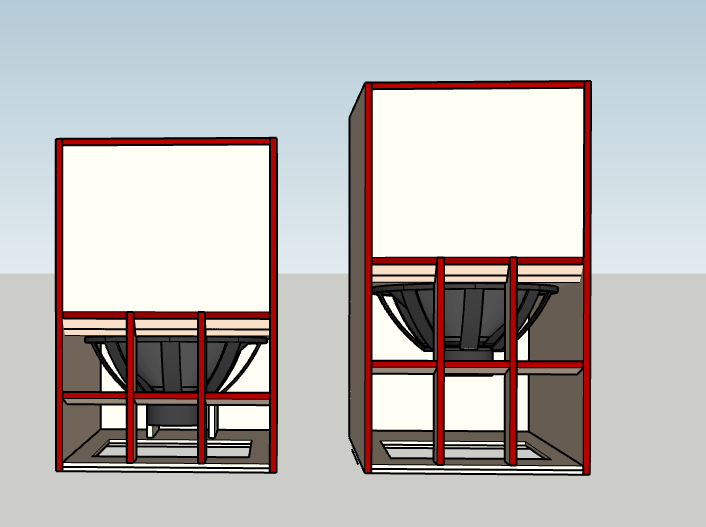

Alright, tell me if I did this right :
First I took the Ricci input datas and I edited those to match the attached picture(did that drawing fast sorry), it simmed exactly as the previous datas
From my sketchup file of the Othorn, I added 15 cm of height and then measured the area of S4 and S5 and added 7.5cm at L43.
Which resulted in : Taking too much space and can't find an option to do a "spoiler", watch the 3 last thumbnails
And looks like :
It will certainly need a stronger bracing than the original for the last "straigth" portion of the horn.
I want the Othorn to be 15cm higher to match the look I want to give to my system (Reggae-dub style), 91cm is a bit short otherwise.
And it looks less cubic as well ahah.
The T/S parameters comes from the B&C 21DS115-4ohm.
Thanks for taking a look 😀
