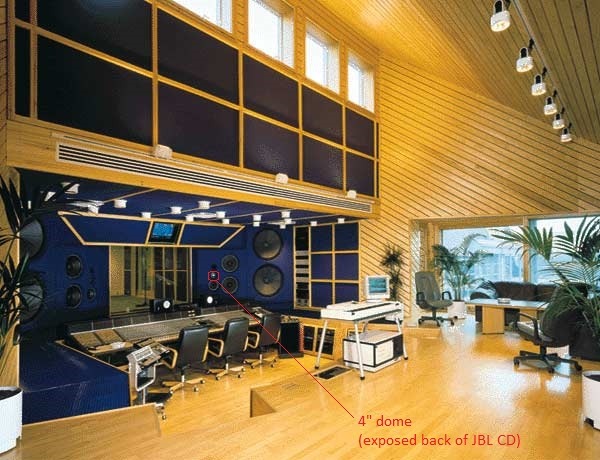

A reputable recording studio somewhere in Scandinavia once built a set of large soffit-mounted recording & mastering monitors with large-format JBL drivers used that way.
[EDIT]: It was PUK studios, in Denmark. You can see the 4" JBL domes (flipped compression drivers) in the picture, they are the seemingly tiny silver disks in that blue "wall of sound". For scale, the side sub-woofers are 80cm Fostex FW800 units (four of them in total!).

A bit more detail on the PUK studios monitoring system in this PDF.
"For the mid range we tried a lot of horns. They had to be very big which gave a lot of reflections and phase cancellation problems. Finally we decide not to use horns, but rather a large dome tweeter. A normal JBL loudspeaker has a 4 in dome tweeter with a titanium membrane which works very well."
That 4" dome was that of the JBL 2445J compression driver.
The design engineer also published an AES paper with even more detail.

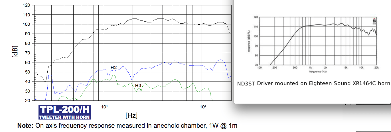

The Eighteen Sound ND3ST on the XR1464C horn has about 6dB less high frequency than the Beyma TPL200 pleated diaphragm driver/horn.Recently, testing a beyma tpl200 against a set of compression drivers, I came across a CD that to my ear seemed to sound better than the others. The 18 sound nd3st. To do the tests I used all the CD without a horn. Incredibly (or maybe not) with the horn (any horn tried) this driver could no longer sound better than the tpl200 as it did before. Although it sounded fuller in the lower part of the band of use, it lost something that I have a hard time explaining but that made it superior to the tpl.
Can anyone help me understand what is going on? How is it possible that a driver that is meant to be used in a horn sounds better without it?
The ND3ST without a horn likely has a rising high frequency response.
Such a large difference in on-axis frequency response alone ("something lost") could easily explain the "by ear" preference of you and your friends .

Try the same A/B test with the response equalized to the same target and you may also find your preference shifts.
