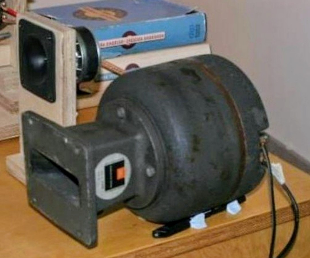

I remembered way back as a 3 way I tried this..
Was just a plonk down.
JBL adapters probably didn't do much for the effect?
Pre refurb too.

You can
If i remove the back, turn it around, and direct the dome to the listening position, then i can use it as a supertweeter from f ex 10K?
You can, assuming the driver has useful response that high.
The diaphragm surround ridge will cause some peaks in the response and diffraction, and the diameter of the diaphragm will determine the dispersion, it will "beam" above the wavelength of the diameter.
You would want to put felt or some other type of damping material in the back and cover the throat with it, unless you wanted to hear radiation from both sides.
For a 1.75" diaphragm diameter, around 100-102 dB at 1000 Hz at 1 meter would be the excursion limit (under .5 mm Xmax/Xmech is typical), which may be under one watt.
At 10kHz the power rating of the driver will be fairly accurate.
