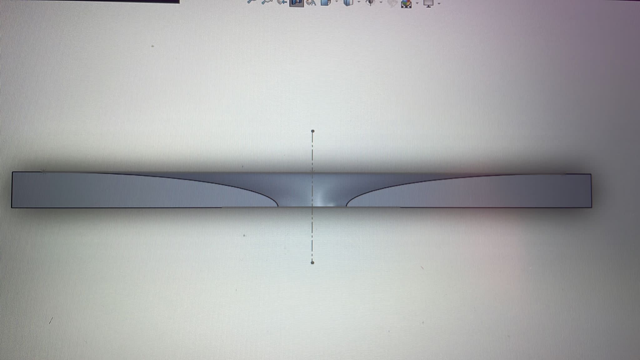

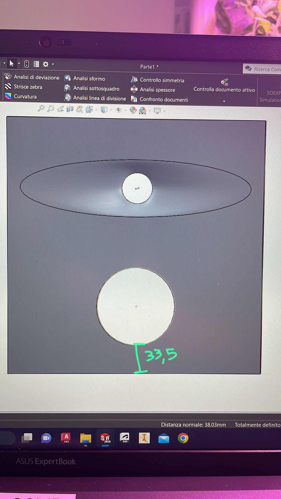

I have a shorter horn with a wider dispersion on the way: https://www.eighteensound.it/en/products/horn/1-4/0/XR1496C indeed with a 1000hz crossover I don't need to have the loading of the horn I tried now. Also as a Solomonic middle ground I also want to try to test this system by putting the driver in a horn with a very wide dispersion(140°x80°) but very shallow, I attach pictures of the elliptical profile horn I designed. Nothing particularly sophisticated-I used celestion's horn wizard and then brought it back in 3D. I just hope to find a CNC shop that won't charge me a fortune to make it! As soon as I have some new evidence I will send you the video to hear your opinions.

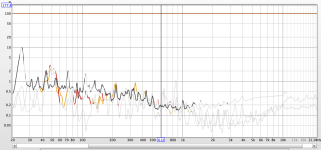

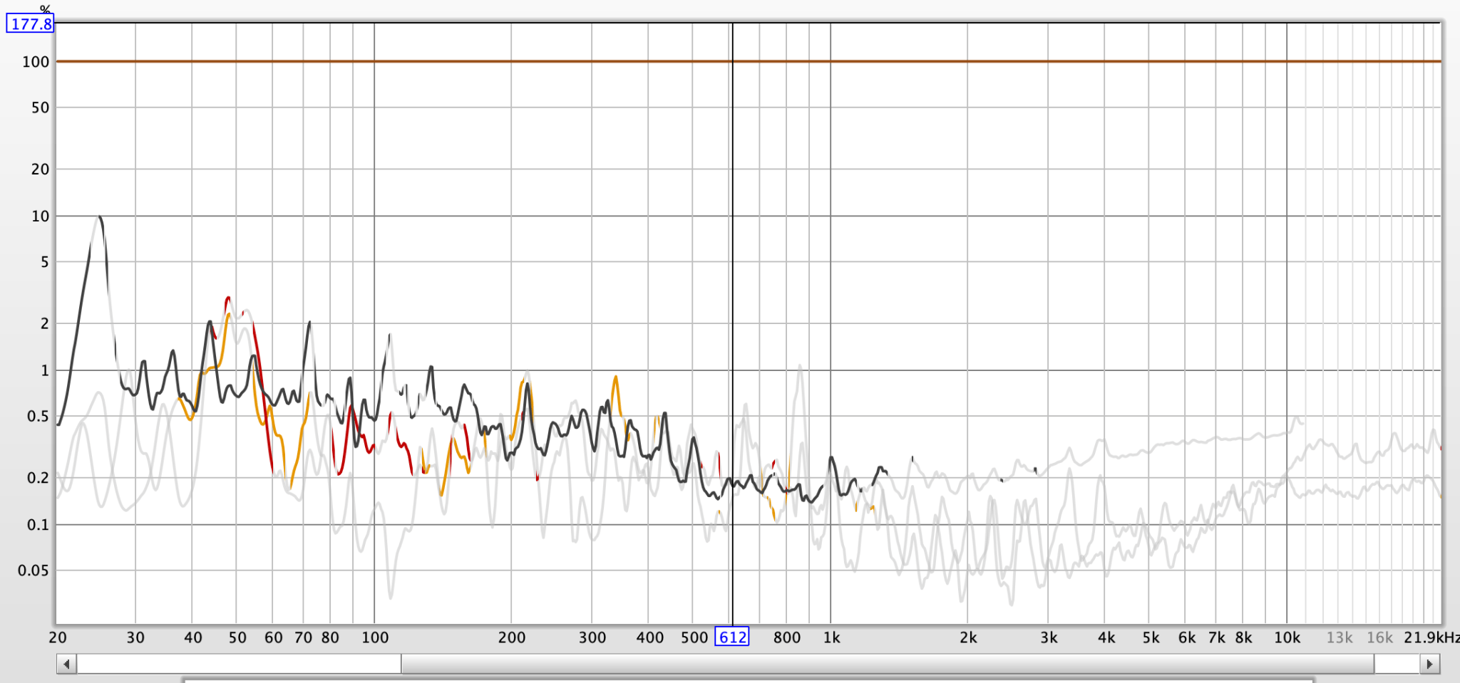

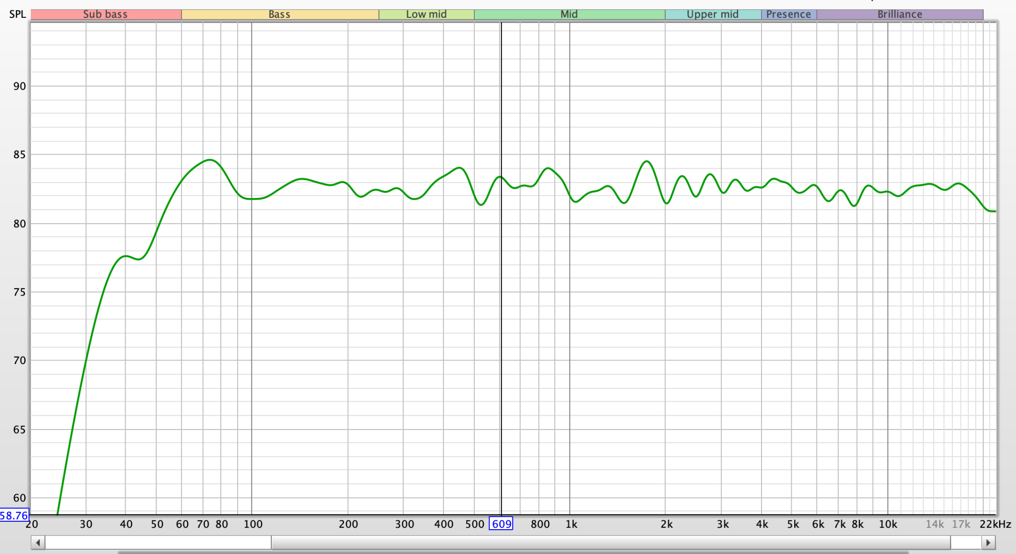

Here the response and the distortion of the hornless system. Note that at 2 meter in a very reflecting room especially the THD measurement is biased toward higher THD levels. Nonetheless the THD is under 1% from 150 to 20000hz: the driver is not under particular stress.
