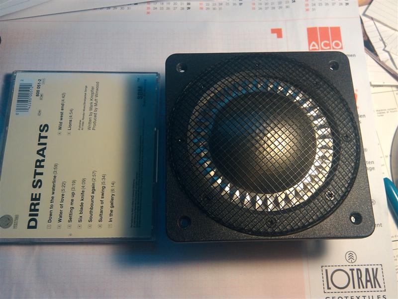

i have demonstration of the opposite.
Sensitity is the highest i tested so far, the bandwith is surprisingly wide and the radiation is the big bonus of the hornless.
You're 0 out of 3
I'm not seeing it ?!
Can you post the chart of the sensitivity, and a chart of the angular dispersion?

Why did you use a PB950 with Beryllium diaphragm ? does it make a difference up to 3,5khz ? I don't remember if i tested it without horns, but with horns there was always coloration.
No reason other than i had them.
I'm planning to use the standard aluminum version, but i'll compare side to side before making the decision.
I wonder, though, if their ability to perform so well crossed so low -and hornless- has something to do with the Truextent diaphragm's suspension, which is to my understanding not exactly the same as the standard one from Radian.

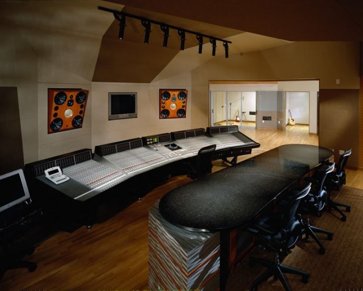

I forgot about this one: Quested HM412 and HM415 main monitors used to use a Community Sound compression driver for the low-mid (the big white domes in the photo). The pair below were at Patchwerk Studios, in Atlanta:
These are still made, but are using a more conventional cone driver these days. the "HM" in model designation stands for "Hooligan Monitor". They are for facilities that demand stupid high output from their monitors. (No doubt contributing to the hearing loss of any engineers who regularly used them at those levels.) 😡
