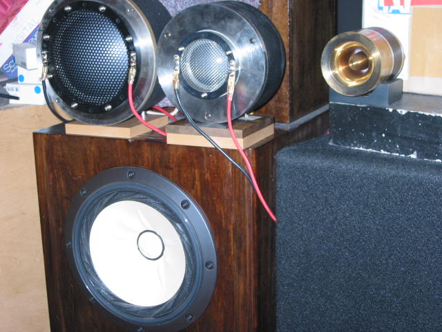

Here is a Japanese DIY'er using naked CDs with back cover removed:
ƒhƒ‰ƒCƒo�[

Hi Guys, I am the designer of the Model 16 loudspeaker system.
The question has been raised about our choice to use a compression driver without a horn. Well, firstly it must be realized that, as Wayne rightly states, a horn is a device that directs acoustic energy.
Yes, basically the horn function is to direct, to concentrate acoustic energy. As little waste as possible on the sides, on the floor and on the ceiling (if any! ...outdoor PA, eh...)
But what if... What if i'd like some ''waste'' on my room's walls, floor and ceiling ? What if that helps achieve a more immersive audio experience ?
Now, if we start to bend the walls of this baffle forwards into a horn, the magnitude of the loading increases. So now we can see a simple relationship forming, the longer the horn walls the lower the frequency the loading will be maintained to, and the tighter the angle the greater the "severity" of that loading. Now, just to make things a little more interesting, the tighter the angle the more the horn resembles a pipe, and of course pipes have resonances at discrete frequencies, and so it occurs that these resonances also "load" the driver and there will be specific centre-frequencies of peak loading. Once you understand all this you realize that short horns will provide very little loading below what will inevitably be a fairly high cut off frequency.
The higher the frequency, the less a horn-loading is needed/effective. Therefore, the big challenge here is about 400hz-1khz or so. YES you lose potential output (efficiency and max SPL), but then again if it's for domestic Hi-Fi it's mostly irrelevant. Only the possible damage of the diaphragm is the real concern here. Especially if EQ is used.
Now, as a consequence of loading, the on-axis sensitivity of the loaded frequencies is increased, and this allows the possibility of electrical filtering or attenuation of those frequencies because now we may have a little extra acoustic energy to burn. Hence, in theory we can reduce the excursion requirements of the driver over the loaded frequencies, and hence the idea that loading ultimately helps to protect the driver.
Protection of the driver (diaphragm) seems to be the issue here, NOT the subjective qualities. As long as you get the undistorted SPL you need for a given bandwith, with directivity properties that suits your needs... What else matters ?
It is also true that the loading itself reduces driver excursion; the extent to which this happens is dependant on the magnitude of the loading.
In the case of the Model 16 however, it is first and foremost a domestic hifi speaker rather than a PA system or studio monitor and as such it was never intended to be foolproof under the wild dynamic demands of uncompressed live instruments common to those environments. When used sensibly in near-field domestic situations it is more than capable of providing satisfying SPL without exploring the maximum safe output levels of the compression driver.
Precisely my point, and it's a solid argument against what i see as the single worst downside of using an hornless-CD config in a domestic HiFi system (over-excursion potential, damage of the diaphragm, ...)
The TAD4001 driver is rated at 30W with the TAD recommended filtering and assumed horn loading. It has an efficiency within the meat of its pass-band of 110dB per watt at one metre. So even with a tiny current flowing through its coil this driver is capable of sufficient safe output for me. We chose the 4001 driver for its sonic presentation…its tone…its musicality. We wanted to design a system that delivers a particular musical message, rather than a system that will impress people who want explosions or faithful recreations of space shuttle launches. Having a pair of Model 16s facing you at 1.5m in a quiet lounge room is like driving a 400hp car around town…you don’t ever really use the full wack…well…at least I don’t with the type of program material I listen to.
