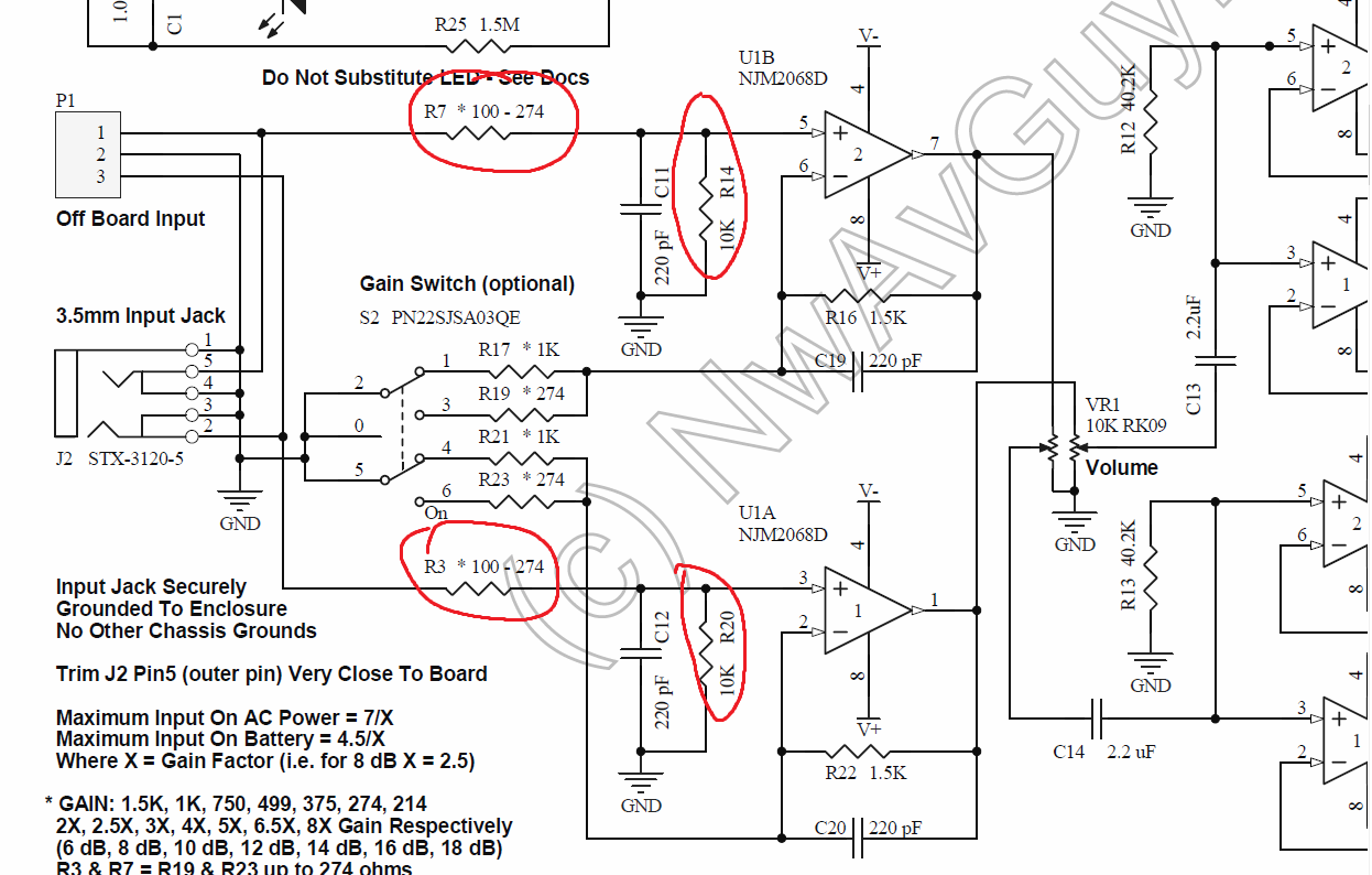

do i understand it right, that the input impedane of the O2 is solely determined by R14/R20 (10K) in parallel with the input impedance of the opamp(JRC2068)?
And that R14/R20 could also be used to compensate for DC-offset, but since there is no fixed gain, and the next stage is AC-coupled anyways it doesn't matter here right?
I'm asking because(other than learning more 🙂) i want a higher input impedance, so that the passive "meier enhanced bass crossfeed" which i integrated into the O2 works like the inventor intended it.
With 10K input impedance it's everything but "bass enhanced", and the crossfeed level and delay are off too, so i botched another JRC4556 as output buffer for the x-feed into my O2, which works great(after i actually added 47K resistors from the non-inverting inputs to ground - before there was a pop every time i switched - DC-offset related i guess).
Couldn't i just have replaced R14/R20 from 10k to like 100k and be done(with even better performance of the x-feed)?
If my assumptions considering input impedance are right, then why does the O2 only have 10K?
Less noise?
Wouldn't less load on the source outweigh this?

...do i understand it right, that the input impedane of the O2 is solely determined by R14/R20 (10K) in parallel with the input impedance of the opamp(JRC2068)?
I think you got it. The input impedance of an ideal opamp is infinite, but in the real world is actually more like 100K and up, depending. You can certainly increase that to any value you want by changing R14/R20. It will alter the dc offset of the opamp, but as you note it's AC coupled so it does not matter. I have read somewhere that the "standard" impedance for consumer stereo stuff is 20K, but I've not actually seen the standard. If it works for you, it's the right answer.
Pretty much as mlackey says although the intrinsic input impedance of the opamp doesn't really figure in the equation as its 'extremely high'. Hard to put a figure on it as it depends on the exact device and the feedback wrapped around it but typically you are looking at around 10 meg ohm.
If the output voltage of this meier stage is at nominally zero volts then you can direct couple that to the O2 input and remove R14 and R20 because the preceding stage will set the DC operating points of the 02 stage. If the output is not zero then you need to AC couple (0.22 or 0.47uf) and raise R14 and R20 to around 470k.
yea, that is a good idea to AC-couple the buffer opamp, because then i wouldn't need the bias resistors, and had only the input impedance of the opamp seen by the x-feed circuit(like i wrote, i left the bias resistors out at first, but didn't AC-couple then, so it produced pops whenever i switched the x-feed, and between xf-levels). 🙂
On the other hand, if i decided that 47K input impedance would be right for the x-feed, i could just change R14/R20 to 47K, and rip the buffer opamp out again.
