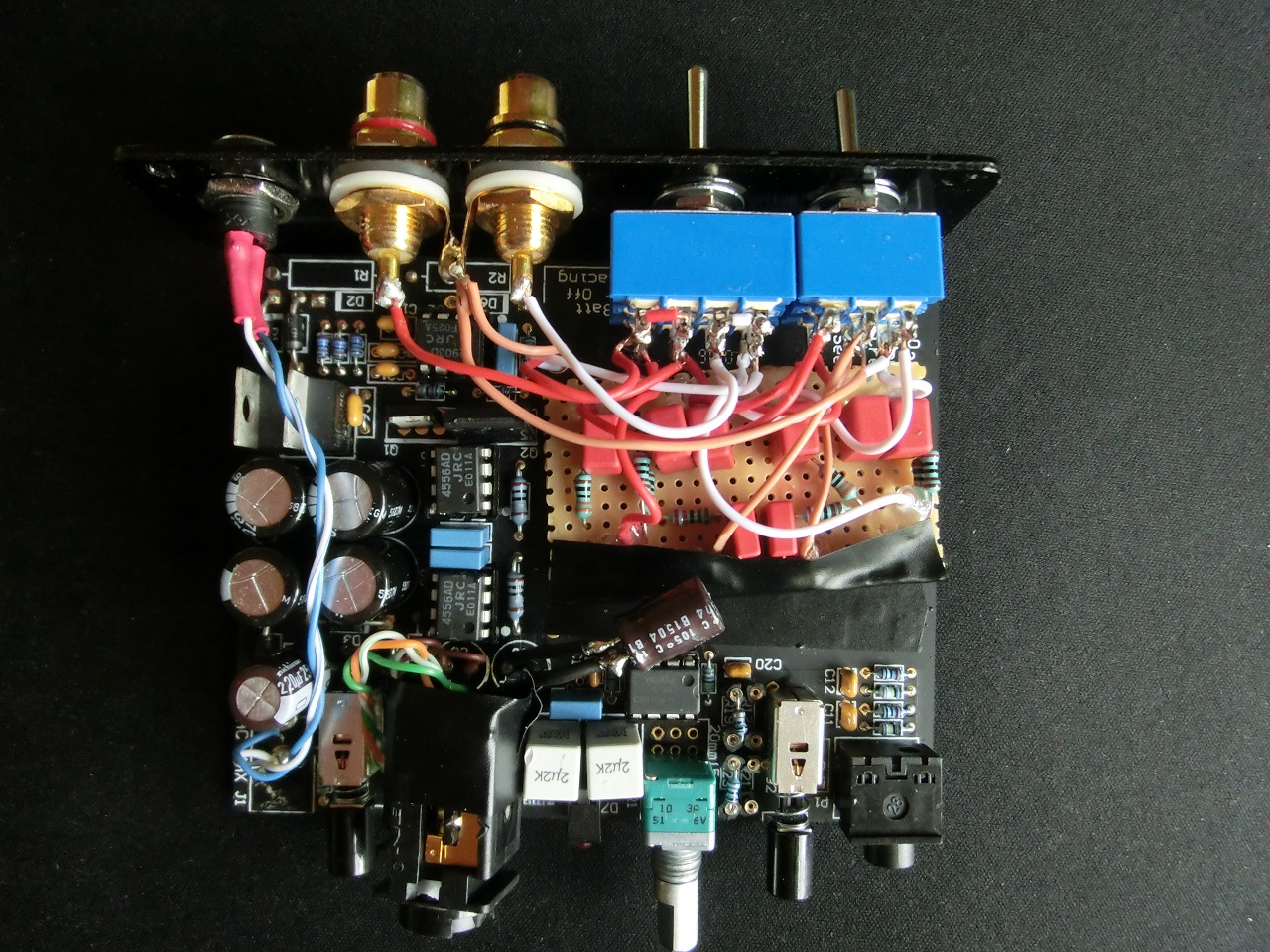

For when you see this tomorrow I have fixed the break in the trace and now have a nice positive voltage on pin 8 ,which is the same as the voltage on R8.
Pin 7 now have a voltage of plus 8.09V. Which seems better!

That great
So that's a definite fault fixed. Have you refitted the FET and tested it all again ?
Back from work and just re soldered the FET back on, I am letting it cool down before operating the amp.

Man I am my wits enf with this amp. Turned it all on and check the negative rails. All seemed good at -11.86.
But alas no sound came out when I plugged it into the computer.
Just got some static when twiddling the volume knob.
I think this could be down to a couple of problems. Either I killed the FET when removing and reinstalling or a broken trace.
I quick short between the negative rails on U1-4 confirmed the Amp + DAC was still working without static.
Let me have a quick tinker and see what I find.

Well its now working...
I turned it on with the negatives shorted together on all but U2 and then removed the shorts one a time to see which would make the amp go crazy.
None did.
Its now working with the only fault being it is extremely quiet.
With the gain button in and the volume right up its not even loud, I have to still strain my ears to hear it.
But this could be a windows fault. I will look into it.
Michael

Hmm I doubt this could be software related.
It really struggles to drive my 38 ohm headphones.
Could be a gain resistor is broken?
I might sleep on this problem

Fault finding always has to be logical.
Up until now we've been concentrating solely on a power supply problem. If all the opamps now have the correct supply voltages present then we can move on.
You need to confirm that first.
If the amp consistently works OK with a DAC or CD player but is much to quiet on your PC then it really does sound like a Windows setting somewhere. The O2 is configured to work with any normal line level output.
Its a fresh new day and a different perspective on this amp.
I forgot last night an easy test to see if it was an amp or windows issue was to try the 3.5mm jack input and see if it worked well.
Low and behold its rock solid.
So either a DAC problem (highly unlikely) or windows problem (very likely!).

Right 100% working now.
Notes for the future are: plug it into a rear panel USB port not a front USB and make sure windows isnt trying to do some funky audio effects.
