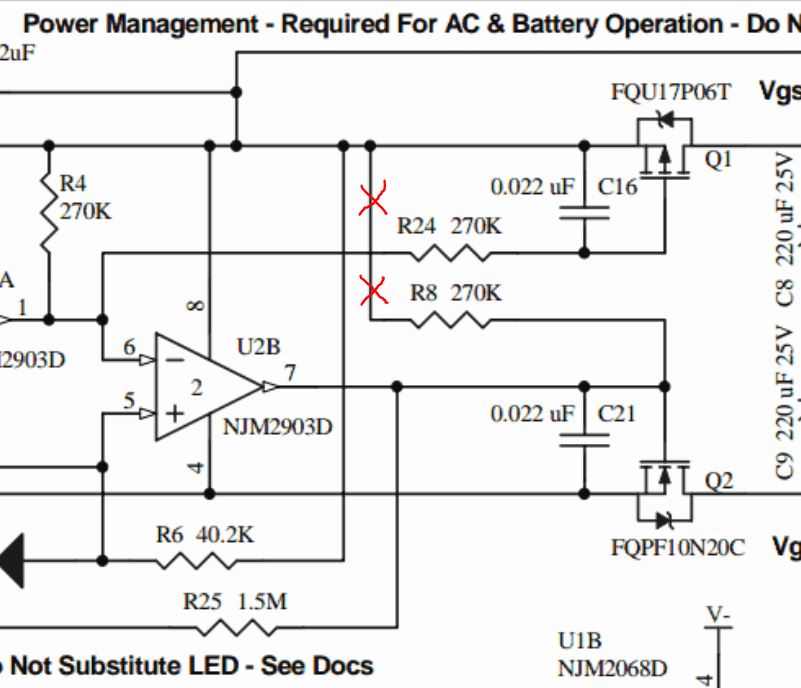

A quick measurement that is worth doing would be to measure between pins 5 and 6. Black lead on 6 and red lead on 5. The voltage should be a positive value which based on the earlier reading would be in the 1.5 volt range.

Hmmm. So that's +1.6 volts with pin 5 being the most positive (red lead on pin 5). IC's are usually super reliable so that is very odd.
What I would do is switch off and then check continuity from pin 7 on the chip itself (not the board, the pin on the chip) to the leg of 270k resistor R8. Then check continuity from the other side of R8 to the positive supply.
Another quick way... check the voltages are identical on R8 and pin 7, and R8 and positive rail. Beyond that and we need to confirm the 270k isn't open circuit. If all that is good then we are looking at the chip being faulty... but its never the chip 😉
It will help you understand what going on if you know how the comparator works.
The comparator has two inputs, one marked - and one +, just like an opamp. In fact opamps can be used as comparators.
If the plus input is more positive than the negative input by even a fraction of a volt then the output swings 'high'. If the plus input is lower (more negative than the negative input) by even a fraction of a volt then the output swings low. That difference between the inputs need only be a millivolt or so for the comparator to work.
The output of this type of comparator needs a 'pull up' resistor in order for it to have a 'high' output state. That's R8 in this circuit.

If you look at the circuit there has to be connectivity from R8 to pin 8 of U2.
R8 must have +12 volts present on that top end of it. Just recheck those two measurements. There must be continuity and there must be 12 volts present.

Q1...
That is the upper FET. There should be PLUS 12 volts on the 'source'. That's the left hand pin on the diagram. The gate (middle pin on the diagram) should be at MINUS 12 or so. Pulling the gate negative turns that FET on, so that is correct. In that state there should also be PLUS 12 volts on the right hand pin (the drain). The FET is on, it passes the 12 volts through to the rest of the circuit.
Does R8 have this MINUS 11 volts on both sides of it ???

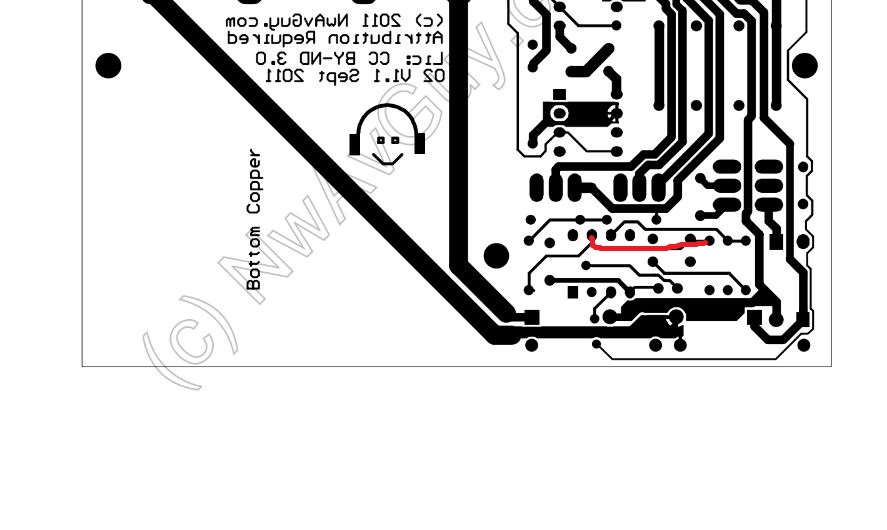

This looks to be the path.

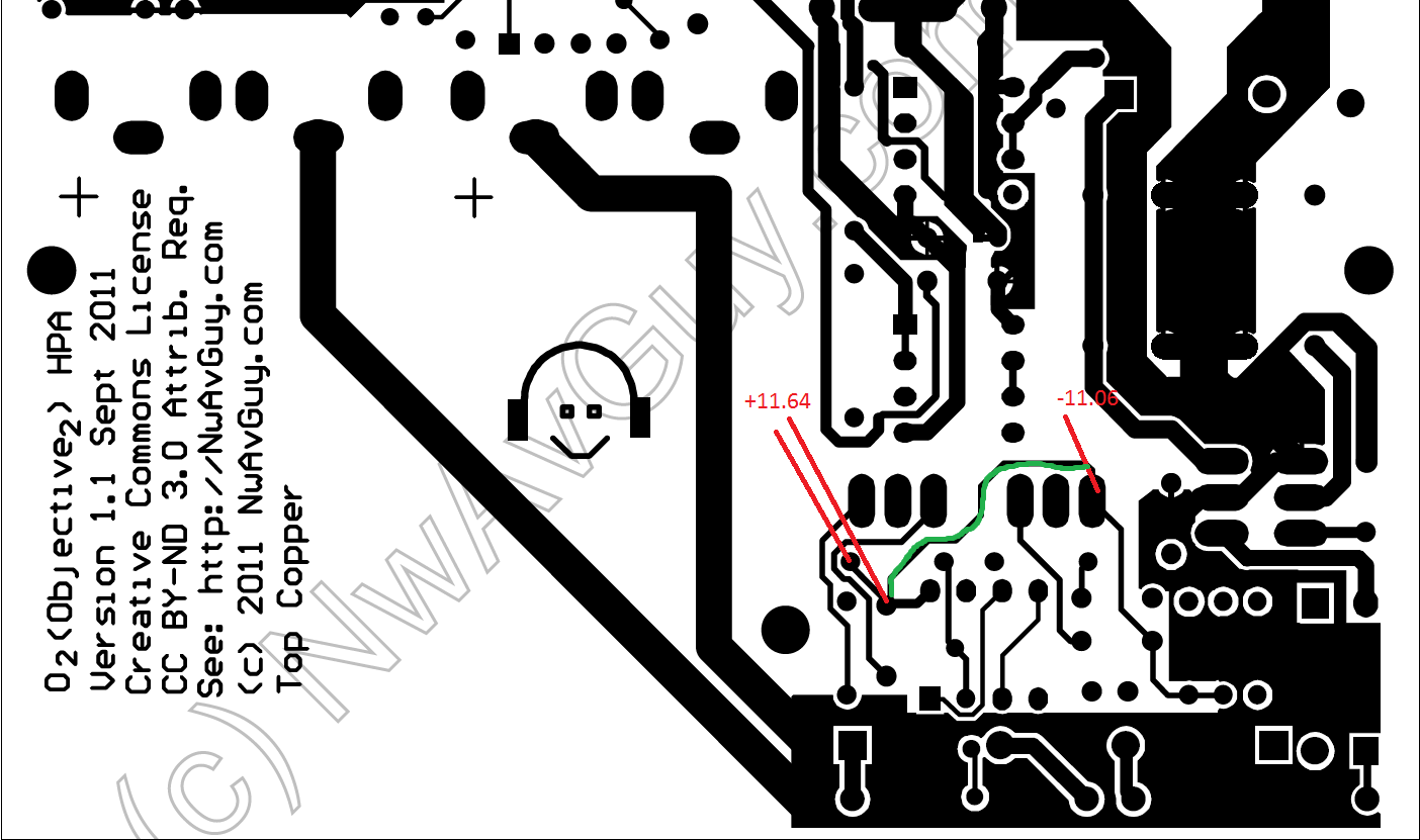

Hmm I really cant find the break, it might be hiding behind the silk screen or right on the solder pad.
I am pretty sure I know where the break is though. I have highlighted the trace in green.
I have also marked on the voltages at certain solder pads which indicate this trace to be the culprit.
Do you think it's worth breaking the trace at both ends and soldering on a wire as a replacement?
Those measurements seem to confirm the break. Just link those points with some wire, don't try and break the print any more because its doing no harm.
