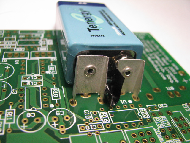

Sorry if this has been answered before, but the O2's female and male battery connectors are obsolete and not sold on digikey/mouser anymore. What are some good alternatives?
The alternates in his "notes" column work, Keystone 593 and Keystone 594 (Mouser #534-593 and #534-594).

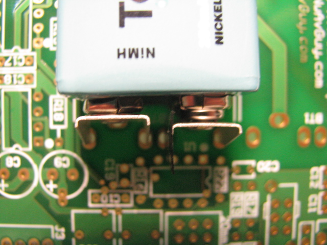

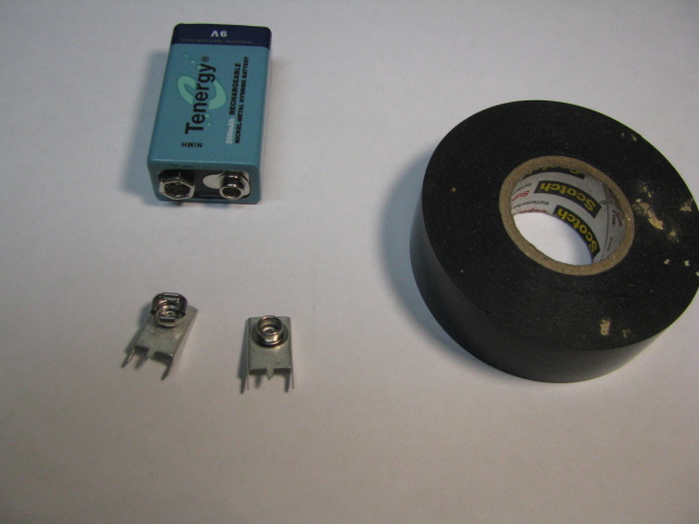

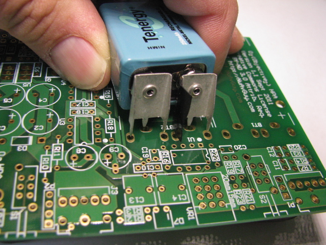

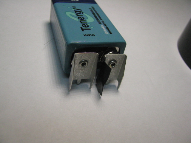

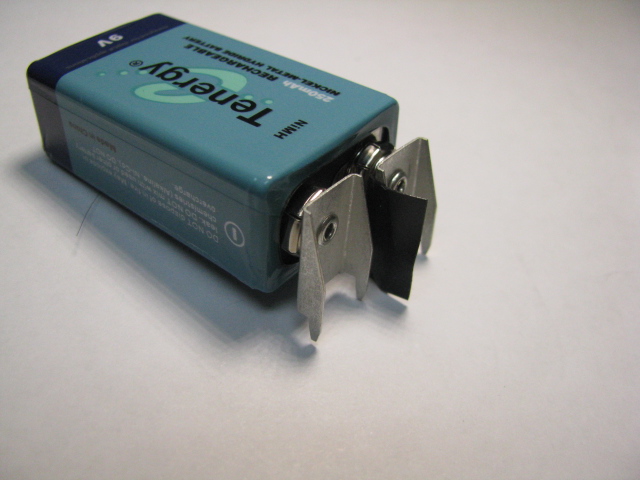

Also here a "pro-tip" on soldering in the battery connectors. 🙂 With the O2 power switch off, snap the terminals onto the battery first, then carefully put the terminal PC pins into the PCB holes. Putting a small piece of electrical tape on the inner edge of one terminal first is a good idea so it can't accidentally rotate and short out the battery against the other terminal before putting them in the holes. Then solder just the center and outer pins on each terminal, making sure the battery is still lined up straight with the PCB markings when you flip the board to solder the pins. Then remove the batteries and solder up the inner pins (the inner pins are a little too close together to risk soldering with the battery attached).
The problem this solves is that one battery terminal has to mount just slightly forward of the other the way 9V battery terminals are constructed. It is nearly impossible to get that right unless the battery is attached.
Alright, appreciate the help. Just want on a little bit clarification on "Putting a small piece of electrical tape on the inner edge of one terminal". I'm not sure I understand.
A picture is worth a thousand words, as they say. 🙂
In that last photo the difference in the amount forward between the two terminals really shows up. From the photo is looks like the battery just isn't pushed in all the way, but it is. The terminals in the photos are the Keystone terminals.
