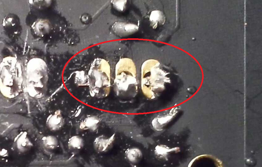

Hello all, I am having problems building my o2 amp. It does not output any sound when turned on. When adjusting the potentiometer, there is a scratchy sound in the right side of my headphones. It is not the headphones, because They work fine on my souce. One of the capacitors was missing from my kit, so I bought another on of the same type, but it is not identical. I have a feeling that it is the solder joints; but I am not sure. Sorry for the low quality pictures.
Congratulations on getting your feet wet with soldering. 🙂 It gets better the more joints you do and experience builds up.
Here is a place to start. Those pads in the circle are one of the power management mosfets and they have little or no solder. If the mosfets don't come on the O2 won't work. These 3 pads should look a lot more like your other 3 mosfet pads to the left after soldering.
What type of solder are you using (brand, diameter, and what composition does it say like 60/40)? I'm guessing it is fairly large diameter. You have a lot more solder on the pads than you really need. It is easy for that to happen when using really large diameter solder. You would probably have better luck with thinner solder.

I am using Draper flux core solder. It doesn't say the diameter or composition, but it is fairly large, and it is probably 60/40.Congratulations on getting your feet wet with soldering. 🙂 It gets better the more joints you do and experience builds up.
Good deal, that will work fine. It is probably the 1.2mm = 0.050 inch diameter I see on the internet. If you should solder up another project some day give "eutectic" solder with a 63/37 composition and something like a 0.6mm or smaller diameter a try. You will get better looking joints that will be a bit more mechanically stable.
So a suggestion... try removing some of the flux on the back of the board using isopropyl alcohol and a bunch of cotton swabs, if you haven't already. it will come off as brown stuff on the swabs. Then take a close look at all the joints using a magnifying glass. It is really hard to see solder bridges between the pins on the mosfets, voltage regulators, switches and pot without a magnifier. Any joints like the ones above just re-heat them for another second or two and add more solder so that it covers the whole PC board pad.
If it still doesn't work, post back. Mooly has been a wizard on helping folks get their O2's debugged! 🙂

It still doesn't work. One of the opamps broke, so I got a new one, and I thought that might be the problem, since it was damaged earlier; however, it still doesn't work and when I tested it some smoke came out so I think I will try again on a new board or buy one.

I have just now, and it seems like it is a problem with the power regulators (it fails the first part), and I'm not sure if I can even de solder those or get replacements. Thanks for the help.
