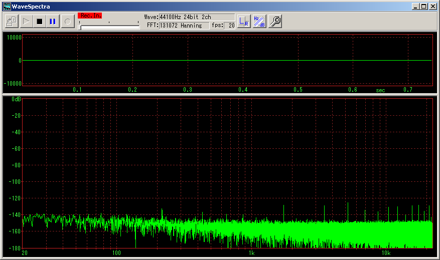

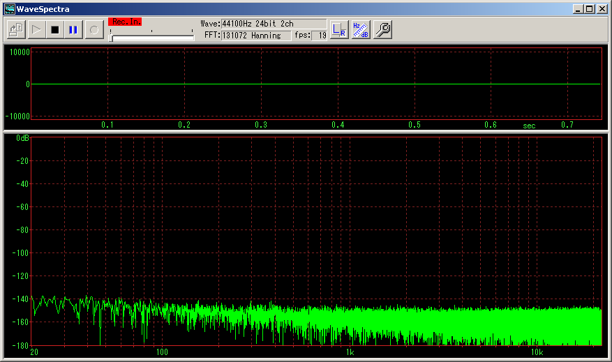

So I have been curious to try 3x LME49720HA (the metal can versions) in my official O2 build and it's picking RFI like mad.
But when I use 3x LME49720HA (DIP package) instead, there's no RFI.
Shouldn't the TO-99 be better than DIP package?
How can one make TO-99 opamps don't pick RFI at all?
Just my 2 cents...
Just my 2 cents...
Have you scoped the opamp outputs to see what is going on ? It may be unstable.
Well it probably is in some way unstable, but if it's only the TO-99 package causing it, that's a mystery to me. No soldering of TO-99 to some adapter either, it is directly put with its pin legs to O2's DIP sockets... But no problems with DIP package of this same opamp here - no cellphone clicks, beeps, buzzing, modulating noise, etc...
I wish I had some Audio Precision/dScope 😀, because all I can measure right now is higher noise floor with some harmonics than the noise floor of my RME A/D converter - however with LME49720MA DIP package the noise floor blurs with the RME A/D converter's noise floor...
Do TO-99 opamps require some special care in this particular O2 design?
This is just for curiosity sake, if this doesn't get solved I'll stick again to my favorite opamp 🙂
PS: I have also successfully tried NE5532, NE5534, LME49990 (all in plastic packaging) and they don't exhibit this behavior...
