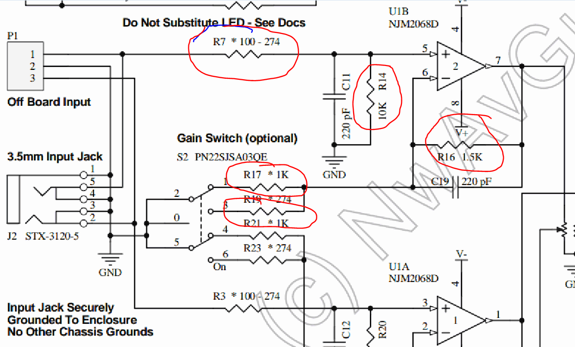

Just completed my O2 build and need some help. My issue is that amp works but is quieter than it should be. Both channels are the same. For example with my headphones plugged straight into my cell phone I start playing music at a normal level. I then plug the headphones into the amp, connect the cell phone to the amp, set gain to low (2.5x) and turn the amp's volume all the way up. In theory the headphones should be getting 2.5x the power right? Instead the music is quieter than directly connected to the cell phone. Max volume on the O2 is reducing the volume compared to directly connecting. Same thing on various sources. Setting high gain raises the volume but it is still much quieter than it should be.
I ran through all the tests on the blog and everything was normal except that pin 2 on U2 is -8.9v instead of -8.4v. This is with only U2 installed, no batteries, and power turned on. Is that a clue?

Gain is determined solely by the feedback components, and its voltage gain, not power gain 🙂
So looking at one channel, R16 and either R17 or R19 (depending which is selected) determine the voltage gain. Check the value of those parts. Switching between R17 and R19 should make a big difference to the volume. Does it ?

OK, lets do a test that will prove beyond doubt (ha 😉) what is happening. I assume you haven't got any test gear beyond a DVM, so here is what we do... and this is uncharted territory on the 02. (And unplug the headphones for doing this)
Its not complicated, and it takes longer to read this than to do the test 🙂
As both channels are the same you need only do this on one channel. Also, there won't be a problem with U1, opamps don't give faults like low or wrong gain 🙂 But we'll try and prove it all.
Look at the diagram here. Its vital that I know what the value is of the resistors marked (not exactly, just whether they are correctly identified and fitted). Now you can not measure resistors accurately in circuit because of interactions with other components. So go off the colour code and confirm that they agree with the circuit.
As written, the circuit implies that R7 is either 100 or 274 ohms and R14 is a 10k.
The feedback network that determines the gain is R16 (a 1.5k) and whichever resistor (either R17 or R19) is switched into circuit. According to the circuit that is either a 1k or a 274 ohm.
Now we can test the gain by applying a known voltage to the input and that voltage can be DC. So if you take a 1.5 volt battery and connect the negative terminal to ground and the positive terminal to the input (that's pin 1 of P1) and measure the DC voltage at the opamp output (that's pin 7) we can see if the stage is amplifying correctly.
Lets assume R17 (a 1k) is switched into circuit. The gain is equal to (R16+R17)/R17. So that is (1500 +1000) divided by 1000 which is 2.5
(so that is why its important to know the values of the resistors)
So if you apply 1.5 volts to the input you should see 3.75 volts on pin 7. If you measure the input voltage when the battery is connected and do the calculation it should be almost exact. So if you measure 1.56 volts on the input, you should see 3.9 volts on the opamp output.
If you now switch the other resistor in (lets say its the 274 ohm as drawn) then you would see 6.47 volts on the output pin (assuming the input was say 1.56 volts).
If you reverse the battery polarity then the opamp output will reverse to, and become a negative voltage.
That tests the first stage.
The second stage (U3) is just a buffer but we can test that too. If you link out C13 the stage is then DC coupled. If you turn the volume up to full and measure the voltage at the headphone output (you can measure on R10 or R11 for ease) then you should see a voltage that is the same as in the above tests. Turning the volume down should reduce that voltage smoothly to zero.
Testing that way proves beyond doubt that the gain is/isn't correct.
