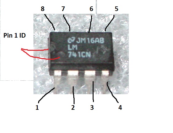

Its easier to follow if you can quote pin numbers and voltages 🙂 All 8 legged IC's follow the same pattern as shown in the picture.
So with your meter (black lead) on ground, what is the voltage on,
Pin 8. It should be around 11 to 12 volts.
Pin 4. It should be around minus 11 to 12 volts.
They are the supplies to the opamp.
Now record the voltages on the other pins and report back with the results.
Pin 1 = ?
Pin 2 = ?
Pin 3 = ?
Pin 5 = ?
Pin 6 = ?
Pin 7 = ?
Report your readings and we'll see whats what.
Sorry... I didn't attach the image. The odd one out is normally pin 1 on a PCB layout.

Your main problem is pin 8. That is the positive supply to the chip and should be at +12 volts. The positive rail is missing and is why everything appears to be a negative voltage. Look at the circuit and it will make sense.
You need to backtrack and check the voltage firstly at the 7812 input which should be 15volts or more for the reg to work. The voltage on pin 3 (output) should be +12 volts. That voltage should also be present on both sides of D1. From there it goes via the switch to the main circuitry.
Just do those checks carefully 🙂
