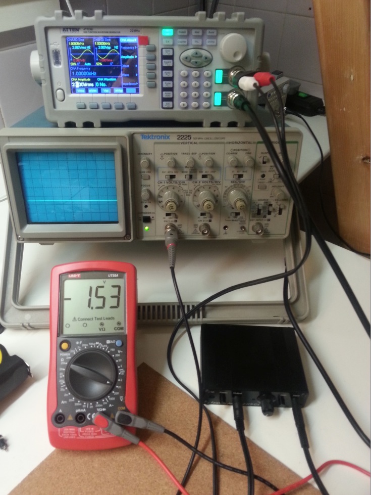

I noticed something strange while testing my O2. With the amp switched off, putting a sine wave on the input produces a DC voltage at the output. The DC increases in proportion with the input voltage. Using a 1KHz 2.5Vp-p sine wave produces -1.53VDC with around 500 ohms output impedance. The strange thing is, this happens even with the volume at minimum.
Anyone got any clue what's going on here? Seems very strange that it's doing this with no power and volume at minimum.
Edit: It's also worst in high gain mode (5X). Low gain (1X) gives around -0.9V.
Atilla ran into that problem in Feb of last year, post #2012 in this thread. There are some more details in the posts after that one. I don't think the cause and resolution were ever found. My best guess was something in the NJM2068 chip was rectifying the incoming signal, even with no power to the chip, then sending that back out the power pins where C8 and C9 then charged up to some DC voltage, partially powering on the output NJM4556A chips.
With the power to the O2 off the mosfets would be off, which would cut that output power rail segment off from the power managment circuit and voltage regulators (load), leaving C8 and C9 as the defacto power rail filter caps for the resulting isolated power rail segment past the mosfets.
You have a good test setup there! I would be curious what the voltages at pin 4 and 8 (power pins) to ground are on the NJM2068 when it happens. Even better, it would be interesting to see a waveform to ground on those pins. I wouldn't be surprised if it is rectified 1kHz, being smoothed then by C8 and C9. Might also just be a single ended voltage being produced, with the v- pin as essentially ground and the rectified 1Khz coming out the V+ pin, or vice versa.

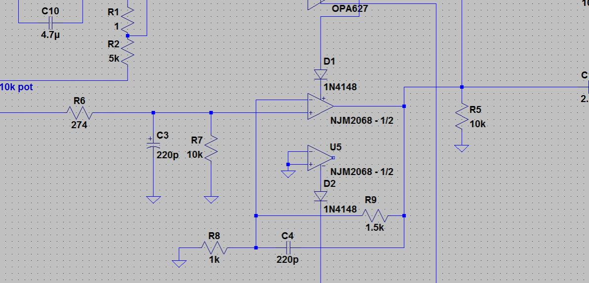

weslito - putting 1N4148 diodes on the NJM2068 power pins as below might be one fix if that turns out to be the problem. The diodes would block current from flowing in the reverse direction when the power rails are off. I picked silicon 1N4148's here instead of Schottky's since the reverse current leak is so much great with the Schottky's.
Just bending the power pins up on a sacraficial NJM2068 and tack soldering diodes to them would be a way to test it without having to cut any traces. Then the free ends of the diode lead stuff back down into the IC socket holes. I forgot that was how I tested the NJM4556 feedback resistor mod. 🙂
wiinippongamer also just let me know that a fix I came up with in January for power management turn-off transients he was getting while on batteries has worked after 6 weeks of testing. Just a 10K resistor soldered across the power rails at C8 and C9 to put a small load on that post-mosfet segment once the mosfets cut off. The 10K acts as a bleed resistor for those caps.
The theory was that the NJM4556A and NJM2068 chips are only specified down to about 2.5Vdc, so anything below that as the rails bleed down is kind of no man's land. I was thinking the chips may cut off their power draw hard below 2.5Vdc and leave the rails charged, without a bleed resistor, and that appears to be the case. Adding that 10K bleed load might also help with this problem.

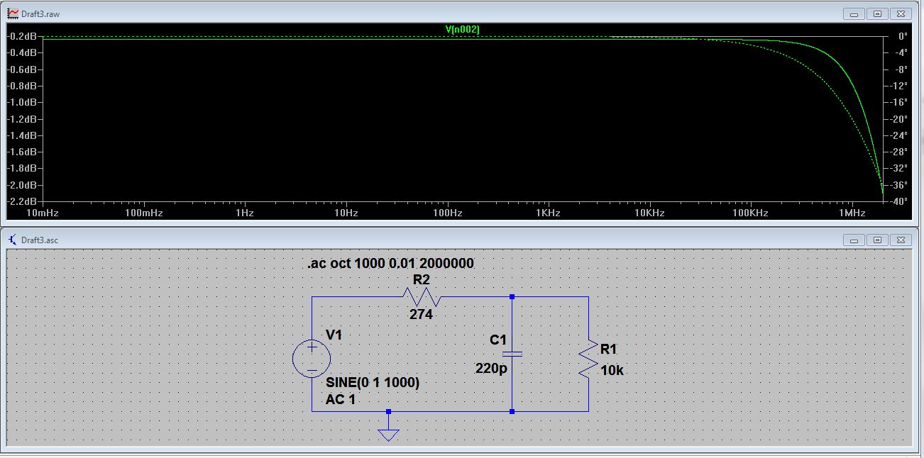

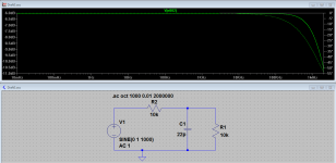

You have to create a voltage divider somehow.
The easiest way is to increase the values of R3 and R7, which form voltage dividers with R20 and R14, as described here:
http://www.diyaudio.com/forums/head...-crc-diode-cap-heatsink-mods.html#post2794079
I find that I need around 10K for 50% attenuation with my sources. When you increase those resistor values you have to correspondingly decrease the values of C11 and C12 to keep the corner frequency of the input RF filter the same, as the link describes.
Below is the AC sim plot of the O2 amp RF filter with the original values. The second plot is with R3 and R7 increased to 10k, for a 50/50 voltage divider, and C11 and 12 decreased to 22pF. The capacitors should be 50Vdc MLCC COG types with 2.5mm lead spacing, like Mouser part number 594-k220J15C0GF53L2.
Ideally it would be best to add a 10K resistor in series between the first op amp and the 10k pot, since the buffer stage following has 1x closed loop gain and won't increase the resistor noise. But that requires cutting PCB traces. The assumption here is that you are probably using 1x gain anyway in the first stage since you need attenuation, so even that won't matter. Easiest just to replace those two existing resistors and caps.
