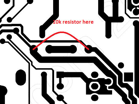

I get a huge "pop" noise when switch ON the amp..
Connecting a 10K resistor between the "+" of C8 and "-" of C9 helps to eliminate the turn-off thump. There is a chance it would help with turn-on thump too, although I haven't tested it. If you want to experiment just connect a 1/8W or larger 10K resistor between the two points in the diagram below. Please post the results if you try it!
The resistor helps with turn-off thump because the only load after the mosfets that RocketScientist / NwAvGuy had connected is the ICs U1, U3, and U4. The ICs are not exactly a linear load and are unrated as to what happens below 2V. The resistor gives the mosfets a direct linear load which may improve switching time and help the power rails come up and go down in syncronization. The "thump" happens when one mosfet switches a fraction of a second before or after the other rather than at exactly the same time, and/or when one power supply rail comes up or drops faster than the other.
