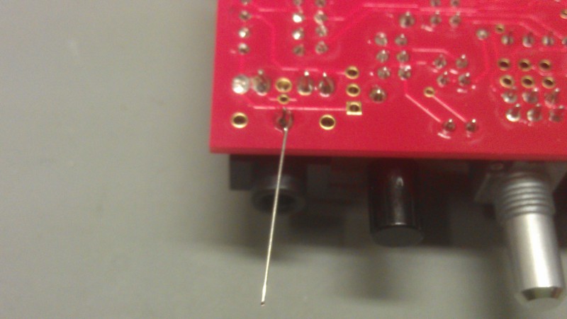

grounding PCB to case How To...
As promised, some pictures taken last night, was a bit late already and had to get up early so posting them only today. Description in order to the pics attached
1 - solder a left over lead from one of the 1/8W resistors to the ground pin of the input jack
2 - scrap of the anodized material - or better use a dremel - around the lower right front screw hole
3 - bend the wire around the hole
4 - step 3 works best like this 😉
now screw your front panel on and you are good to go.
