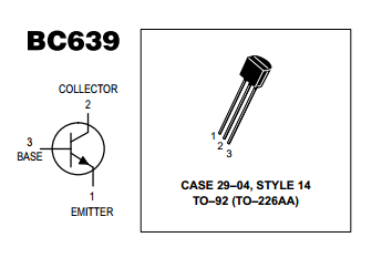

For the relay to turn on, Q1 BC639 turns on and its collector goes almost to ground potential, thus pulling terminal A of the relay almost to ground potential (say ~0.3V). Terminal C is at the same potential as the power supply to the protection circuit, nominally +24V (could vary a lot depending on trafo voltages, R14, etc.). Hence current flows into terminal C of the relay, through the relay coil, out of terminal A, into collector of Q1, through Q1, and out of the emitter of Q1 to ground.

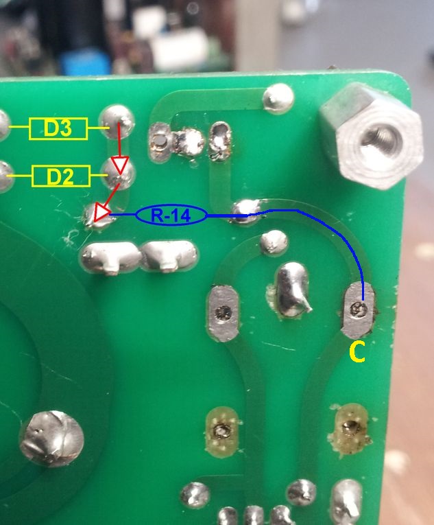

Great - can you also describe the function of D2 & D3? Is everything coming off the diodes (DR1-2-3-4) converted from +/- 35 VDC to +24V by D2 & D3 and passed through R14 to terminal C of the relay?
Or is all the voltage reduction simply the function of R14?
D2 & D3 are a full-wave rectifier that generate a rectified signal with a peak value of about 35V. That's filtered by R14/C14 to give a DC supply for the protection circuit with a small ripple. R14 also serves to limit the current through the relay coil when it's pulled on - the peak value is about (35V/(relay coil DC resistance + R14)) - it cannot exceed about 200 mA even if the relay coil is shorted out, and in normal operation with a good coil it will be significantly lower than that.

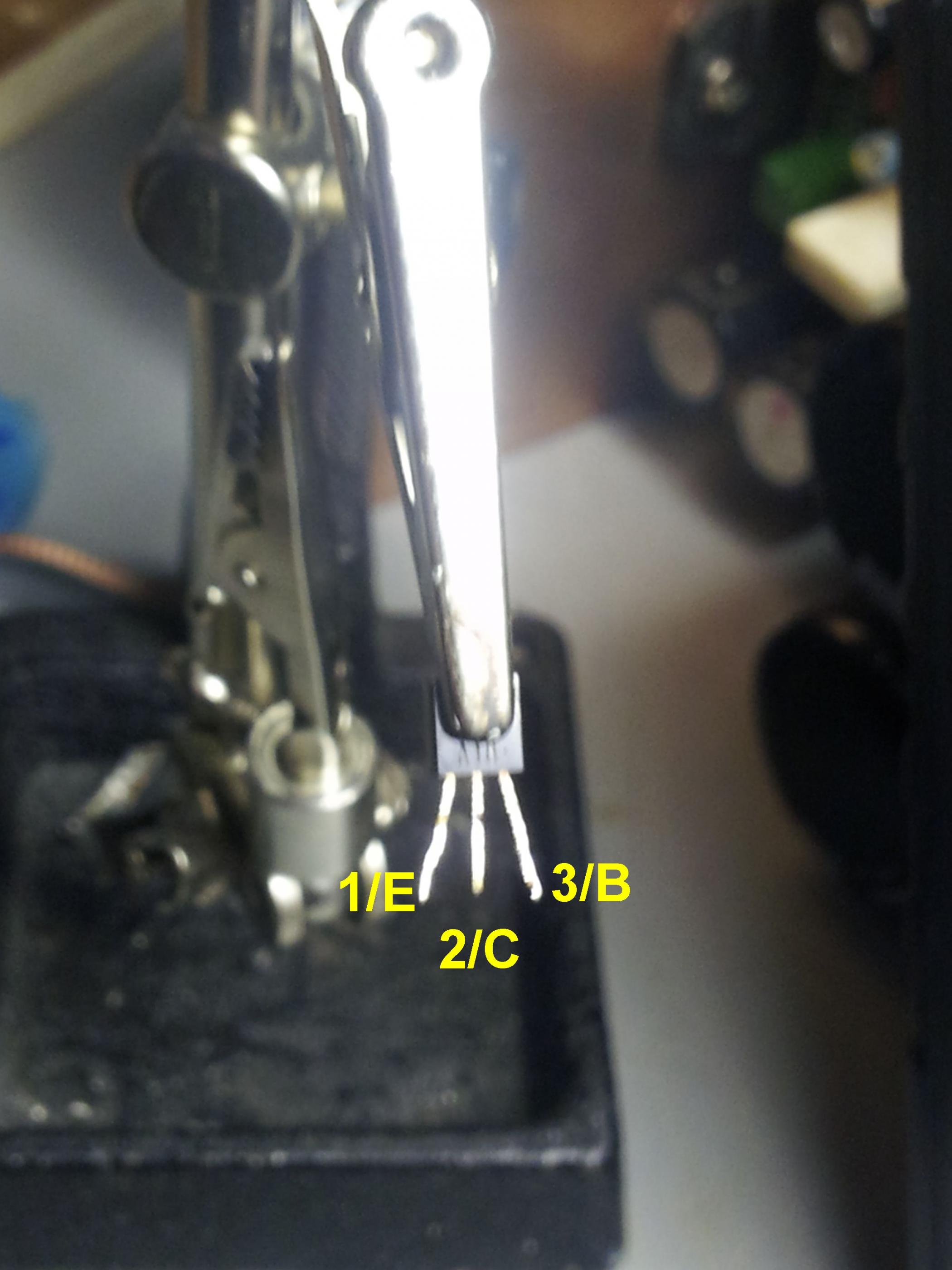

Regarding Q1, the B-C and the B-E junctions should show forward-biased diode conductivity with a DMM - something like 400 to 600 ohms in the 2k range. Check each junction with DMM leads (red & black) in both directions.

Both BC639s allow proper operation on the good module.
Neither allows proper operation on the bad module.

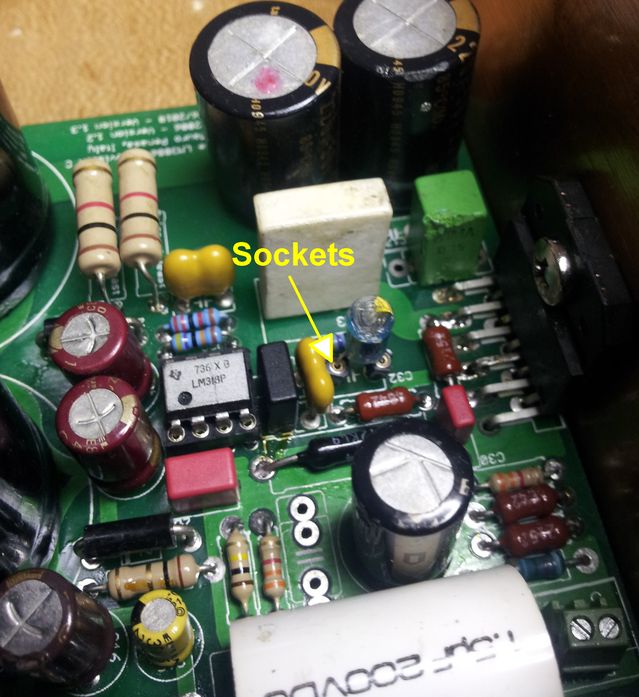

C32 is the only place where sockets remain. I replaced those and also confirmed both of those specialty caps work in the good module. The good module activates the relay - and lights the LED even without C32 populated.

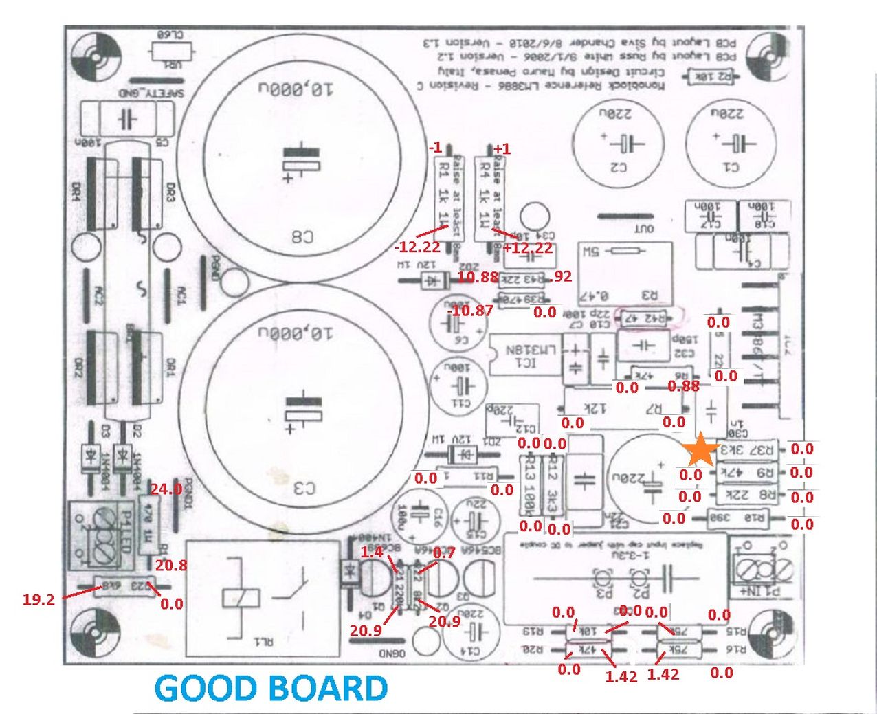

I looked for the following information but couldn't find a reference. Can someone supply the correct voltages on these two components? Also please confirm that all those readings can be taken with the negative probe at PGND. I'm always a bit concerned about using the wrong ground reference - signal vs. power.😱
If I can not confirm correct voltages on those two components the last step is getting and new board. That feel like ignominious defeat :cuss: -- but I'm out of ideas. :scratch: 😕

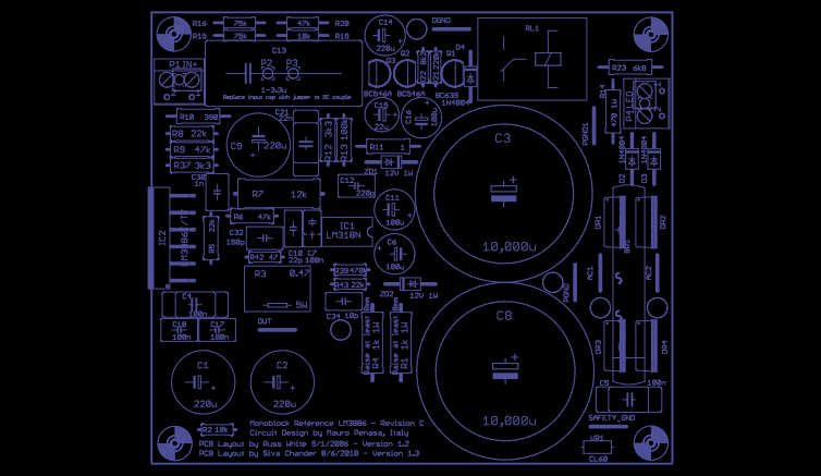

EDIT: The only thing mentioned that I haven't done is comparative readings on all the resistors. Siva, do you have a silkscreen of the top of the V1.3? It would make that step much easier to do and to post the results.

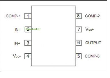

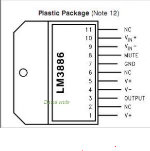

You have checked whether R11 is 1 ohm or open, right? Open R11 is the most common failure on these boards, usually due to some kind of grounding error or trafo connection error. None of the other resistors is likely to fail, in my experience.
Here's the image of the silkscreen layer of the V1.3 - it's a bit difficult to view since I pulled it straight off the gerber .plc file using gerbv - you can probably enlarge or convert to a .jpg to view it better as needed.

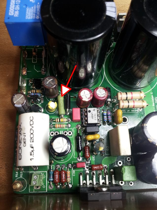

Edit: These may or may not be issues, but I noticed the following:
1) C4 (0.15 uF/100V Wima MKP4) looks a bit chewed up on one corner, possibly due to contact with a soldering iron?
2) R1 and R4 are in contact with each other - try moving them a millimeter or so apart, just a slight air gap is needed.
3) A bit of flux or something on R11.

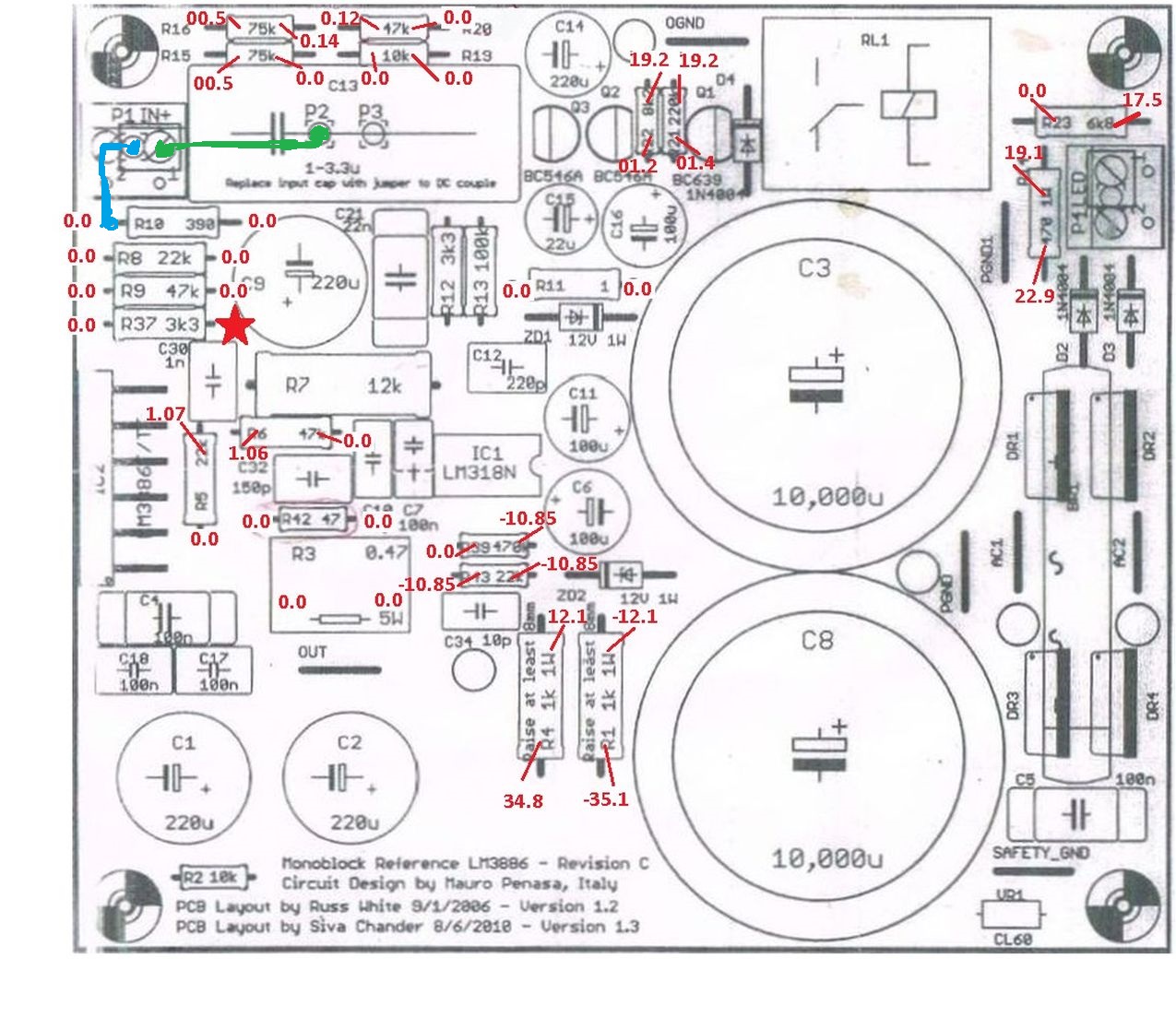

Well, If I wasn't thoroughly confused before - I am now. I would have expected the readings almost opposite of what they show. I did as much double checking as possible and believe this is accurate.
What was really interesting - on the good module - is just touching the starred end of R-37 with the positive probe opens the relay momentarily. Could not get a live reading as a result.

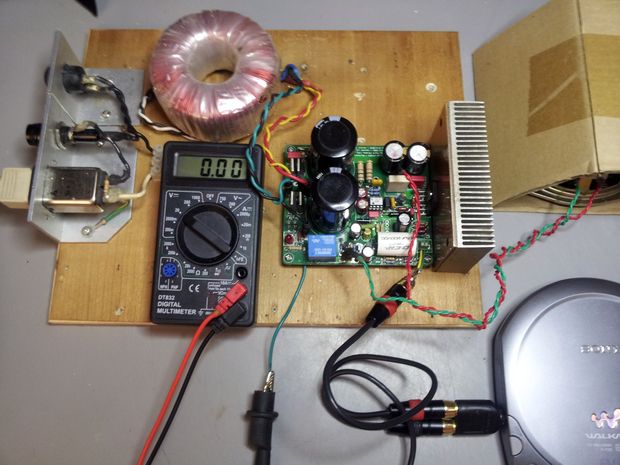

I did add a source and a speaker to the good module to confirm proper operation - works great.
Siva, hope you can see a picture here. 🙄 (Found an original document from your kit package 😀)

Yup, R11 is open - which is most probably the cause of lots of other things being stuck near -Vs, thus causing the speaker protect circuitry to leave the relay contact off (i.e. in protect). Replace R11 with a known good 0.5W resistor in the range of 0.5 to 4.7 ohms for testing, and see if the relay fires.
If R11 fails again immediately, then there are other problems to debug.
HOOOORRRAAYYY !!
R11 did the trick. Relay and LED are operational 😀😀
Still don't have sound yet, but I'll post another set of readings later today. Did check DC offset = 0.03, but that may tell nothing useful yet.

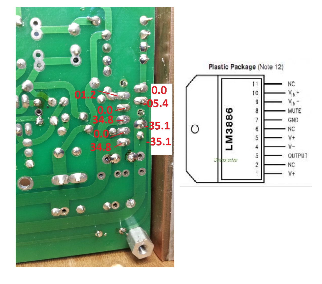

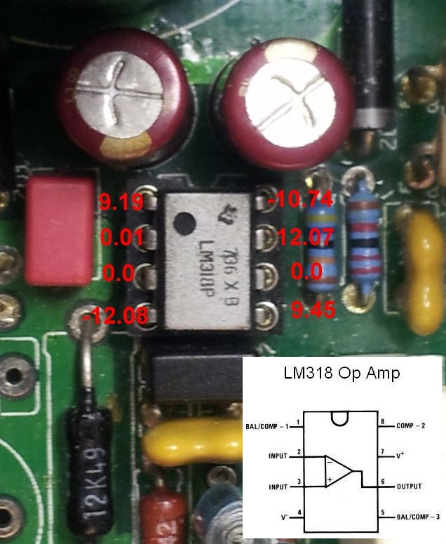

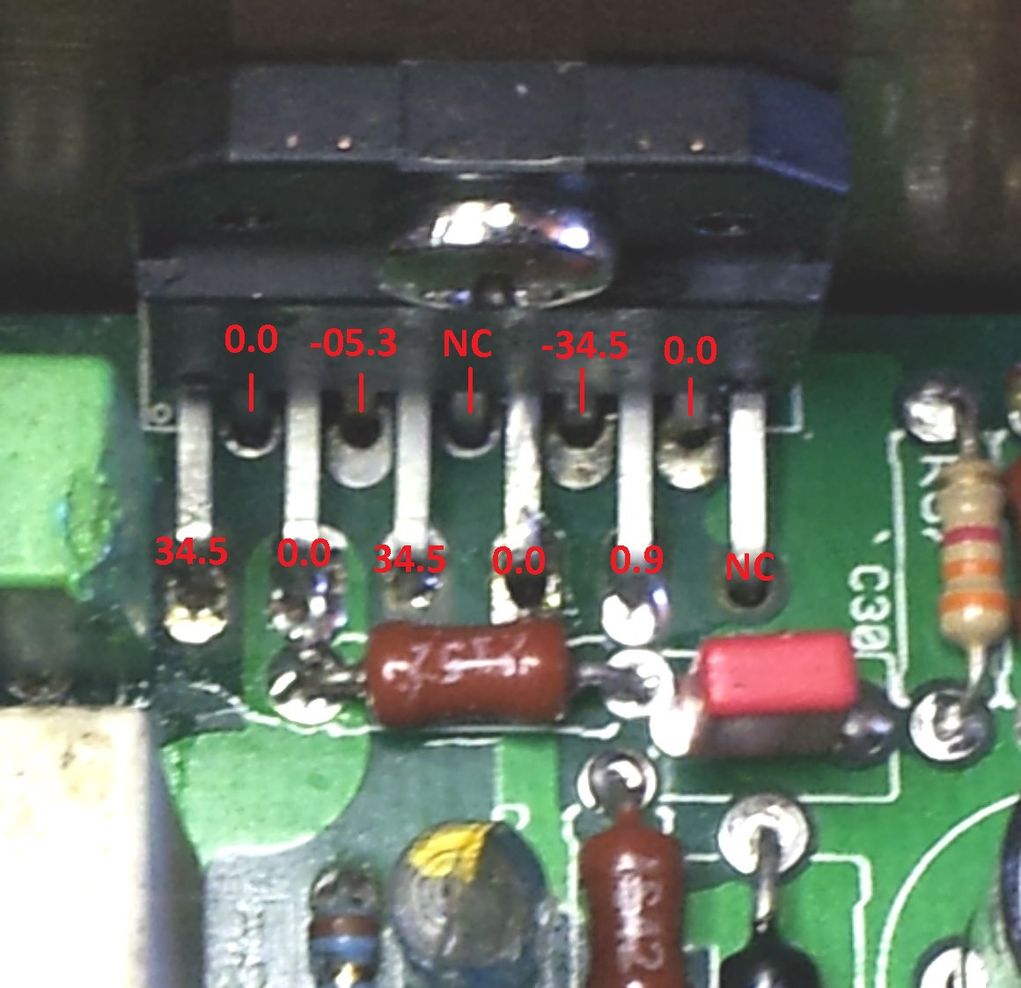

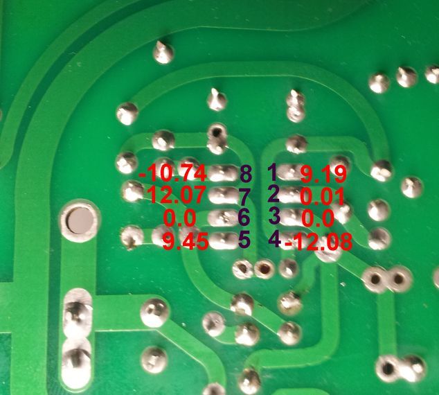

Sorry 😱, I got some of the readings turned around. This is what I actually have. While following the traces I did find that rare thing where one lead had broken from R2. Replaced it with new 1/4 W 10K resistor but no change. That trace does lead to pin 8 (mute) - should there be voltage there in un-muted state after the relay avtivates?
The mute voltage at pin 8 is independent of the relais. no voltage is mute!!!! All looks good at the LM3886.
Can you measure audio signals at pins 2,3 and 6 of LM318 with audio connected to conn1. First check schematic confirming pin numbers and understanding of what you are measuring.
The readings in post #1826 were done with the same connection to PGND as the previous posts. Should I use signal ground for any readings on LM318?
I just did a full swap and both LM318s function properly in the good module. Neither makes any change on the bad build.
Should I do the earphone test with the amp powered on - off or both. I confirmed the earphone signal at pcb input, but the closest cap I have is 22uF/25. Is that O.K.? These are 20 year old PC phones (have several) so if I loose them by not having the cap - no big deal.

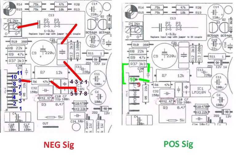

Before I start poking around - I can see the negative signal path, not so much with the positive.
If I attach the earphone signal ground to the input signal ground pad on the board - which points do I probe with the earphone live signal probe?
