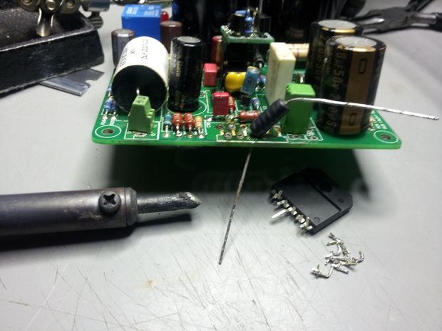

If all is OK with the resistors, remove and install a new LM3886 - it puts less stress on the pads than installing a pulled LM3886 that may turn out to be bad again, and replaced again.
Clave I've never had much joy using de-soldering pumps. Maybe my model was rubbish. What make/model are you using?
I've always found desoldering pumps better than solder wick... but it's two year that I'm using a desoldering station, the best 100€ I never spent... 😉
Desoldering pumps works better when the hole is larger than leads, I've had nice results with this one.

The clip/pull/braid method worked OK. Lifted just one corner of one pad, but it was just on a top pad where the actual connection/trace is on the bottom of the board. I should have a pump by now, and need a better S Station. You might get a laugh out of my hole cleaning method but it works. I have a dozen or so surplus wire wound resistors with strong leads. I use a big 45 W iron to heat just the lead, push it gently through the hole and draw the solder out over the full length of the wire. The solder can be removed from the resistor with some sandpaper and the pieces can be used again. Not professional but functional.:scratch1:😀

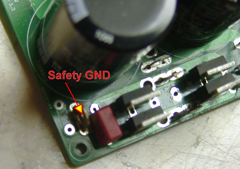

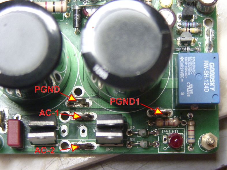

Dario, I'm still not sure I know the right place to use for PGNG as all four tabs receive power directly from the transformer on Siva's 1.3 boards. Is there a better spot to use?
There is a "Safety GND" in the lower left corner.
Both PGND and PGND1 are fine.

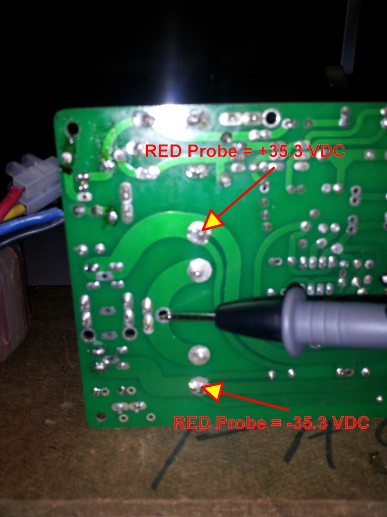

Need some other ideas. Any more readings I can take????
Bob, remove the board and measure all the values of the passives (resistors and capacitors) in-circuit and compare them with the working board - if there's a significant mismatch in any value, please post the part designator and value here. Check R11 for sure, if you haven't already done so. R14 seems to be 470R on your board, I've been using (and supplying) 180R/1W for a while now without problems - something like 220R/1W should be OK too.
PGND & PGND1 are both on the same net (i.e. shorted) on the PCB - they're fine for the trafo connections.
I'm just offering advice, take it or leave it, but unless there is something going on UNDER the terminal strip he has a blue wire going to the AC tab with a black wire going to the PGND1 tab TIED TOGETHER in the terminal strip.
Might be an optical illusion or there might be something under the terminal strip.. Does the black lead loop around under the terminal strip? If neither there is a problem there.

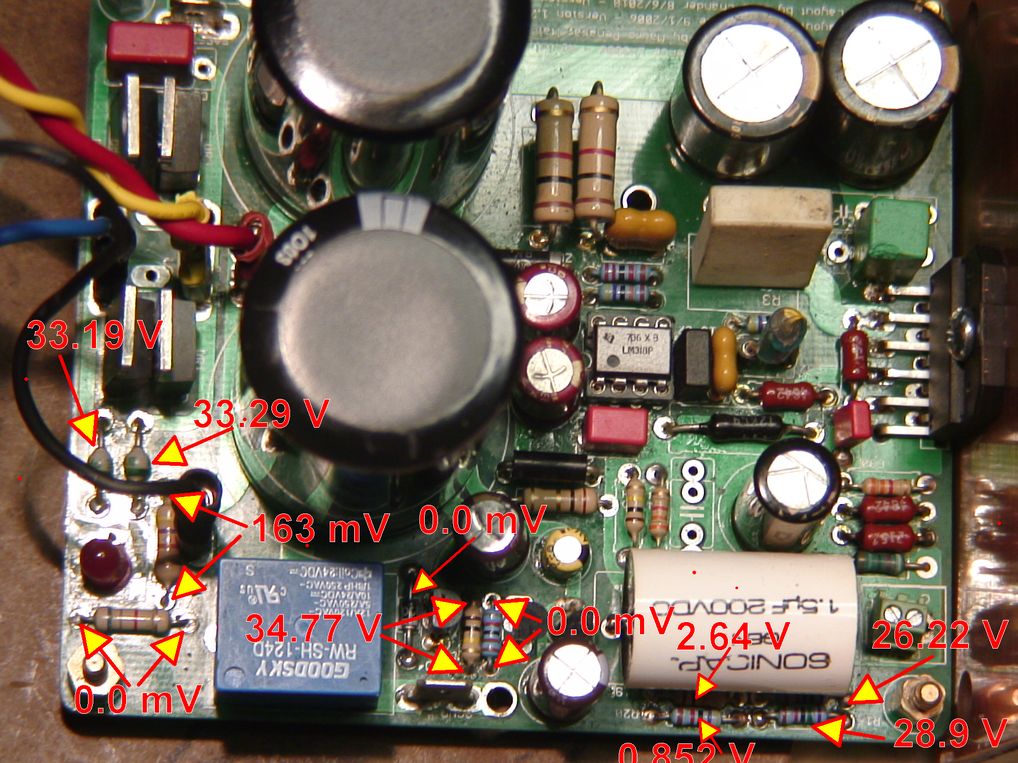

This is what I have so far. Tell me where else to probe.:scratch1:
After about 10 minutes to do these readings - the LM3886 is still at room temps. Apparently no power getting through.

OK - I'm not sure about this, but the reading across R14 looks a bit strange. You may want to replace it with a 180R/1W, and bend it out of the way of the PGND1 connector (to eliminate a possible short).
