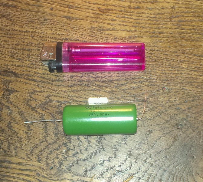

Hello,
K75 and FT-1 are now here 🙂
The K75 are quite big, I don't know how I will fit them, maybe I will try to cut the heatsink just to have enough place for the cap.
If someone here would like to try just two K75 in Rev C or Freeman Edition send me a MP 😉

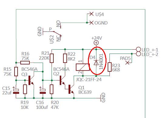

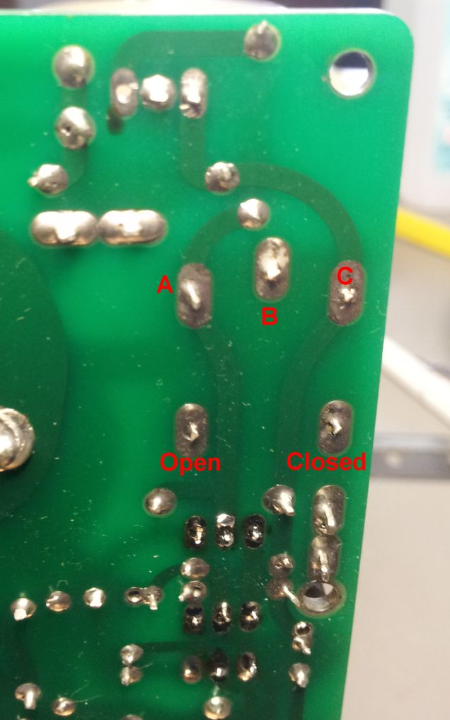

Picked up on trouble shooting my problem V1.3. My focus was on the relay and there were some lifted pads, so I used pigtails to insure continuity from trace to relay pin. Also confirmed relay operation by using a 18.5 VDC wall wart - works as it should.
Next in line would be the source of the current to power the relay. While checking the production rev schematic i see that D4 is called out as 1N4001 - and the BOM I have lists SBYV27-100-E3/4. I have a new 1N4001 but don't know if I should try it.
Also, where can I check for the correct current intended to feed that diode and/or the relay coil. Is it just negative probe to PGND and the two sides of D4?
I haven't encountered any failures in the DC protect circuit or the relay itself, though of course, dry/cracked solder joints, solder bridges and open circuits can happen anywhere.
The diode is just a flyback diode to protect the BC639 relay coil driver transistor when the relay turns off. Anything rated at over 50V reverse blocking should be fine, i.e. just about any diode. IIRC, I have supplied 1n4001 to 1n4006, as also UF4007 in some kits.
The current through the relay is a function of the relay DC impedance and the voltage across it. I don't have the DC impedance spec for the Goodsky relay in front of me, but the relay drive current has never been a problem with the validated R14=180R and R21=100K in my BoM.
If in doubt about the relay drive circuit, replace Q1, BC639 and measure the removed BC639 with a multimeter across B-C and B-E junctions, as well as C-E. I haven't ever seen a failed BC639, but it could happen on rare occasions.
I'd be more inclined to check the DC output offset voltage at the speaker out terminal wrt to PGND - anything below about 100 mV is fine, but it's usually below 10..20 mV in most cases.
Thanks Siva, Those are thorough explanations. The new 1N4001 didn't help. I believe Q1-2-3 are good as yesterday I cross mounted them one at a time and the results were consistent - they all worked on the good module and none made any change on the non-functioning board. However I will check the BC639s out of circuit just to be sure. I did a similar check on some IRFP240 mosfets for a discrete amp so it sounds somewhat familiar. Am I looking for a closed/shorted set among those various pin pairs or a resistance value.
Just for my own curiosity, what direction is the current flowing (if that makes sense) in the relay? From the end closest to the LED (A/B/C) toward the Qs or vice verse. I would assume from the transistors toward the relay, but the location and function of R14, D2 and D3 seems to suggest otherwise. Sorry, I'm obviously not an amp designer.😱
