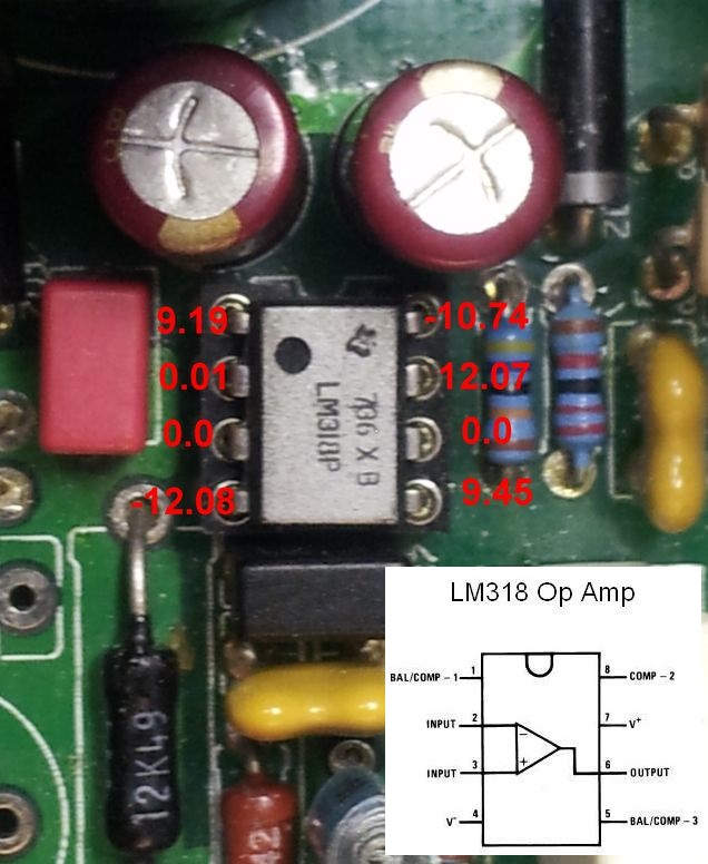

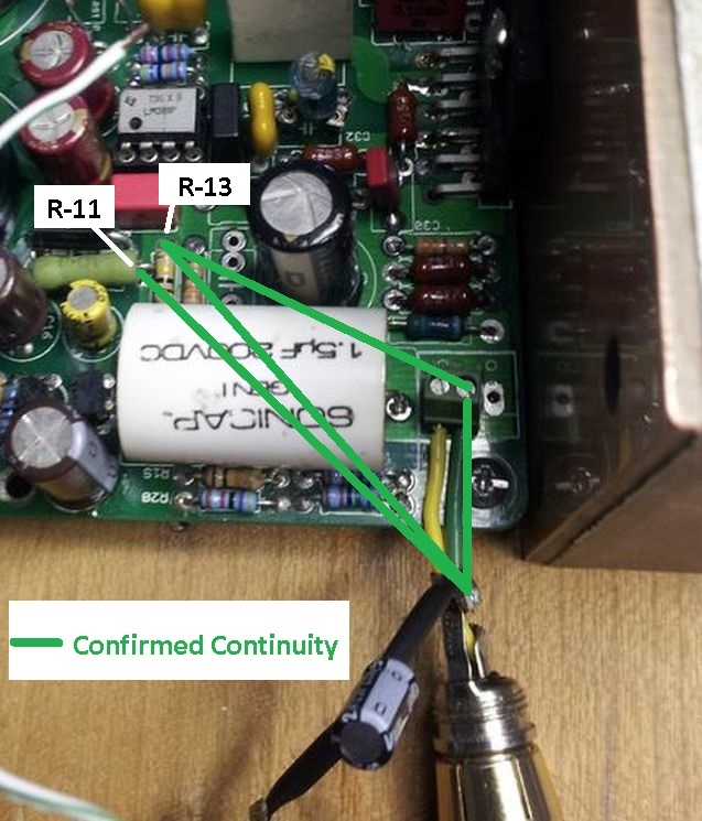

New readings on good board.
Green wire continuity.
Something interesting - I cranked the Walkman to max on the noise between FM stations. There is a slight signal now on pin 2, ~ 10 - 20% of what appears on pin 3.

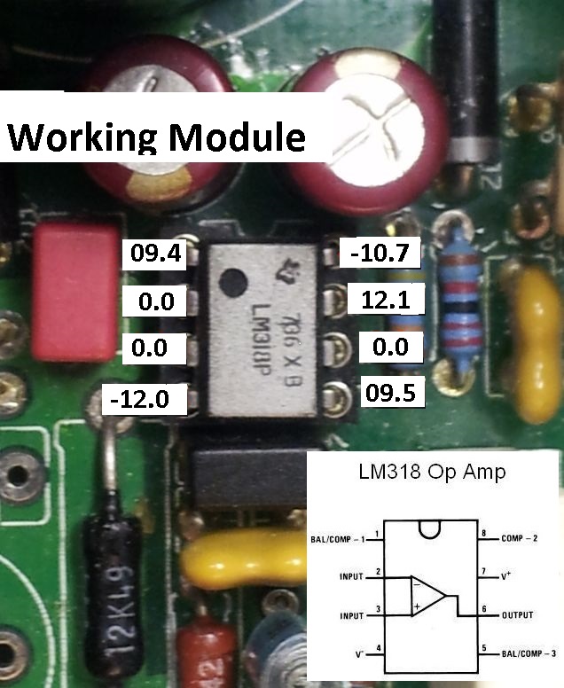

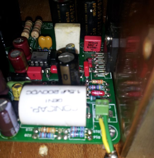

The DC voltages at the pins of the LM318 look about OK. Try checking the mute signal path carefully, especially the solder joints/pads and tracks leading to/from R2, which had cracked earlier. Then check the continuity and solder joints of R12, 3.3k.
The weak version of the signal appears at LM3886 pin 10. Touching pin 9 cycles the relay. That is the same action that happens when touching the inboard end of R-37. Going back to pin 10 or the signal input terminal produces a very slight pop that sounds like the LM3886 mute is being disengaged. I say that because the relay closes immediately when continuity to pin 9 is broken.
There is definitely a describable release of some sort before the signal reappears at pin 10 and/or the terminal screw.
LM3886 pin 8 = -5.4 V which should unmute the chip. Maybe pin 7 connection to ground.
The relays only disconnects the speaker return from the amp GND and doesn't mute the LM3886. The relays de-activating almost confirms that the LM3886 is still working, DC at pin 3.

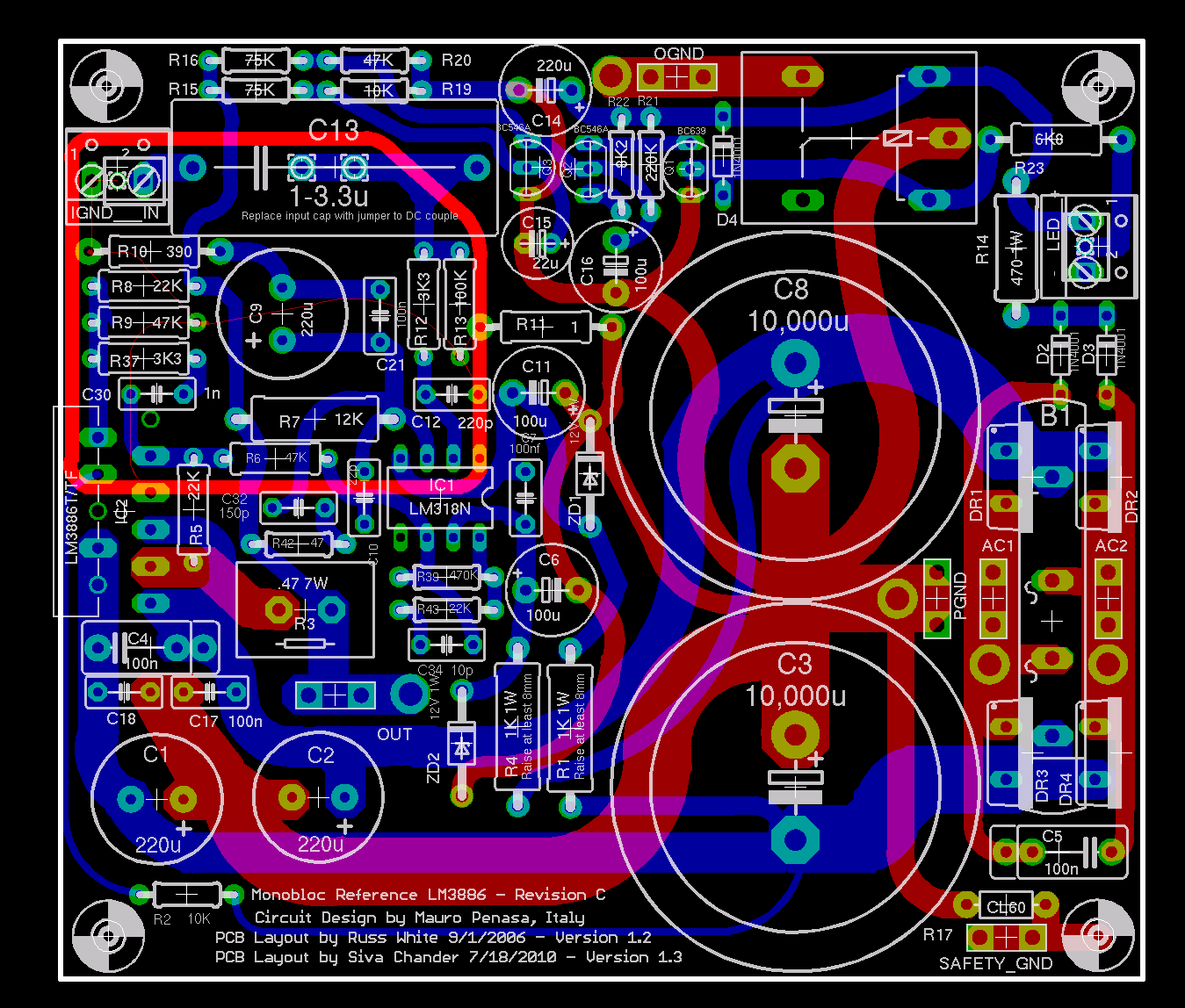

R7-R10-C9 / R8-R9-GND / R5-R6 / R3

As you are likely to be pulling a number of the resistors I was curious as to how important it is to match the resistors in the "Howland pump". Curious as to whether mismatch could cause amp to not to function properly.

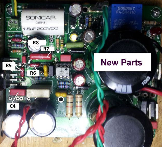

One at a time - I removed, tested value, cleaned pads, re-installed and verified continuity on R5,6,8,9,10,12. I found two matched sets (2 @ 22K - 2 @ 47K ea.) from Uriah in the stash, but used some extras to replace some resistors. Everything I pulled read correctly and the replacements were done just because I had those extras on hand. I can still place a complete set of the matched parts if needed/suggested.
I replaced the chewed-up cap at C4 with the same piece that's installed on my V1.2 builds.

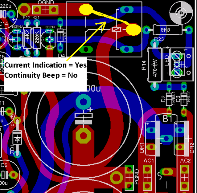

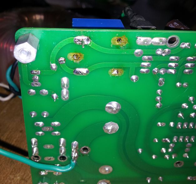

Also verified the appearance of DC on speaker outs at relay closing. Went from 0,0 to 0.03 VDC at power on. I tried to get a continuity reading from PGND entering the relay to the OGND tab. Couldn't get a signal (beep) but did get a current change indication when cycling the power.

Sorry, I should explain. The reason I tested for continuity across the relay is that's the only place where major/obvious damage (pulled vias) exists on the board. I inserted 0.015" solder along the side of the pins and let it flow to the topside pad/teace. Was just verifying that it worked now that I can't see the joints after removing those stilts shown in post #1798. I will use the bypass technique though - one less leg to worry about.😉

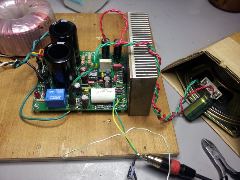

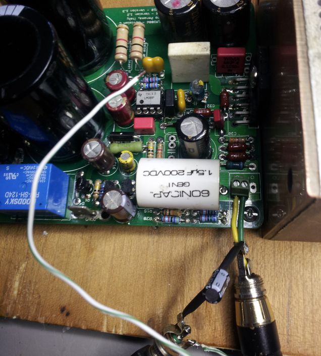

FANTASTIC - IT"S ALIVE !!! :wave2:
Did someone say "Relay" way back there in the beginning? The bypass worked and I don't have a clue if all the other steps aided the solution, but I'm one happy camper today.:happy2: I did swap out C1 & C2 this morning (one loose top pad but via intact) but still didn't get sound till the bypass was in place.
Still have to determine if the relay, board or protection circuit is flawed, but I think it will be easy from here.
THANKS ALL!! :hbeat: It's been a fun journey.
