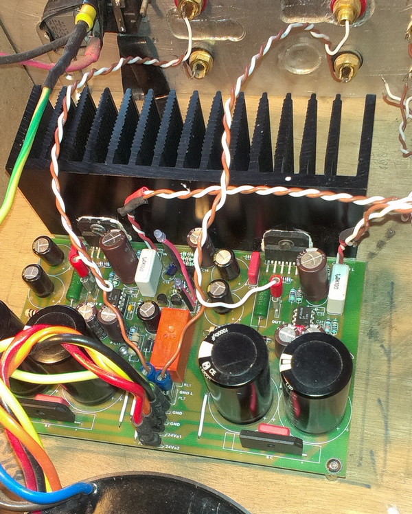

Hello,
I am sorry if I am off topic ... 🙄 but I have soldered the components to change My-ref A in My-ref C in that way:
I don't have yet turn on the amp, do you think it is right ?

There is a problem, I have a hum 😡
The first time I turn on the amp I didn't hear any noise, I listen to music for about an hour.
The day after when I power on the amp, I hear the hum. I am not sure that the first time the the amp was silent... but I didn't notice any noise.
Anyway, the the "A" version has run for two years without any noise, totally silent.
The amp is not in a metal box, it just lay in a wood table...
The body of the pot is connected to the cold (signal).
The GND (PCB) is connected to the GND (IEC) by a 47 ohm resistor.
The body of the selector is not connected to the cold pole.
If I move the wires there is no change in hum noise.
I know that a metal box is better... but it has run silently for more than two years
I have also change C29 and C13, the new capacitor (SCR MKP) is a bit bigger than the old one and now C13 is touching C9 and C15...
Here is a pic :
Any ideas to solve this hum ??

You have quite large AREAs of loops at all the In/Out sockets.
Tighten these up, a lot.
The speaker outputs at the PCB have enormous loop AREAs.
You should look at using longer wiring and ensure the twist is kept for as long as possible right up until the twist reaches the PCB. Then make very short wires to the two tapping points. Keep the two untwisted wires very close to the PCB to minimise the loop areas between the PCB current and the wire current.
I somehow doubt this will cure the hum, but it might reduce it.
I suspect you have changed something else.
What did you change? See the brown wire of the right hand pair and that it passes directly along the top of the left hand white capacitor ! That is really asking the current in that speaker wire to affect the current in the capacitor.

Thank you Andrew,
I have tried to rewire the IN/OUT and roll-back C13-29 to original capacitor but the noise is still there. I can "feel" the hum if I touch with my hand the woofer, it's quite loud and annoying 🙁
I have also bypassed the input selector but no improvement.
The original and silent version was: My-ref A + passive pot (10k). Then I have modified the circuit as you can see in photos above, replaced C13-29 with new cap and added input selector.
So... I suspect that I should roll back to A version 🙁 The PCB is intended for A version, maybe there is something wrong in new components placement. Any idea ?
marco
I roll back to A version and it is terribly silent. That's nice but...
Does it make sens to try to use normal metal film resistor instead of SMD ? juste to keep the "track" more distant from PCB tracks?
