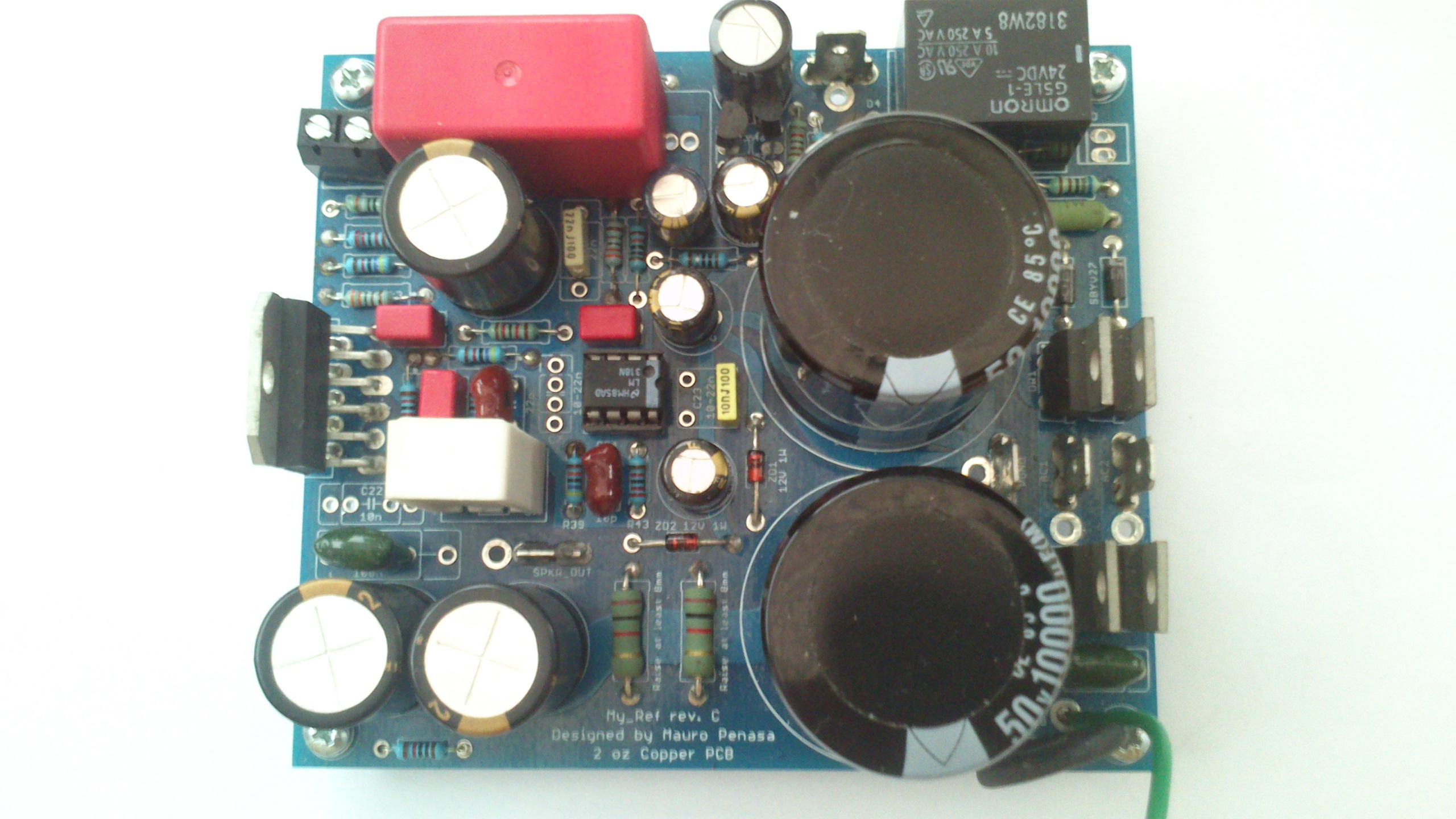

I have a strange newbie problem, which has mystified me a bit. When I first hooked up my rev c board I had no problem. I wired IEC 'input' earth or PE to a chassis post. I wired the transformer centre tap to that and ran another wire from the post to PGND on the board (but AC1/2 in the usual way). It's what I know as a chassis star ground and I've always done it this way in the past because it was something I was instructed to do on my very first amp build some 15 years ago.
Originally I didn't install CL-60 thermister or connect its associated safety ground solder pad to earth as I already had the power 0V line connected to PE in the method described. Anway I fired up, listened to it for a hour or so, no problem apart from hum coming from my active crossover which I expected. So far so good.
Now the tricky part. I later decided to add CL-60 to the board and run a safe earth wire from it's solder pad to the chassis earth post and attached the traffo centre tap directly to the PGND pcb lug as more usually done. AC1/2 connected as usual.
I powered up with amp still connected to the speaker (an oversight on my part). Immediately I started getting an intermittent loud crackling from the speaker, like someone scrunching up an empty crisp packet. Initially I thought there was a loose connection somewhere and started to investigate visually. Then after a couple of seconds SMOKE! From C1, (and possibly C2). I hit the mains power switch pretty damned pronto, let everything cool and discharge before disconnecting everything. Visual inpection reveals nothing I can see. No sign of burning on the pcb or C1/2 or anywhere for that matter.
I then connected my second board this time with no safety ground at all (yes I know) again no problem. So I'm mystified why the CL-60 to safety earth to PE method failed. Does anyone have any ideas what the problem is? Is it simply too much heat becuae of the CL-60, have I missed something or done something completely and utterly wrong?

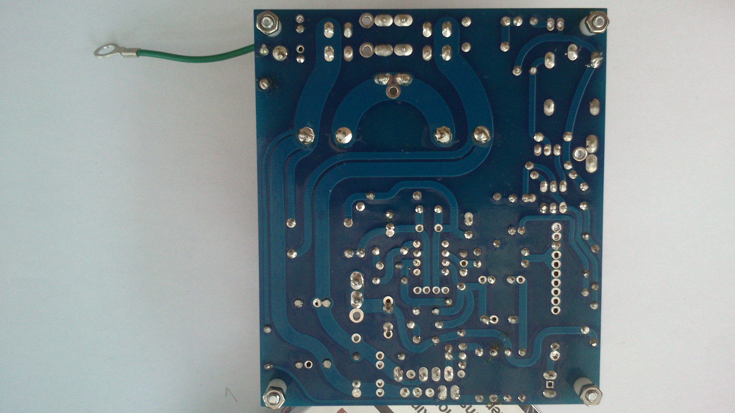

Pics of my board after smoking and a PDF of the schematic, which is very similar to Linuxguru's. I should add that I'll be changing my 2.2uf input cap to something else after very close scrutiny of Andrew T's observations on this component value in the scheme of things and I'll be backpedalling thru Clave's BOM with a fine toothcomb. A lot of my parts are crap stock Maplin's parts (it's only 300 yards away from my house lol) and I'll be paying close attention to non-magnetic, non-inductive upgrades.

I'm not sure if I understand the transformer windings - where does the centre tap come from? Is it there on both secondary windings? If not, then you have to derive it by connecting two of the terminals together - either 0 of one and 20 of the other, or 22 of one and 0 of the other.
With such a secondary combination:
1) The voltages on the two secondary windings have to be close - I'm not sure if 0-22 and 0-20 are close enough.
2) The phasing (polarity) of the two windings is important, as stated above:
0: AC1
22: PGND
0: PGND1
20: AC2
is one possible (correctly phased) connection. The same connection should be used on both boards.
3) If you accidentally interchange PGND with one of AC1 or AC2, smoke is a strong possibility - been there, done that.
It seems that you're using an LM3886T (with a metal tab). The metal tab is internally connected to V-, so it is imperative that the tab be isolated from the chassis earth, all grounds, etc. The easiest way to do this is to use a mica insulator or similar when mounting it to the heat sink.
If the metal tab is not correctly isolated from ground, smoke and a destroyed LM3886T are likely outcomes. If you have to replace the LM3886, use the LM3886TF (isolated tab version) instead.
Thanks. Yes it's a T type. It is isolated with a dry silpad, i.e. no paste to avoid accidentally bridging the tab to sink. And I have a pair of the same connected the same way to the sinks in plain old fashioned LM3886 boards no problems with isolation whatsoever. I deliberately went with the T for reputed better heat dissipation. Still doesn't explain why one wiring method worked fine for an hour or so and not for 3 secs the other way. After dissassembly I did an olefactory diagnosis! C1 definitely smelled burnt, although there's no visual damage. Nothin else smelled. I don't think C2 was burning and didn't and doesn't smell. The smoke appeared to be coming only from C1 on the board edge side. Doesn't smell burnt at all today. Anyway I'll replace C1 and 2 to be sure and cautiously try again with CT to PGND faston and PE to the solder hole behind it. I'll remove CL-60 altogether for now as there's a suspicion of a dry solder on one leg. If it's good and the LM318 and the LM3886 seem to be working I'll do the appropriate electrical tests before re-attaching my speaker.
Perhaps the intermittent nature of the crackling was thermal shutdown on the chip kickin in and out if I hadn't tightened it up enough to the sink? But that still doesn't explain to my satisfaction why one wiring method (2 methods in fact) worked fine but the earthing via cl-60 didn't. Hmm. It may have to remain a mystery if I get it working again okay without the CL-60 and after replacing the caps.

From the picture, it looks to me like one leg of C9 isn't soldered (I might be wrong of course). If that's the case, that could lead to the crackling - can't see why it would give smoke though.
The polarity of C1 was correct, right? A vague possibility - the can of the electrolytic C1 was not isolated, and somehow came into contact with one of rails, and/or with the can of C2. It should not have happened with Panasonics (?) or similar.
Geoff
It is soldered. Think you're looking at a solder hole next to the solder joint of one of the C9 legs. This is simply built in to allow different pitch size of C9 and is on the same track as the soldered leg. Thanks for takin the time to look over my soldering tho.
Yes the polarity is correct if you see the pdf of my component layout in previous post. They're Nichicon Muses btw. Have to wait to make up a decent size componet order coz every company over here in UK seems to charge £4 for p&p so not worth just ordering 2 caps.
I'll see more of any damage and poss isolation problem when I hoik them out. The pcbs are just about transparent enough to see thru in strong light.

Sorry Linux I missed this post. Apologies I had a type in there. Its 0-22 and 0-22 and yes it's inphase. I only have one PGND faston on my board where your PGND is on your board but no additional PGND1 unlike yours so the middle 22 and 0 lines of the traffo are joined and connected to my single PGND.
I was also thinking that I may have interchanged PGND with AC1 or 2 in error and in haste. Unfortunately I didn't think to check that first before I disconnected everything so we'll never know
