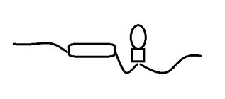

The bulb tester is essential (I have 3 styles), but I hope you are not confusing functions. The test I described can be done with that, but it's primary use is preventing damage at first power-up when the transformer is connected to an amp. A simple 1.5V flashlight battery and a bulb can be used as a continuity tester of you don't have a meter with that function.
