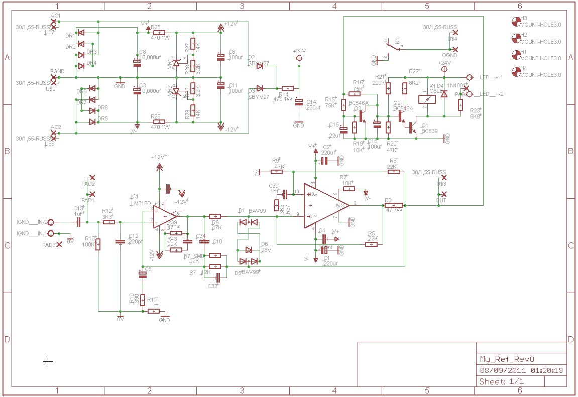

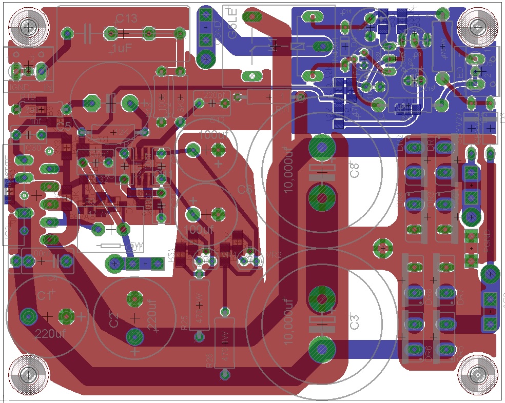

I've completely redesigned the PCB with the following goals:
Please, please help me to check both the schematic (especially the PS) and the PCB.
Any suggestion is welcome and greatly appreciated.

Dario, thanks for the schematic and layout.
I don't understand the main double-diode bridge rectifier circuit, but I'll try to digest it slowly.
I understand the zener limiter, but is it necessary?
It's widely used for gainclones and power amplifiers, you can read something about it here.
It seems so, in the original MyRef's thread people started experimenting with higher voltages for LM318 (using 15V zeners or regulators) and Mauro Penasa warned that if the voltage swing from LM318 to LM3886 is bigger than a certain voltage it would trigger SPiKe protection and 12V was selected as a safe choice.
So, though it gave a not small sound improvement, people abandoned the higher voltage path...
We know from Evolution available data that it use a 28V limiter and LM318 works with +-14V.
In the 'RevO' I'm trying to implement the same thing.
While it's true that the Evolution uses a different and possibly more conservative compensation scheme but I don't think it is directly related with LM318 PS.
