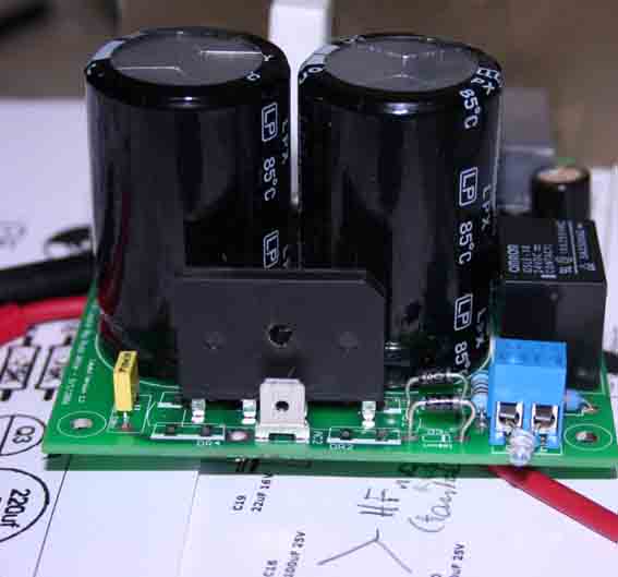

What I find very strange is that I had to put a wire between the two caps as shown on my pic. These should normally be joined together by that huge trace on the other side of the board. I may try to unsolder both caps tomorrow , swap them round and resolder without the wire and see what happens. Will first wait to see what Troy proposes.

So I think we should start off by ensuring the grounds are good and the proper voltages are in the right places.
1. You should have ZERO resistance from the tie points of the following pairs of caps and PGND.
a. C3 + 8
b. C6 + 11
c. C1 + 2
2. On the hot side of those caps you should have:
(for the C6 and C11 you can measure at the inside leads of R1 and R4 since they are raised and easy to get to.)
a. C3 = ~- 32.5
b. C8 = ~+32.5
c. C6 = +12
d. C11 = -12
e. C1 = ~-32.5
f. C2 = ~+32.5
g. C14 = +24
That will give use power to the sections.
