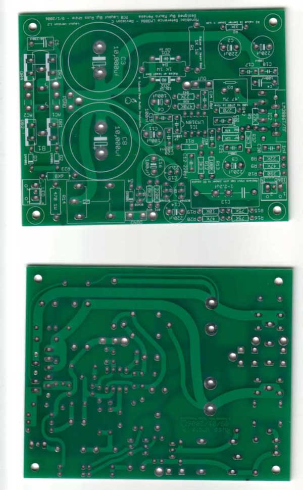

Hi Troy,
I scanned the pcb both sides before assembly.
Might be some help.

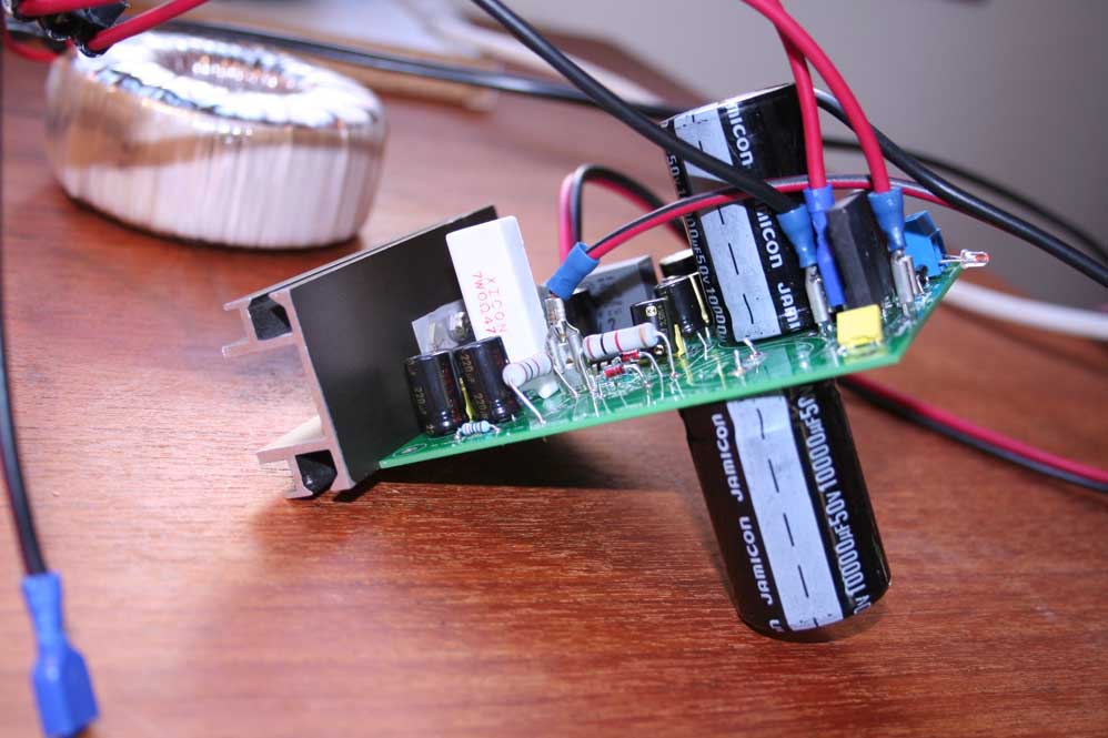

Stuffed both boards right away. I used Cardas lead-free tin/silver/copper solder and had no problems whatsoever. It costs $13 for a lifetime supply from Parts Connexion. Finally hooked one up today, using 22V 200VA traffo from Antek for each monoblock. I chose 22V tafos because I will be using these amps with low impedance speakers. Had problems hooking it up correctly, but I'll get to that. Finally got it right, attached to amp. Bulb tester flashed briefly, relay clicked. With shaking hands, attached cheapo speaker, powered up, bulb flashed briefly, crappy music played. Attached better workshop speakers, beautiful music played. Between tracks, cranked volume past normal listening level, no hum or any other noise with ear next to speaker. Seems totally silent. Heat sink getting slightly warm. I AM PUMPED!
I'll hook up the other board/traffo and test, then try it on my main system tomorrow: Marantz SA-11S1 SACD with Sonic Euphoria passive pre, B&W 802 speakers. That will be a real test of the quality, as I currently use (and am quite spoiled by) an ARC 100.2. If these little amps come even close, I'll be thrilled.
One sour note: compared to the amp I use in my workshop (power amp side of a big Nakamichi receiver thingy with outboard passive shunt resistance volume control), the My Ref seems ever so slightly bright. Not at all offensive, and perhaps just an artifact of not having run in the caps yet. Speaking of which, my coupling cap is a Vishay/Roederstein MKP1840 0.22uF. I plan to try some exotic stuff (maybe some Mundorf SIO or foil and film types) once I get enclosures made. I made no other changes to the stock kit, and it works perfectly.
About the transformers: there seems to be some confusion (at least, there was for me) about just how to hook these up. The primaries are paralleled. On the secondaries, test for continuity between leads. The two leads that do NOT have continuity are the ones to join and add the 0v wire at their junction. Of the other two leads, one goes to AC1 and the other to AC2.
Thanks to Uriah and Peter for their concept and dedication to its execution. I am very satisfied with the results. I strongly encourage you to build your kits. Take your time to get the parts situated correctly, which is really easy, and soldered neatly, which is not easy but can be done. Be cautious when initially hooking it all up. Once you know everything works, which it will, then let 'er rip!

Hi All,
Hi Troy,
I just finished testing and all was ok.
1. You should have ZERO resistance from the tie points of the following pairs of caps and PGND.
a. C3 + 8 ZERO
b. C6 + 11 ZERO
c. C1 + 2 ZERO
2. On the hot side of those caps you should have:
(for the C6 and C11 you can measure at the inside leads of R1 and R4 since they are raised and easy to get to.)
a. C3 = ~- 32.5 -31.3
b. C8 = ~+32.5 +31.3
c. C6 = +12 +11.7
d. C11 = -12 -11.7
e. C1 = ~-32.5 -31.2
f. C2 = ~+32.5 +31.1
g. C14 = +24 +23.7
Still no noise of relay clicking in.
I am going to go over all my solder points again.
Actually, even if it is frustrating that it is not working, I am really enjoying all this and learning a lot in the process.
Please keep your suggestions coming in.

Help No Longer Needed!
Hi All,
Bingo.
I went over all the solder points that went through from the underside to traces on the top-side of the board.
I took off my piece of wire soldered between C3 and C8 and took out C3 and soldered it from the other side of the board to make sure I had a good contack with the trace going to PGND.
Wired up and switched on. Then heard that magic click of the relay and all is fine.
Thanks everybody. I might have tried something stupid otherwise.
