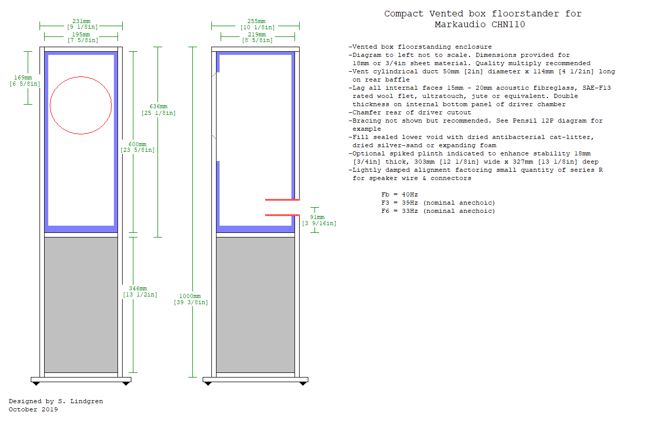

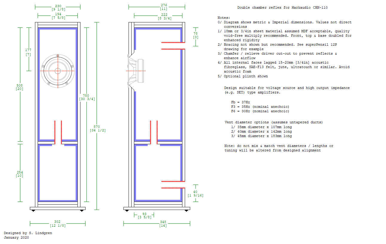

Did someone already build something with this driver? It took my attention also when they were announced a year ago or so and they finally (thanks covid for the delay) came availeble in my region so i ordered a pair. I'll probally design an own enclosure but i was wondering if someone did already do something with it and what their impression was.
Specs and graphs that are published promise a lot i have to say, and my first sims also. I'm thinking to make a 40L ported cabinet tuned to 38Hz with it after simulating some options. If the data is correct this could be a deal breaker at 60€ for such an 8"(actually a 6.5" if you distract the bezel) i think...
The boxes for CHN110 will be MUCH larger than for the P11.
I expect that 25-35 Hz F10 is doable with this driver in the right horn or TL.
Optimal reflex seems to 20-30 litres and can reach low 30s-40s F10. Low 40s-50s F6.
Based on reflex sims it gets to within 5 Hz of the A12pw.

that is also what i think, altough i think you can tune it to 39Hz and got a response to F3 of 35Hz and an F6 of 32Hz, but that only in a 40L reflex.
That is a lot bigger than my Mark Audio Alpair 10.3 desktop speakers in my office that get a similar response in a 17.9L reflex. But that driver costs a lot more of course. I paid when i bought them a few years ago about 140€, while i paid 60€ for the CHN110's...
In a waw alignment you can have a good flat response to 100Hz in a 5 to 15L sealed. But then you need a subwoofer below that.
