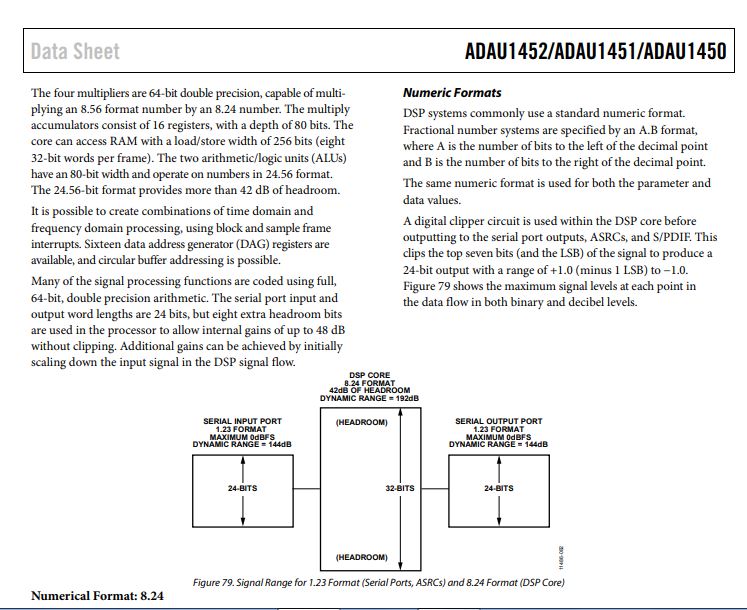

I've sent a mail to HYPEX : no answer. Where is the support ?
ADAU 1450 say :
see attachement and
https://www.analog.com/media/en/technical-documentation/data-sheets/ADAU1452_1451_1450.pdf
Headroom without clipping, but the Hypex DSP programming apply the same headroom than 24 bits -> 32 bits -> 24 bits of ADAU 1450?
Olivier F.
