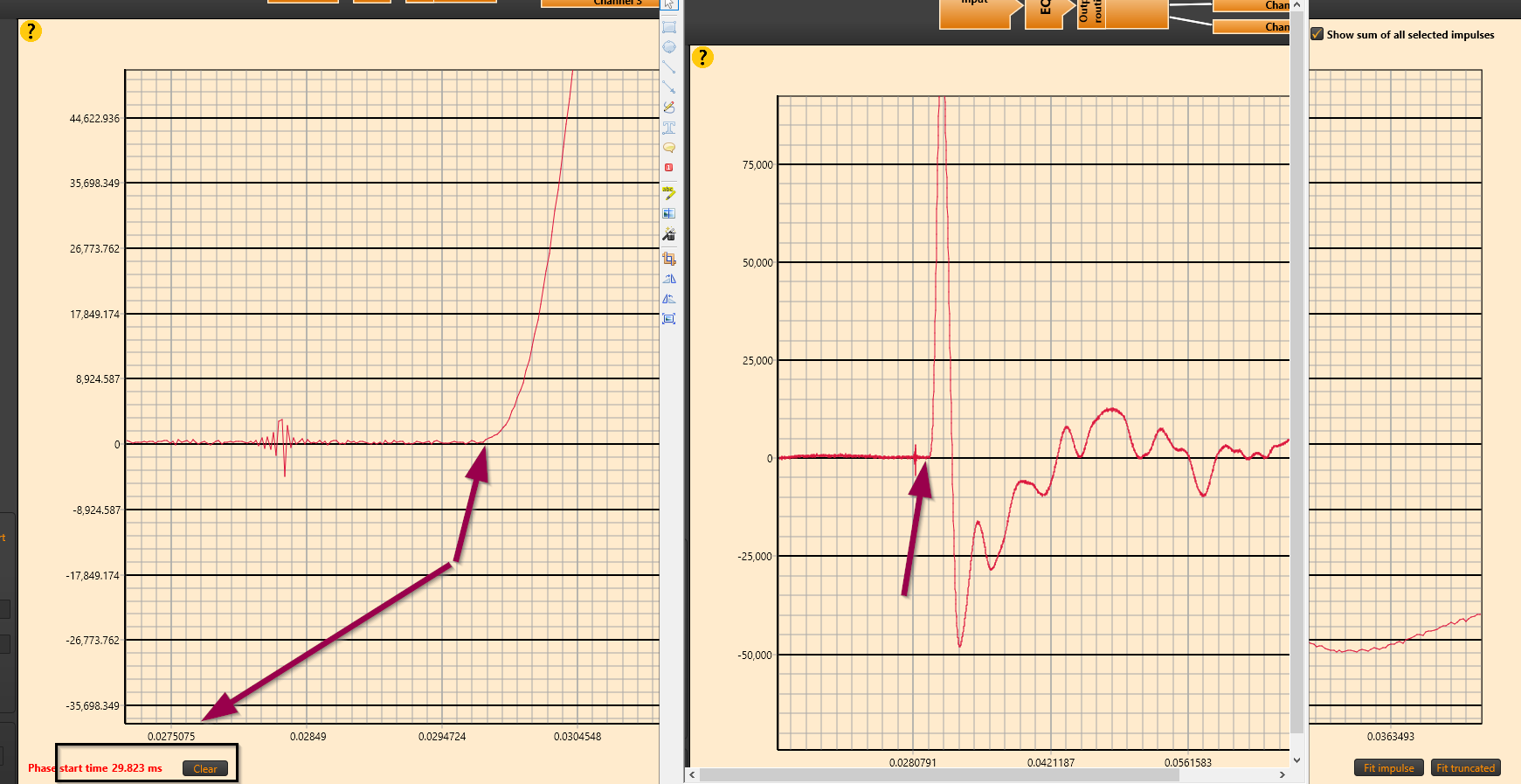

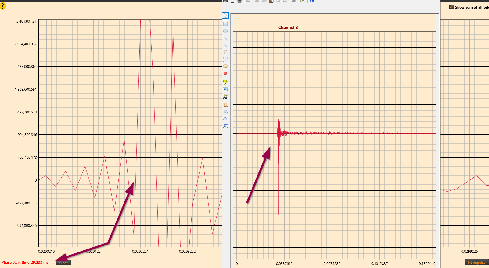

Just wanna be sure I follow the correct process for delay on this FAST project, before installing the fusions on my main horn system.
Measure separate drivers with xo filters applied, zoom on the impulse screen like following pics, and subtract the first big impulse time?
Measuring at 20cm, iSEMcon mic + UMC22
