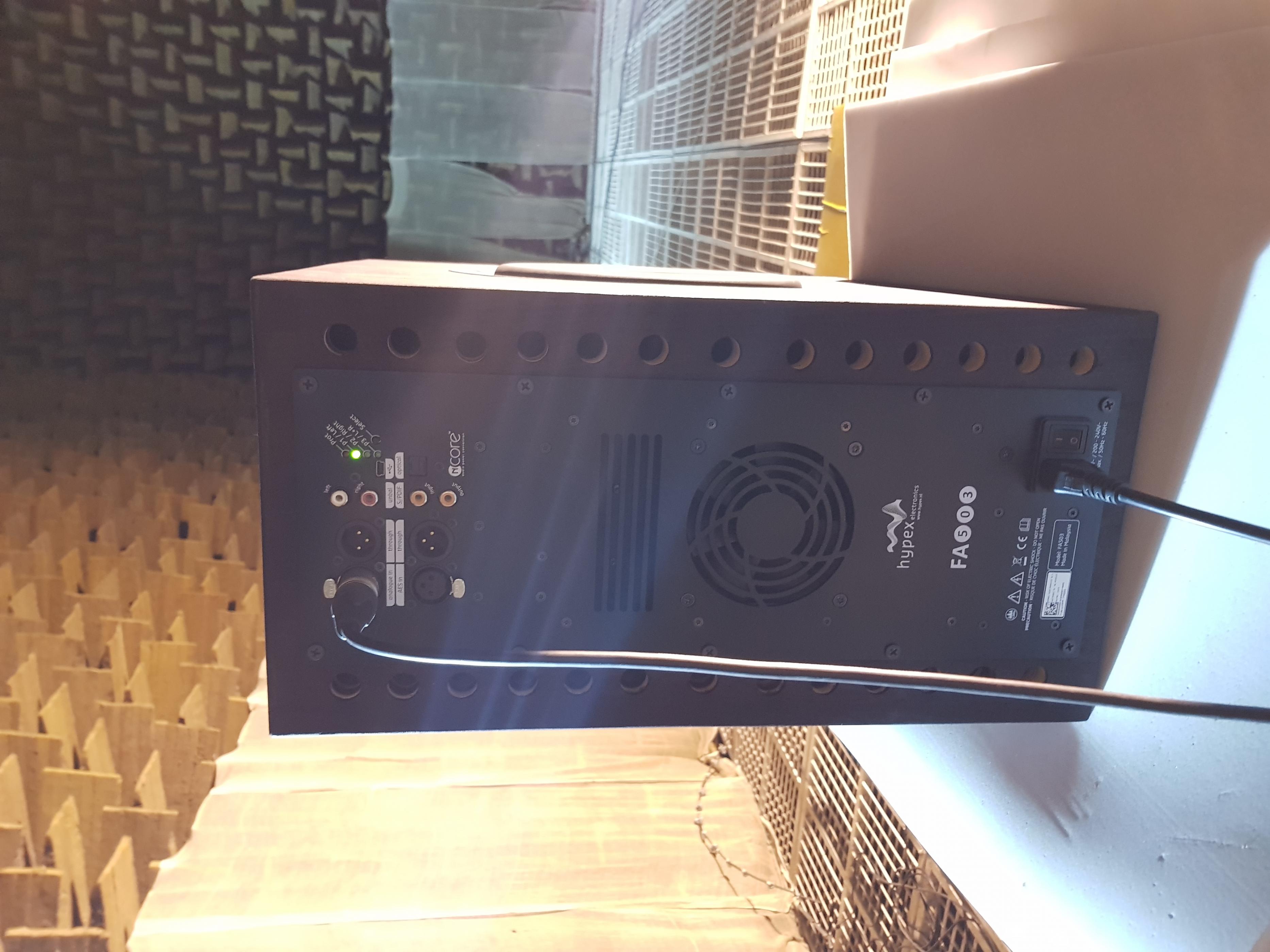

is it possilbe for someone with 503 to measure the voltage of the fan and the dimensions? Looks like an 80mm x 25mm fan.
Is it running with 12volt? The connection seems to look like 3-pin-Standard from computer without using the yellow one (speed control). So it looks like fan is just on or off and speed does not get controlled.
https://allpinouts.org/pinouts/connectors/motherboards/motherboard-cpu-3-pin-fan-connector/
Is it also possible to take an foto of the fan inscripten to get some info about the air volume and speed (rpm / cfm / m³h)?
Then it´s maybe possible to take an extremly silent one (be quiet, noctua) from computer area with similar air flow and speed to make it unhearable.
ok but on then picture it seems like only two pins are connected (red and black).
Independent from that, anyone able to measure the fan on the fa503 please?
I've designed / tested many speaker systems using the FA503 amplifiers and the only time I'm conscious of fan operation is during stress testing. The fans just aren't an issue during normal listening.

I use Hypex FA503 modules and they overheat.
The fan turns on often, even when the speakers do not work.
Do I just have this problem?
The noise of the fan is disturbing ...
Did anyone find a solution?
Thanks in advance.

Both plates? Please post some pictures.
