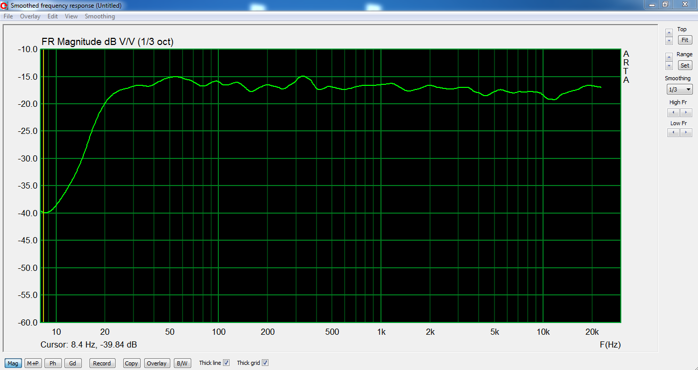

So, is it the frequency response of the driver in a closed box with a low pass filter around 70-80 Hz ?
then please show us the response with the MFB loop in the exact same conditions as previous graph.
I've never been myself able to get stables conditions at more then 9 - 10 dB of feedback (which is absolutely enough and sufficient to reach the maximum of the linear voice coil travel) so I'm extremely interested by your results

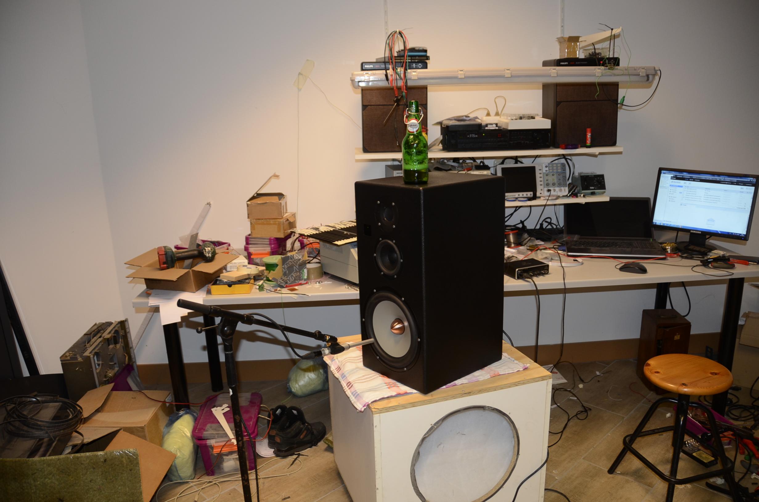

Free field measurement complete speaker at 1 meter:
attachment.php
No smoothing.
