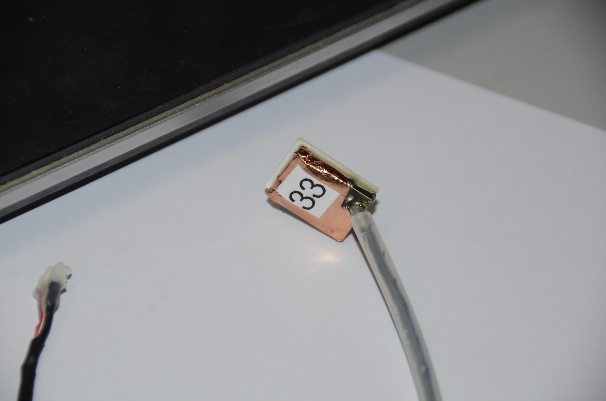

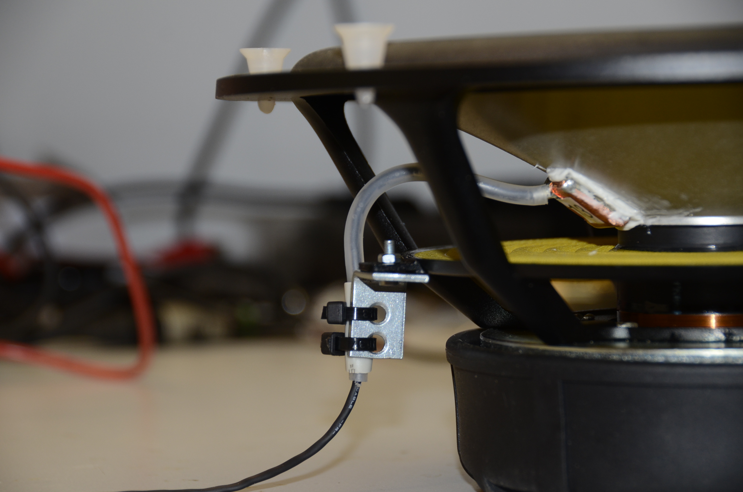

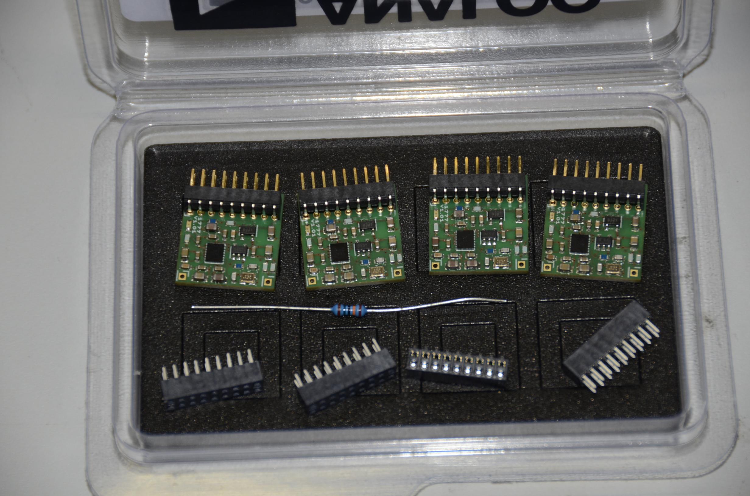

Very very nice but with what kind of accelerometer ? the very nice ACH01 ?
I use one on a MFB sub I built myself a while ago
Best regards from France

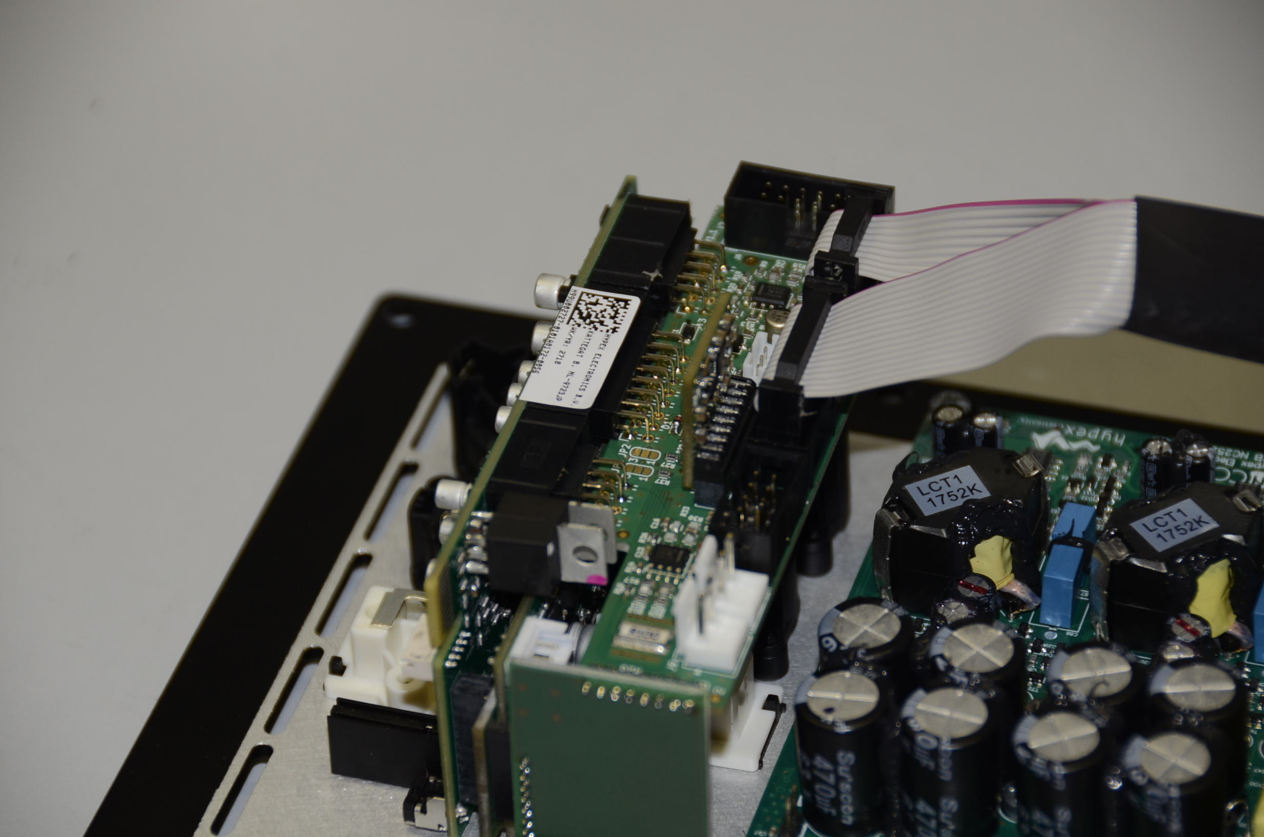

Yes, it is possible.
How exactly?
My thinking was as follows:
FA252: cut wires on ribbon cable going into no.pins 1,2,3 & 14,15,16 of J4 and then solder wires from 1,2,3 to respective +,-,gdn pins of new XLR connector for channel 1 and from 14,15,16 to gnd,+,- of new XLR for channel 2.
FA253:
Same as above plus 3rd input to cables cut from J4 of NC100, 1,2,3 to respective +,-,gdn pins of new XLR for channel 3 (tweeter).
Everything else of FusionAmp remain unchanged and should work OK?
I would not cut anything myself but simply disconnect the original ribbon cables and build the ones that will fit your goal.
Go to Hypex.nl, download the appropriate datasheet of the X02MP OEM and NC100HF OEM to check all pinout and you should be ok
