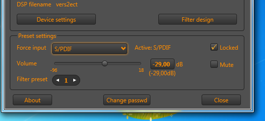

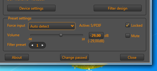

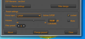

ds23man - can you please try to reproduce my issue of AutoDetect not picking up active source?I can reproduce it if I set the input to autodetect:
If you force an input, no problem:
Be aware you have to do this for all presets!
If you have SPDif actie- can you force selelect analog and then chose AutoDetect so it can auto detect the SPDIF?
