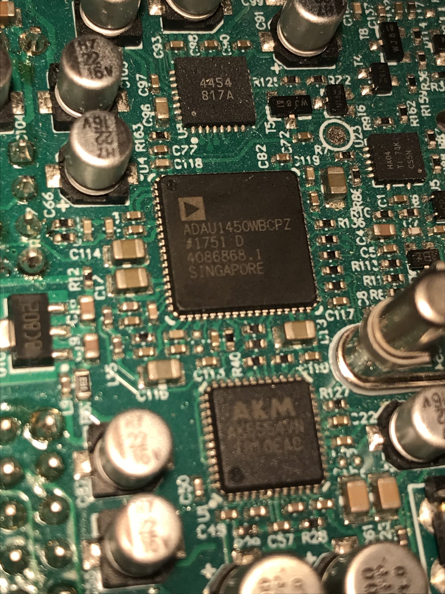

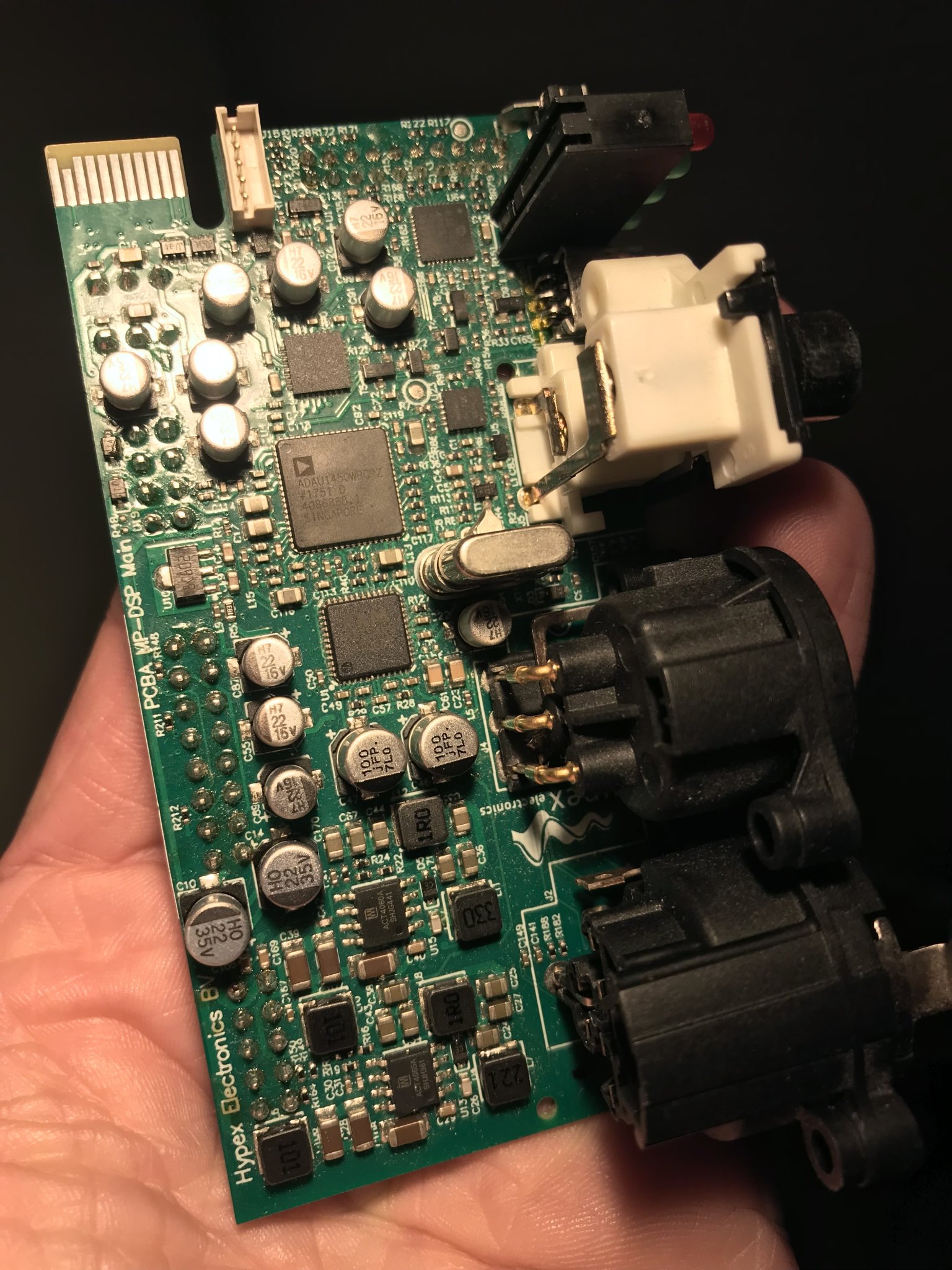

This is the DSP-board I had to exchange due to dumbness (hasty spinorama measurement -> catastrophy). Its the ADAU 1450 chip.
I hope they will change their minds, and I want to be fair: When I ordered the replacement part, the sales / support team, very kind in contact, asked for the serial number of the plate amp. They seemingly had to manually take care that a communication between the DSP-board and amplifier components was ensured. Something a small company can offer in case of a damage, but maybe not for a large scale revision of a whole product line. The only feasible option then would be to give away at own risk the means to flash the chips ourselves, and this is a lot to ask for, I have to admit.
Still, I think we should find a way how DiY-users could implement the new DSP-board and upgrade their incredible amps to FIR. @ds23man?

https://www.hypex.nl/products/dsp-family/dsp3-213Regarding the serial no linking to the DSP board. Two of my plates did not work when I got them because they had forgotten to link the serial to the DSP board. They sent me a small program to do the linking myself. It took 5 min to fix this. I am willing to take the risk🙂
