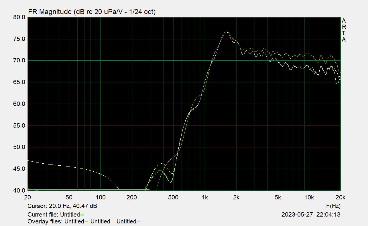

What do you think about connecting a transformer coupled ribbon tweeter directly to the NC100HF of the Fusionamp?
Some say don't do this because such a tweeter have almost dead short DC resistance (mine have 0,06 Ohm DCR).
I asked Hypex and they said this:
"I don’t expect any issues with this configuration but the amp is DC coupled so as a precaution you could wire a capacitor in series."
But as far as I know, Ncore amps have DC output protection, so I don't know what to think.
I want to avoid the series capacitor because in my opinion every cap has a sound signature independently on the transfer function.

Use a capacitor.
In my opinion capacitor "sound" is largely a myth. Once you stop believing there's a difference, you stop hearing any.

I think the Hypex will do just fine without any cap, if you make sure there is absolutely no signal in the frequency range where the impedance is very low. Using a cap will protect the tweeter of course. I still use fuses on my Magnepan ribbon tweeters - it’s saved me from burning them a couple of times …..
If something happens with the amp, or if you accidentally send full range signal to the tweeter, a cap will protect it.
Good idea. Even 0,5-1R should be ok - just to keep DC current from doing stupid stuff.
