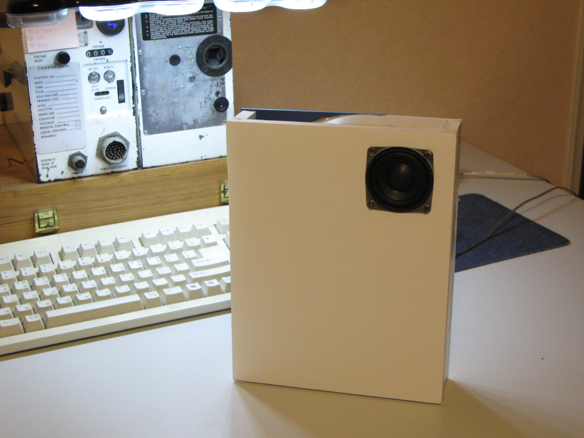

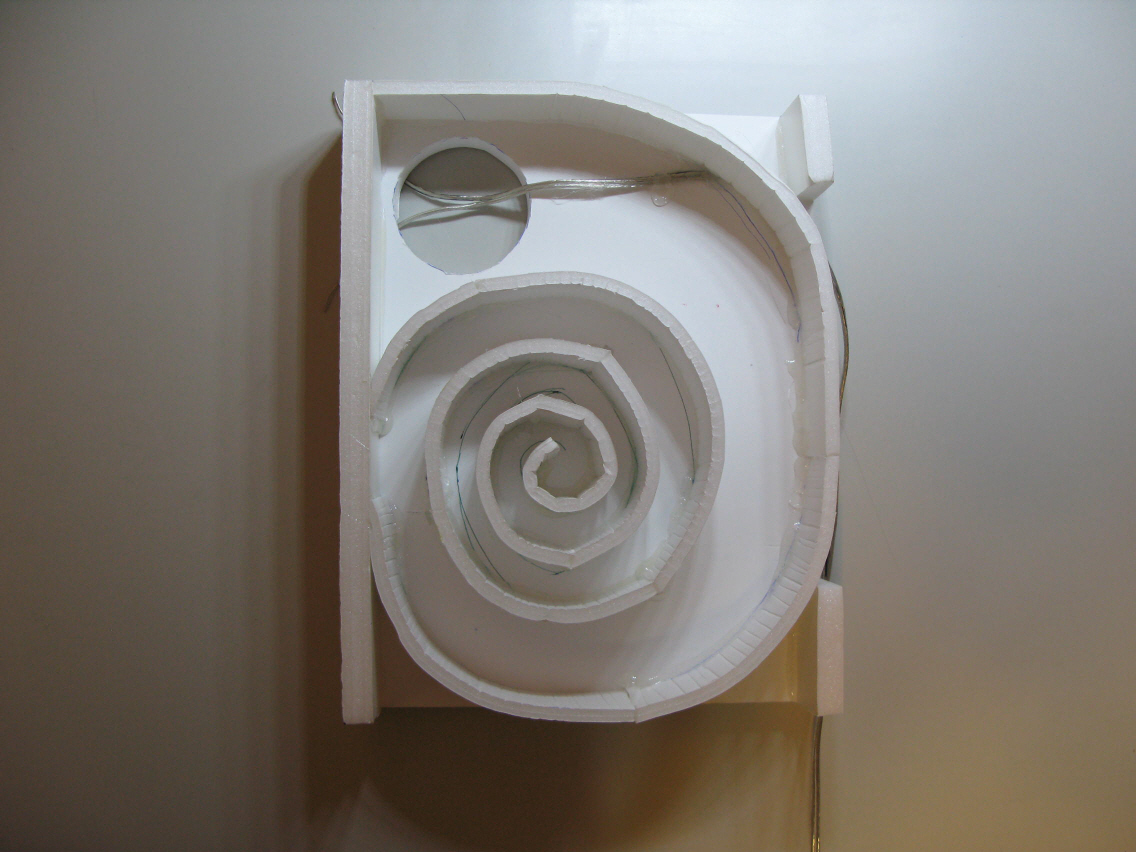

I tried the aperiodic TL midrange after reading Planet 10 and xrk's posts.(thanks guys!)
I liked it very much, and I recently made a spiral 'Nautaloss' version with a little bit of 'Cornu' added in. (can it be thought as something like a reverse Cornu? LOL)
I wanted a very compact footprint, and thinking of trying a configuration with the driver on top(firing upward - if the box is standing upright) next time.
Is there anything I'm missing/doing wrong? (probably - 😀)
Please feel free to correct me.

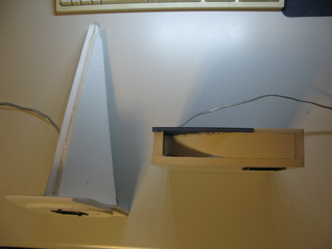

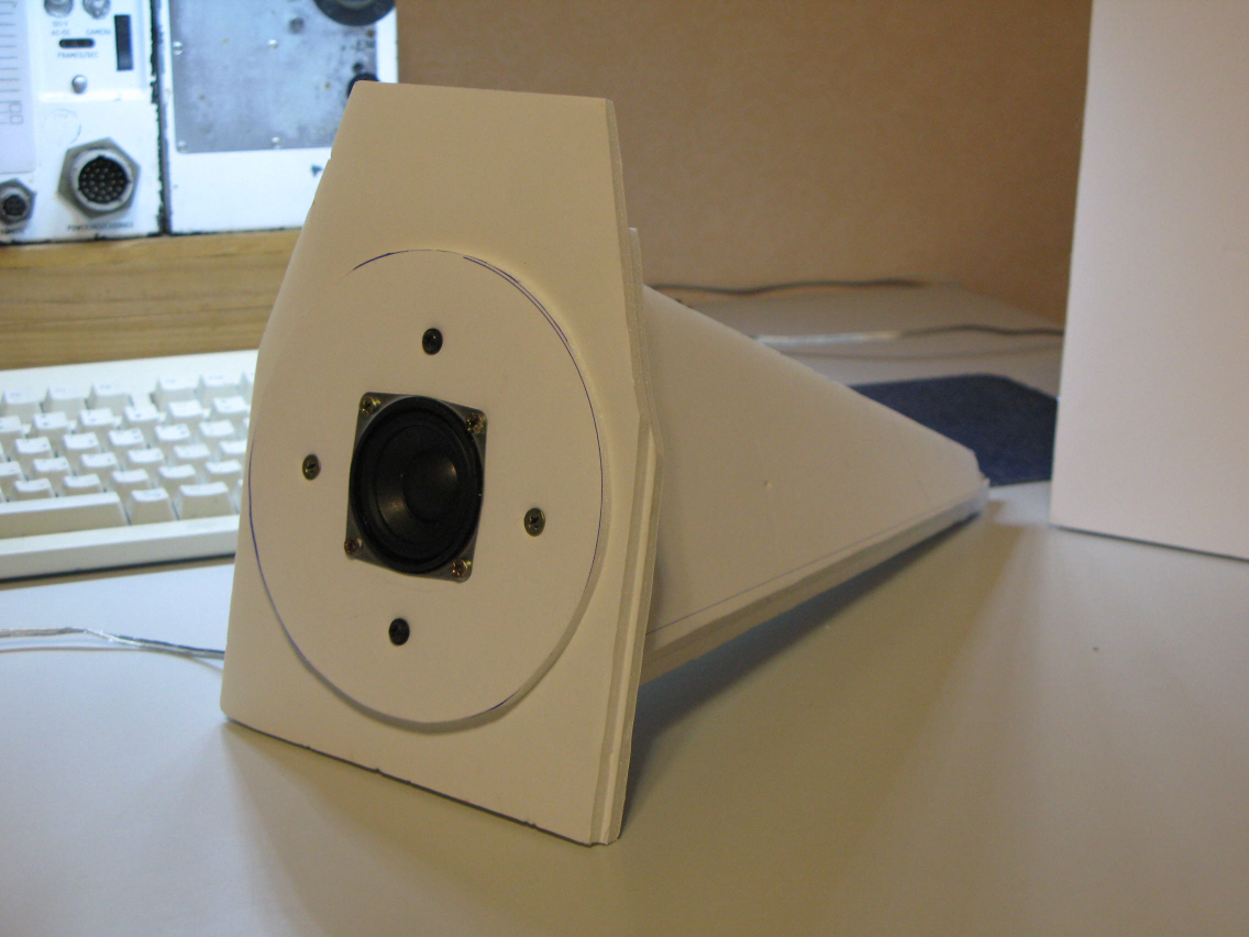

Attached pic is the 'Hardcover' spiral TL, and the 'Dagger TL' for size comparison. (both use the same 2 inch driver)

Bolex,
Looks great as usual. For the spiral you need to put a good absorber right behind the driver to prevent that first main reflection. Otherwise looks all good - neat idea to get more baffle area by putting driver on the side. The Dagger works either sealed or with a small vent best vertex. It is surprising how the impedance plot changes and how the phase tracks - they are different but I am not sure which is better.
xrk,
Thanks!
Check on the damping material, and the vent on the Dagger😀.(visible on the last pic - nice design, by the way)
I made this version hoping the small footprint will be suitable for horn loading. (it had to be shallow or the midrange horn would protrude too much into the room)
I've seen people loading horns with sealed, dipole, even cardioid arrangements, but I couldn't find anything with aperiodic.(I tried, and it sounds pretty good...)
Is there a reason for people not doing this more?😕

The Dagger is a great low distortion compact sealed back chamber for horns or any other speaker where you want low coloration. Check out how low harmonic distortion is for SS 10F/8424:

Thanks for the confirmation!
The Dagger was the first aperiodic TL design I tried, and I was very excited by it's distortion free characteristics.
Also, recently I used it to load a EV HP640 horn clone, and it sounded very nice. So it's good to hear from you that the usage of aperiodic enclosures in horn loading is 'legitimate', and I'm not barking up the wrong tree... 😀

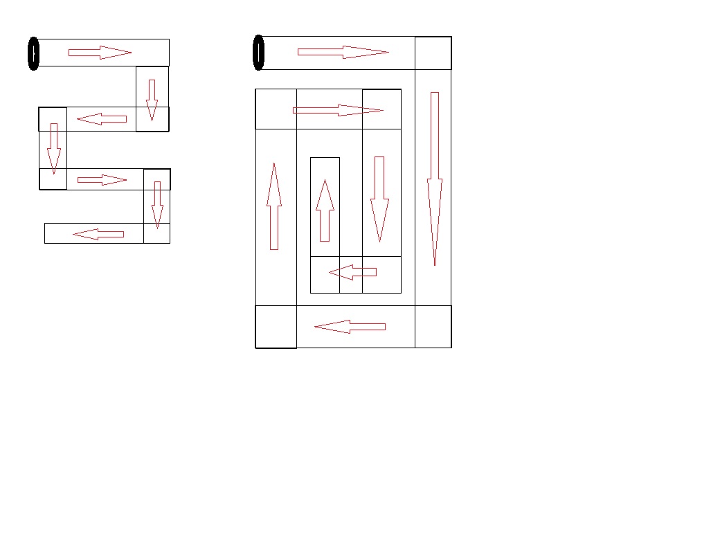

Also with regards to the build....
The spiral seems to go off from the driver to one side. In most builds. Is this to better confine the backwave and reduce reflections or could I channel the spiral from one side of the driver so it fills the cabinet better?
Or...
Could I start in the middle and channel it into 2 spirals? Half the length each maybe?
Or...

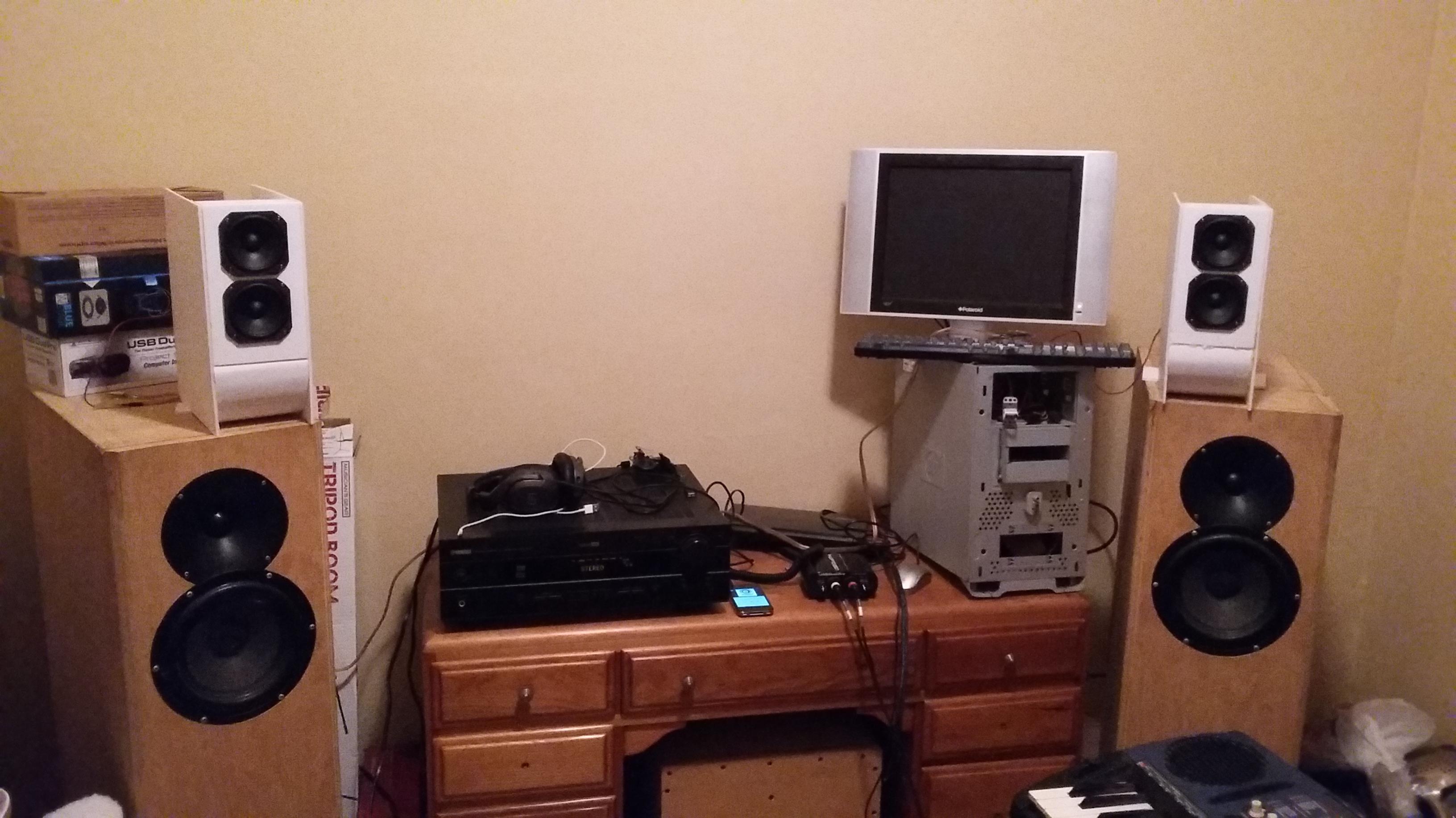

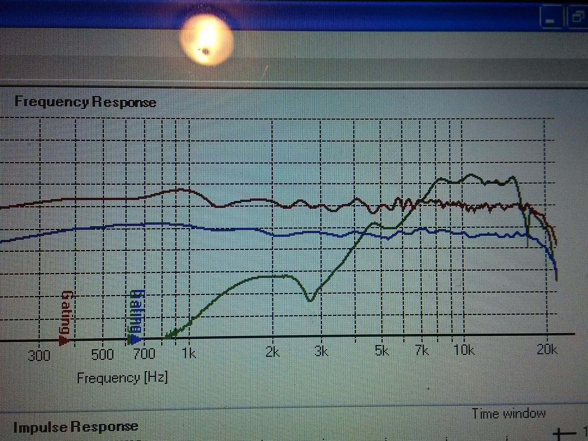

I installed the tc9's and hooked up the speakers to my stereo. An older yamaha receiver (htib type that I purchased from swap meet sans remote for 30 bucks).
Then I cranked up the sub crossover as high as it would go (200Hz on old 80 watt yamaha sub with 12" old school kicker 12" in sealed, overbuilt box).
I could tell something was off a bit due to not having proper crossover. At very low volume it sounded a bit flat. But when i cranked up the volume, it really sounded clean.
The room has no treatments and bare wood floors. Regardless, the imaging was awesome.
I can only imagine how awesome these would sound as midranges.
It's hard for me to use these as my main speakers, as I have a pair of dtqwtII's. I get spoiled with those. Ironically, Troels likes down tilting treble, so they lack a little sparkle, kinda like the tc9's. I have crap hearing so could probably use a tiny bit more sizzle.
But boy do the dtqwt's measure flat!
These tc9's seem to be as good as measured and talked about. I will try to play with the drivers in other projects and measure them when weather is warmer.
I measured the dtqwt's twice while setting up measurement stuff and tested some car audio junk i had laying around. I will use troels measurements and mine so i can compare other projects. Sort of a baseline.
Green is crappy tweeter, red and blue are dtqwtII's.
I dont think these will work for me on their own, obviously. I need to build some stands that are woofer enclosures to get me down to 80 hz. I just dont have time or money for dsp (i can use analog pre amp inputs on my receiver for two way part of set up in future).
I would like to hook these up like you did, to a sub (or woofers and sub, i looooooove bass!).
How did the imaging sound when you did the dual woofer spiral sub? Did you cross it over high, maybe around 200 or so?

since in the principle of this speaker, the importance is given to absorb rear wave as much as possible...apart from snail like structure, any other design is good to use? the one that could be simpler to construct. i was thinking of using pvc pipes bent at right angles. below is a crappy image just to give an idea. total length of the pipe from speaker driver to tail end is 1/2 wavelength. also tapering affect can be given by using reducing dia pipes after every bend. will this still do better job of absorbing rear waves?
The "Dagger" rear chamber works probably just as well and is easier to make. However, if you want the same larger volume, it will be very long. Use 3 or 5 triangular sides for a tall pyramid. Stuff with polyfill/fiberglass/rockwool progressively denser to the vertex. Measures like an open baffle as no obvious back wave reflection visible.
