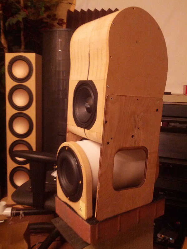

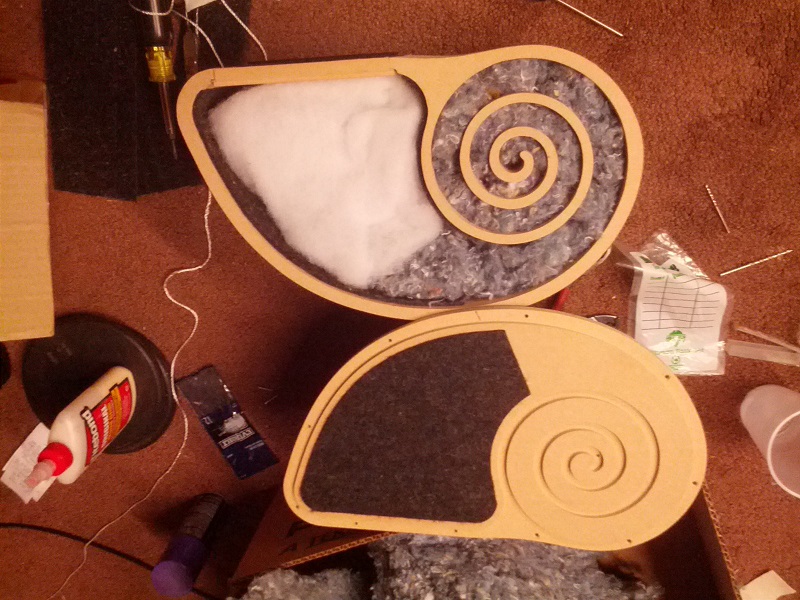

Mmm, here's something I made back in 2012. Not quite a Nautaloss, but I'll post it here still. More or less the same principle. Pioneer A11 4.5" driver in an Augspurger-style damped TL.

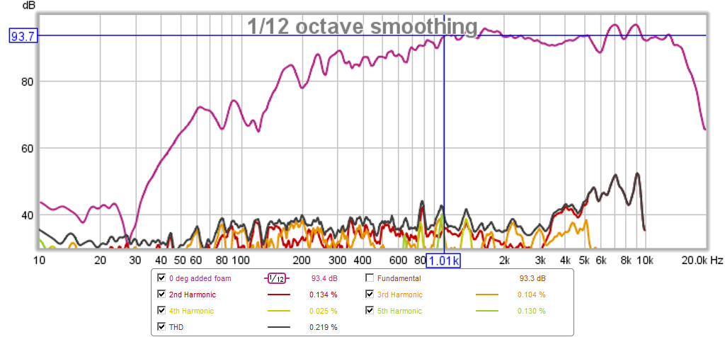

Red: cone output
Green: pipe terminus output
The pipe output would not add to the cone's SPL more than ~1db at 100Hz and 3dB at 50Hz, where output is way down anyway.

That looks very nice IG. Is the TL meant to be heavily stuffed to basically attenuate back wave more than to enhance bass? I noticed a dip at 1.5khz - that corresponds to a 6.75 in flat-flat resonance somewhere or is it inherent in the driver? It may be the distance from the top wall to the flat below the driver? I usually put grey eggcrate foam on flat flat faces behind the driver for this reason. Does the cork on the front do anything?
Thanks for posting it.
I think it's supposed to suppress most output save for a tad of support real low. Mine mostly absorbed it all in the usable BW. Now that I think of it, the final version replaced the fiberglass with polyfill and that last straight segment before the terminus was left un-stuffed, so perhaps there was a tad more output than the above measurement.

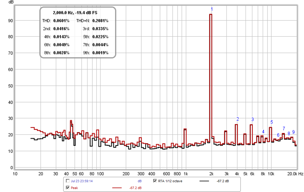

I have other measurements of A11 in various baffles with that dip, I'd say it's the driver. I've never measured anything that extreme even from bare interior walls inches from a driver in any case.
Very critical. It looks pretty. 😉

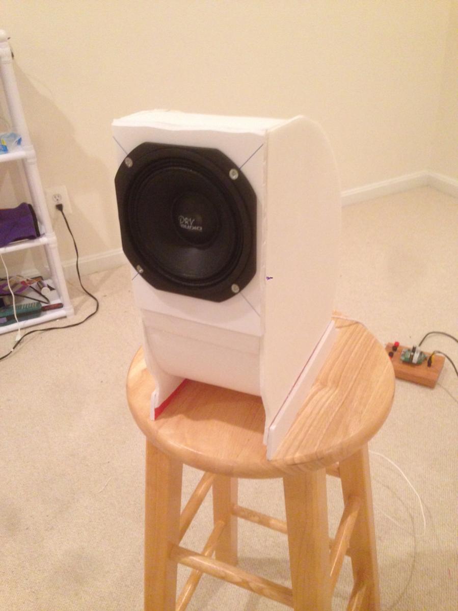

95dB sensitive 5in driver in Nautaloss as test. The PRV 5MR450-NDY (http://www.parts-express.com/pedocs/specs/294-2705s.pdf) is very low distortion driver.

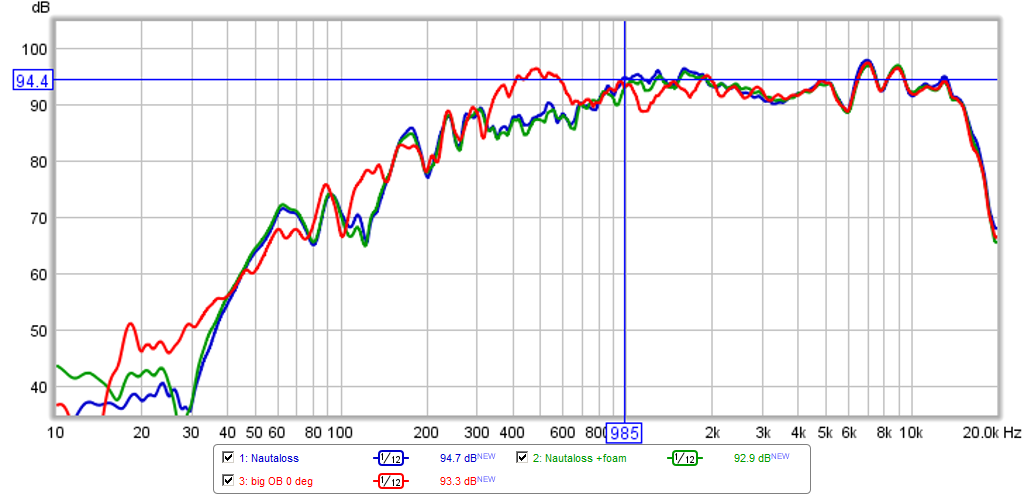

Nautaloss vs 22 in wide OB:
More info here: http://www.diyaudio.com/forums/full-range/259293-prv-5mr450-ndy-fast-applications-3.html#post4001219
Sound clips in mono:

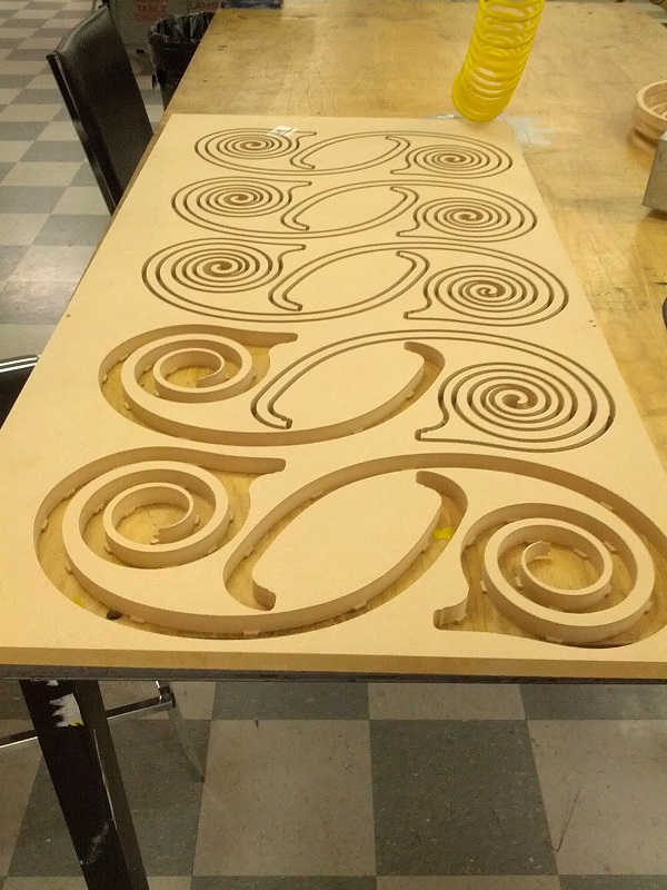

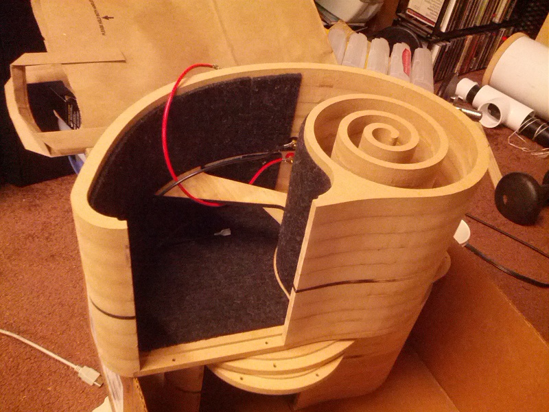

Here's a set I made using a PRV driver and stacking together many layers of MDF to get the spiral:
Wow! That looks beautiful! Really a fantastic job and I like how you made a bridge to put it above the woofer. Note that putting a driver on the end of a cylinder is perhaps the least ideal way to mount a driver due to baffle step loss and diffraction. However, if you are only using for bass below 300 Hz or so and you have another driver on the rear side in push push bipole then no baffle step loss. In any case, well done!
How do you like the sound of the PRV ? Can you provide some measurments?

Beanbag,
Anymore luck on getting the response of the PRV Nautaloss to flatten out?
Thanks for asking.
I have been trying out a few things these last few days, and will probably post more details in that other thread.
The short version is that I put it in an open baffle, and it still has a little bit of a dip around 1.6kHz. Then I actually stuck the mic against the back side of the driver and measured again. I also saw a big dip in response there, so I think it must be some property of the driver.
I saw the same response in my Martin Logan's woofer, namely a peak, then dip, and then a lower response after that. So must be something intrinsic to cone drivers?
Putting the driver in the box just exacerbates this, and again, I did a measurement where I stuck the mic inside the box, near the driver, and it turns out there is a second dip near this frequency too. I guess I must have designed the angles of the walls to take the back wave and reflect it back into the cone, LOL.
So far, the best result was to stuff near the driver very aggressively, like I showed in one of my plots. Right now, I am gonna try adding a little cone or cylinder to the back of the driver to try and redirect the wave, and also make some little wedges to fill out the two rounded corners above and below the driver.
I tried many other things, and none of them made much of a difference.
Oh, and after this, I will need to "fix" all those high frequency peaks, which are a real mess. Makes me want to just cross over to a tweeter or something...

Sorry to hear you have not been able to resolve that problem. It may be a bad driver(s). Check the basket frame for small hairline cracks. I had to swap one out for an exchange with PE via RMA because of a crack. I noticed it upon shipment and never bothered to even measure it. If you are happy with the response I posted above (including high freq peaks?) also shown below again, it should be achievable if the drivers are not defective. Even without a visible crack I would exchange them and cite that the measured response has a dip at that is not supposed to be there. PE is pretty good with returns.
Given that you have exhausted all possibilities I would exchange them for new ones. Hopefully the replacements fare better.
